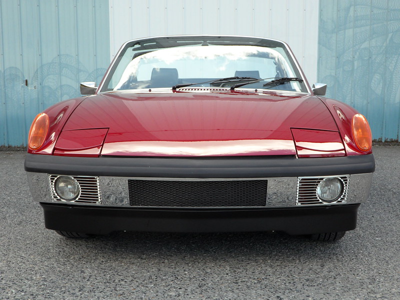

Some smart person here should be able to come up with a formula for square inches needed of the opening for air in and the same for air out. I'm not that smart.
It probably has to do with how much heat the engine is going to generate, the size of the radiator, the material of the radiator, and the CFM of the radiator fans.
I took a guess. Mine is an LB9 305 Chevy making maybe 230 HP.
The opening I cut in my bumper is 22.5" x 5" or 112.5 square inches.

I felt the openings for the air out should be at least as big as the air in opening. Mine are 10" x 8" or a total of 160 square inches for both.

My radiator is Renegade's Ron Davis for a SBC. Aluminum.
It cools fine. Running down the road, the fans do not come on. Idling they will cycle on and off. It runs right on the 160 t-stat. (Disclaimer...I don't live in Phoenix. smile.gif )

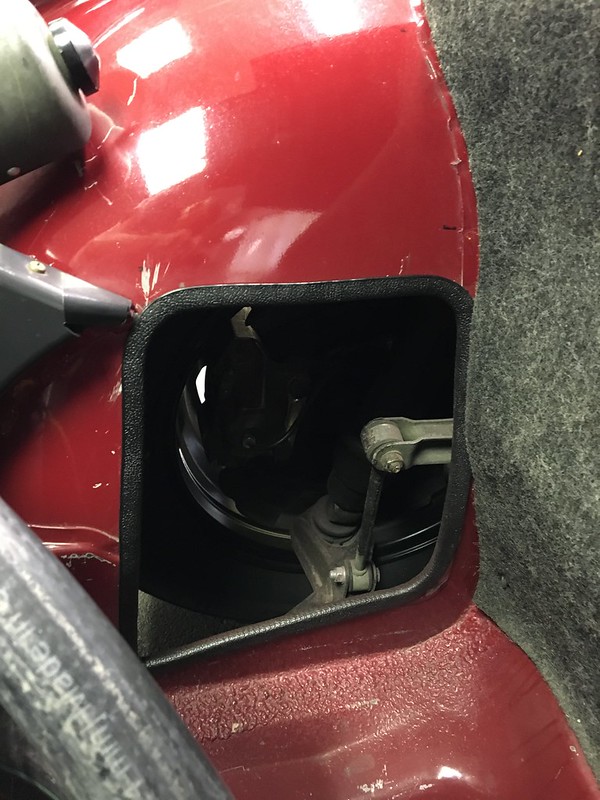

If you cut the wheel wells you need to weld in stiffeners around the cut out. I believe all the radiated conversions will allow some hot air into the cabin unless ducted to the wheel wells. If anyone has a wheel well vented system that does not allow heated air into the cabin I'd love to see their set up.
My solution:
My solution:
Great solution! I like it. I have a friend with an HVAC biz that can make those ducts for me. I guess mocking them up with cardboard would be the best start.
I would think this would also make the fan noise less obtrusive.
Any details on how you reinforced the wheel well cutouts?

The front structure is strong enough to handle a reasonable size cutout in the wheel well.
And with ducting like 76-914 or what I did with my a/c holes in the floor, you can keep some of the trunk space.

Dick, I cut and welded 1" strips of 16ga steel around the perimeter. Shaped just like the edge guard you have now only wider. That is also where I attached the 90 degree aluminum flanges that the ducking is tied into at the wheel well. Just don't forget where the plug welds are located as they are Hell to drill thru. BTW, the ducting is the 2nd best improvement I've made on that car. The first being the Suby conversion and the 3rd would be the addition of the AC system. Highjack over. beerchug.gif

Did you operate the car before the duct work? If so, was there a difference in engine temp and/or how often the fans came on?

No change. The factory Subaru gauge has always remained dead center or 1/2 way between H&C. The ducting just eliminated the hot air overflow into the cabin, which is a God send in my book. One more thing. It eliminated the dirt and dust build up if the frunk. It now stays clean and dry. beerchug.gif
