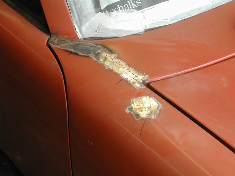

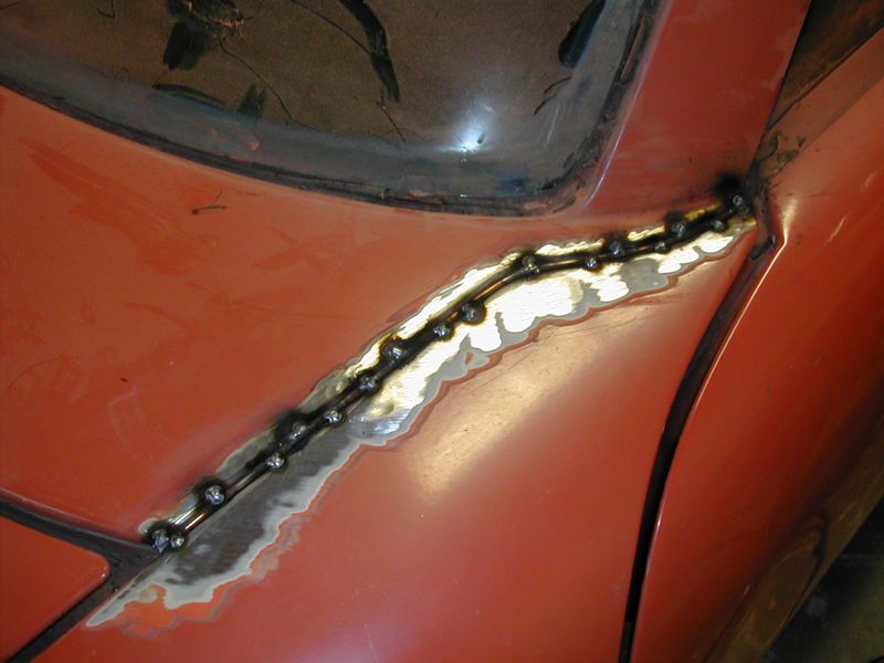

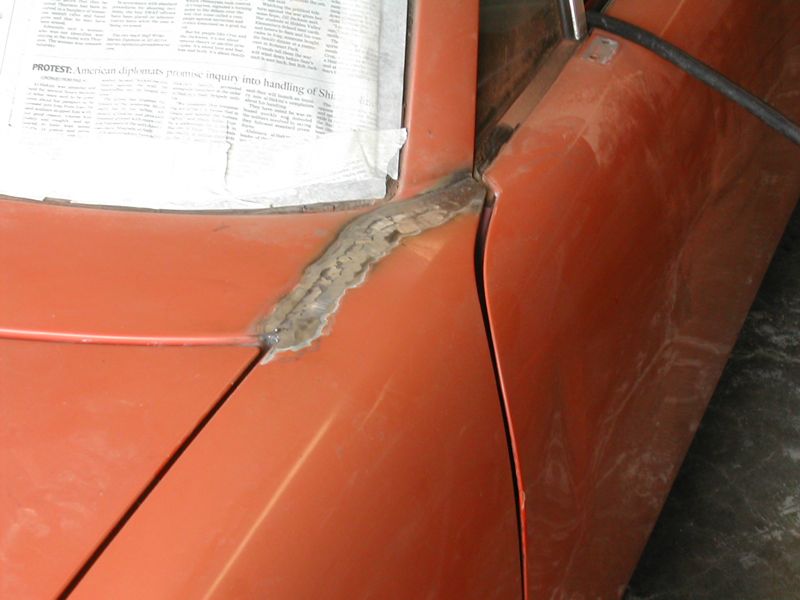

Here's the one I did. I haven't heard of any cracking, but I also don't know if this car is even driven much...
Click to view attachment Click to view attachment Click to view attachment

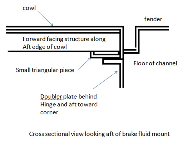

Click to view attachmentIf I may add some information only to map the problem with flexing in this area.
This area is constructed out of overlapping pieces, none of which are secured in three planes. The cowling is secured along the forward wall, only a couple of places forward in the channel and the forward edge is secured with only two vertical 25mm "c" channels. their relationship allows the flexing everyone is talking about. Almost all interfaces are hinge points.
If you look underneath the cowling toward the a-pillar you will see a doubler plate behind the hinge, and a smaill triangular piece with a structural stiffening bend along its' length. These are the only added structural pieces that the factory supplied.
The twisting of the frame during a hard right will try to compress the cowl on the right side and lift the left side.
If one wants reduce the flex, it will have to be from below and inboard-outboard
around the structure. Filling the seam is a cosmetic approach. Cutting, adding, and bridging with metal along the surface reduces the flex, but the cause in below. All of the intersecting pieces have to be tied to together and the gusseting in a perpendicuar plane will even be stronger.
Just my two cents...
