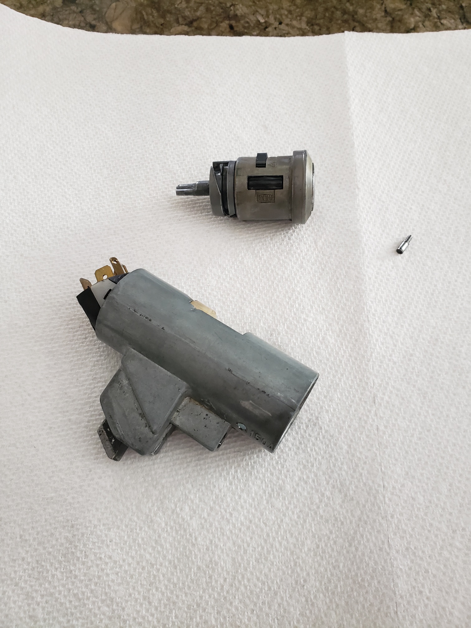

Ran a bunch of errands in the 914, stopped at several places. At the last stop I came out to the car, inserted the key in the ignition switch, and it was like it was the wrong key. The mechanism did not push inward as usual, and the key would not turn at all no matter how much I messed with it. I've had the thing 17 years and never had an issue with the mechanism before, and it's the same key as always. I had to pull the switch out entirely (steering wheel off, etc) and pop out the lock to start it. Luckily I was only a few blocks from home. Anyone ever have this happen?

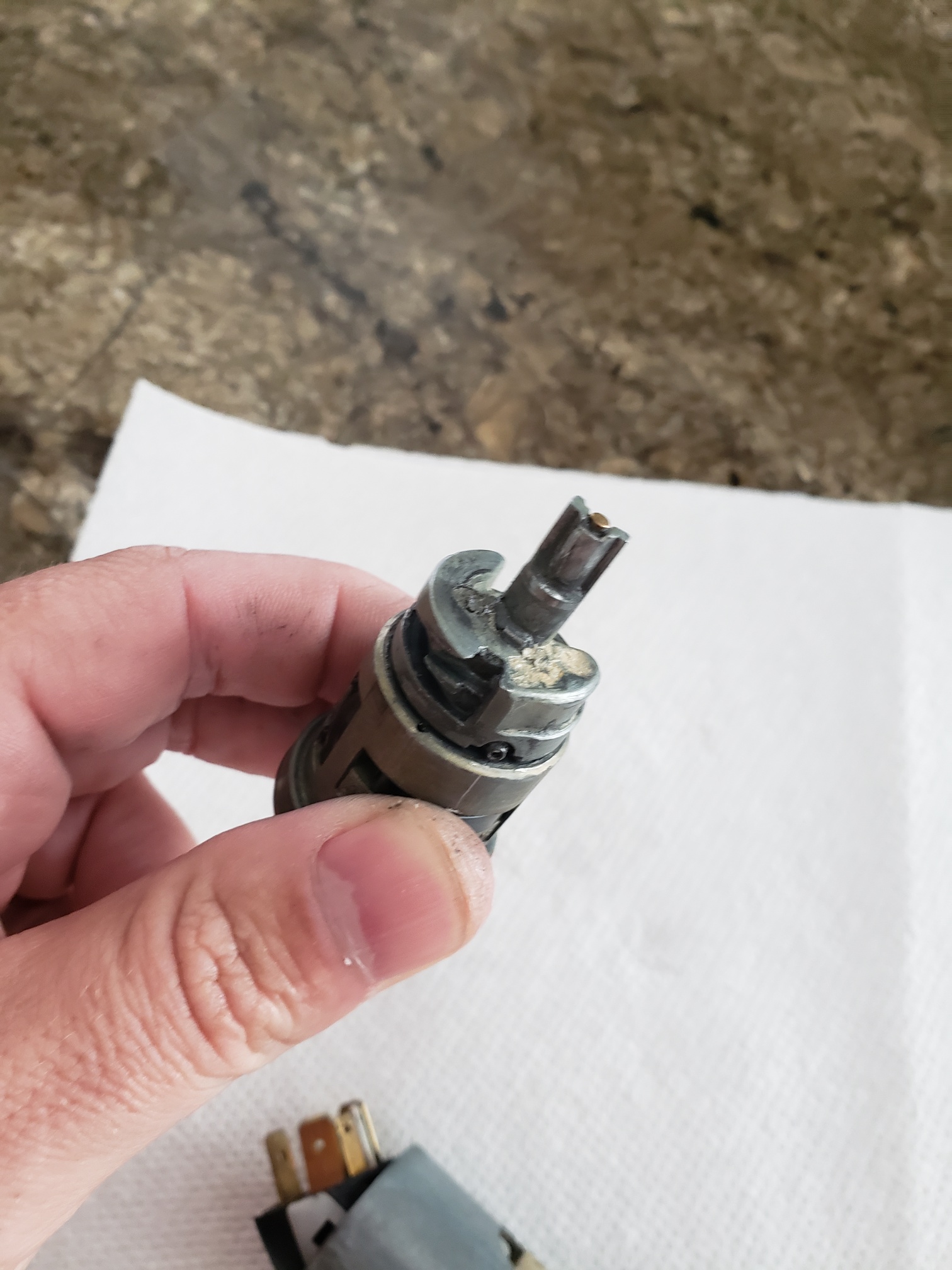

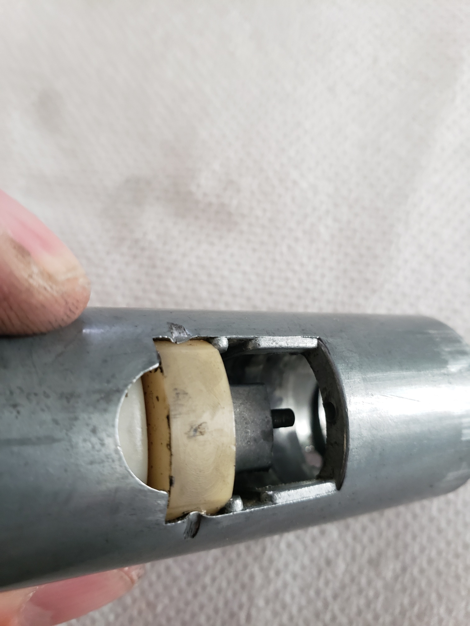

Here are some pics of the whole mechanism. Anything missing or look weird?

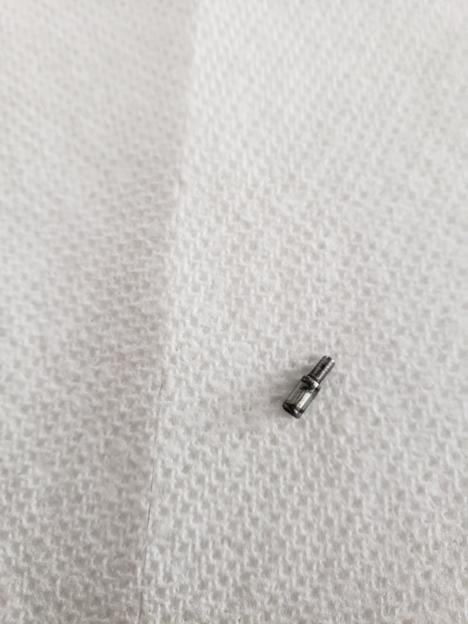

Anyone know what that little pin is for? It was in the bottom of the cylinder
Hope someone knows how to fix this...is it possible the wafers got bent inside the key lock and it needs to be re-keyed? I'm at a loss... biggrin.gif biggrin.gif

Sounds like a wafer(s) went south. Good place to start. IIRC, that little pin has something to do with the steering lock. 75/76?

Yeah that's what I'm thinking Kent. I have a full set of wafers so I'll pull the thing apart. Even though I have a '75. this switch looks like an earlier one, which is actually a good thing. If it really was a '75 switch I could never take it out without taking the whole column off.

I think that pin is the suspect. I can't remember how it goes, but I believe it rides in that groove on the disc at the bottom of the cylinder. At any rate, it shouldn't be loose in there, and if it was, it could have easily jammed the cylinder from turning.

So I cleaned it all up...there was some gunk in the cylinder...and now it seems to be working fine. Weird.
