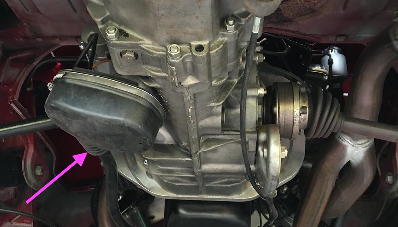

DickSteinkamp
Sep 1 2019, 01:10 PM
QUOTE(ballsyfacts914 @ Sep 1 2019, 11:46 AM)
OK, checked the set screw behind the firewall and the tapered screw at the back. Both tight, couldn't budge either. All other linkage connections look good as far as I can tell. However, there is a smaller dust boot at the back and that is ripped and I am thinking it may be binding when I try to shift. Should I remove for now? I clearly will need to replace and can do so when I get my bushings. Would appreciate all your thoughts?
Obviously, I need to replace the bushings which are coming and I need to work out the alignment of the linkages which I will attempt after I replace the bushings.
Any other thoughts?
Appreciate y'all and have a great labor day!
If you mean the small dust boot indicated by the pink arrow....
...sure.
You can even remove the plastic cover over the attachment of the shift linkage at the trans if you want. Temporarily. If either is torn or damaged, you should probably replace them when you do the new bushings.

ballsyfacts914
Sep 1 2019, 01:46 PM
QUOTE(PanelBilly @ Sep 1 2019, 02:22 PM)
I’ve had good luck adjusting the connection where the rod under the tunnel meets the shifter. Mark the post and connector one of those white felt pens so you have a reference point to tell you where you started. Moving it over one spline can make the difference between finding reverse or second. It a pain to work in the tight space but it can be done.
Are you referring to the linkage while sitting in the car? Could you please send a pic? Also, when I attempted this previously, assuming I am correct about your suggestion, I ultimately inserted the linkage, where it connects to the shifter under the shifter, all the way in. I am assuming you mean that connection and that it needs to be adjusted?
Thanks again
ballsyfacts914
Sep 1 2019, 01:47 PM
