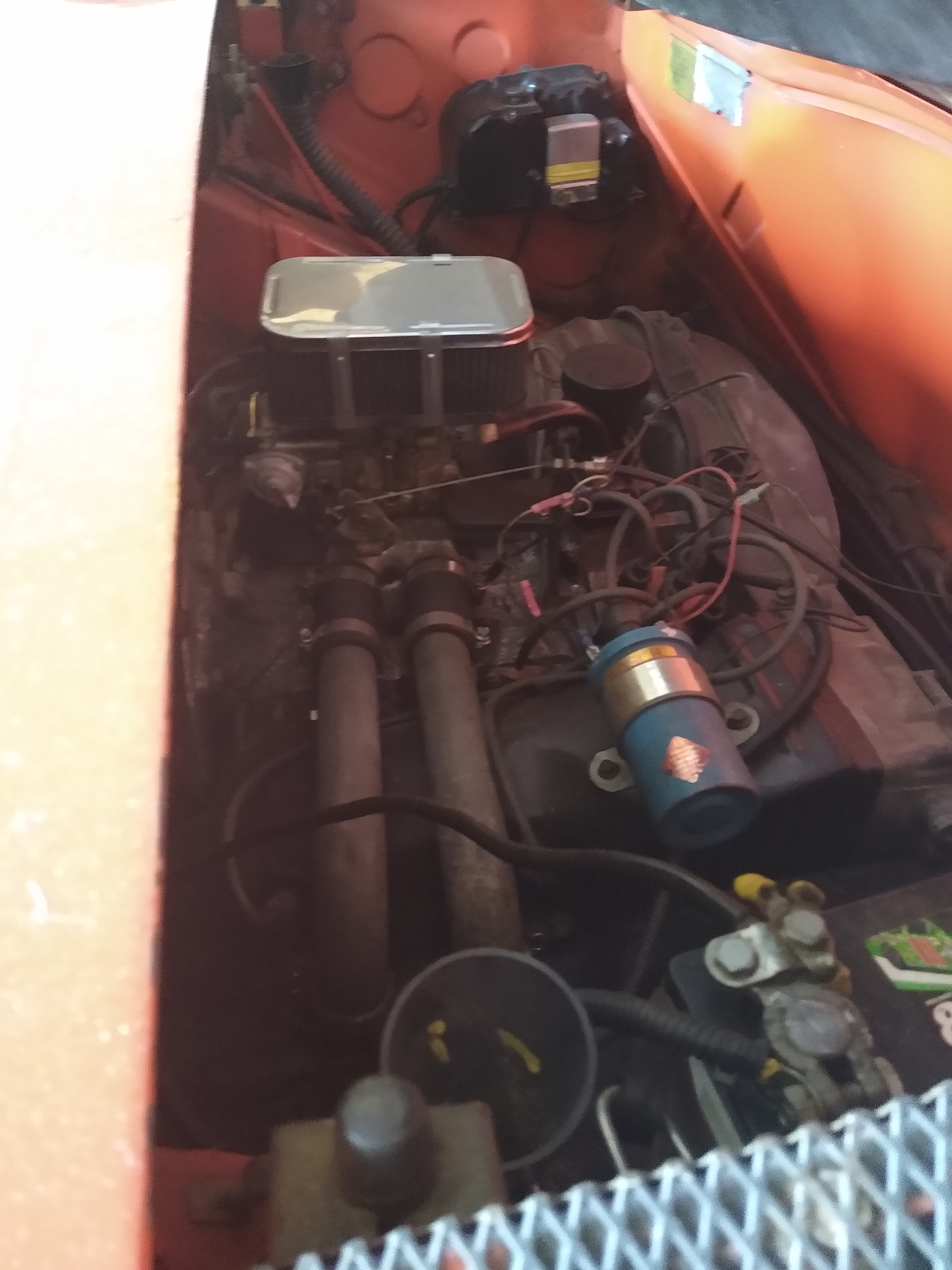

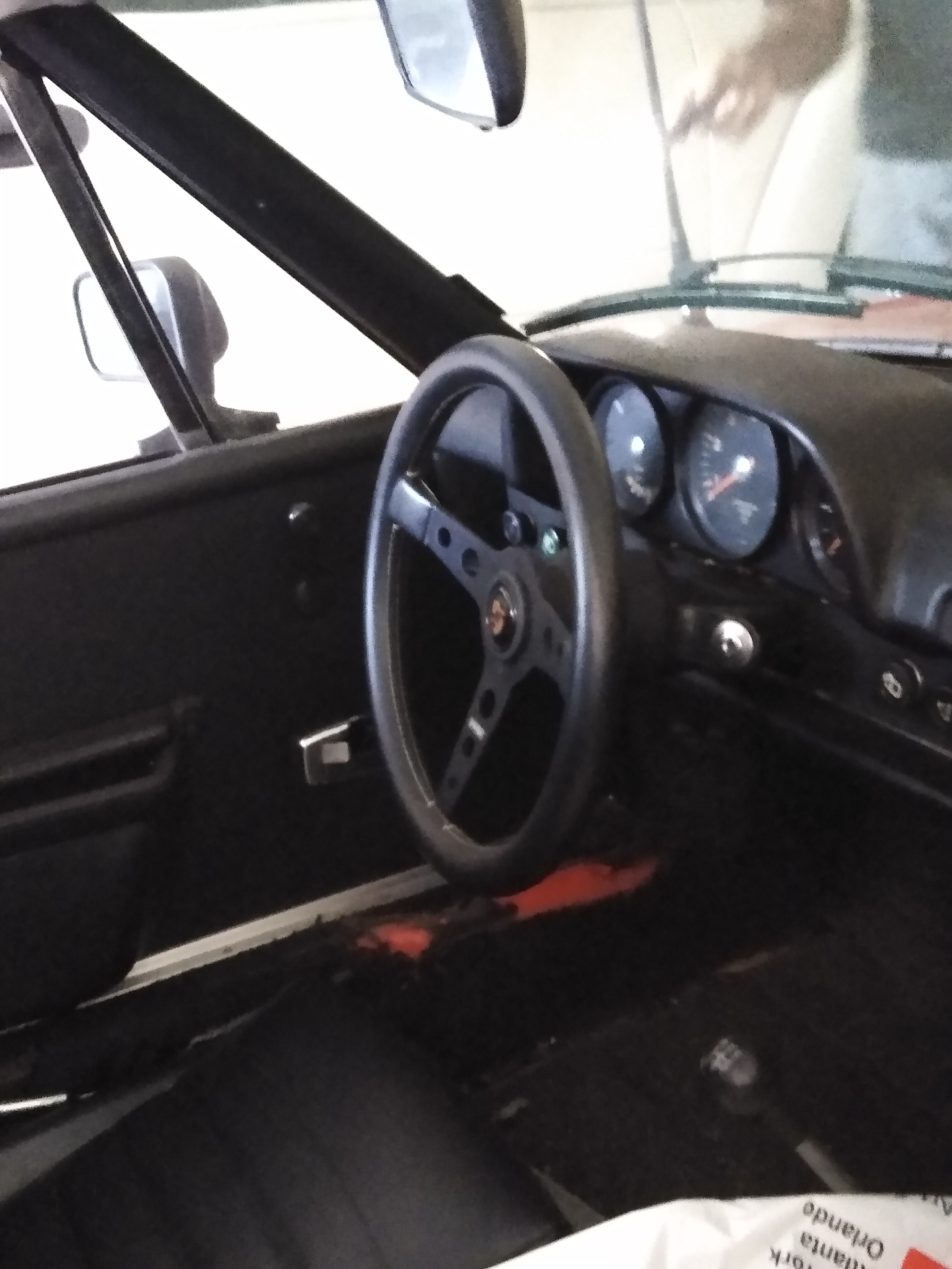

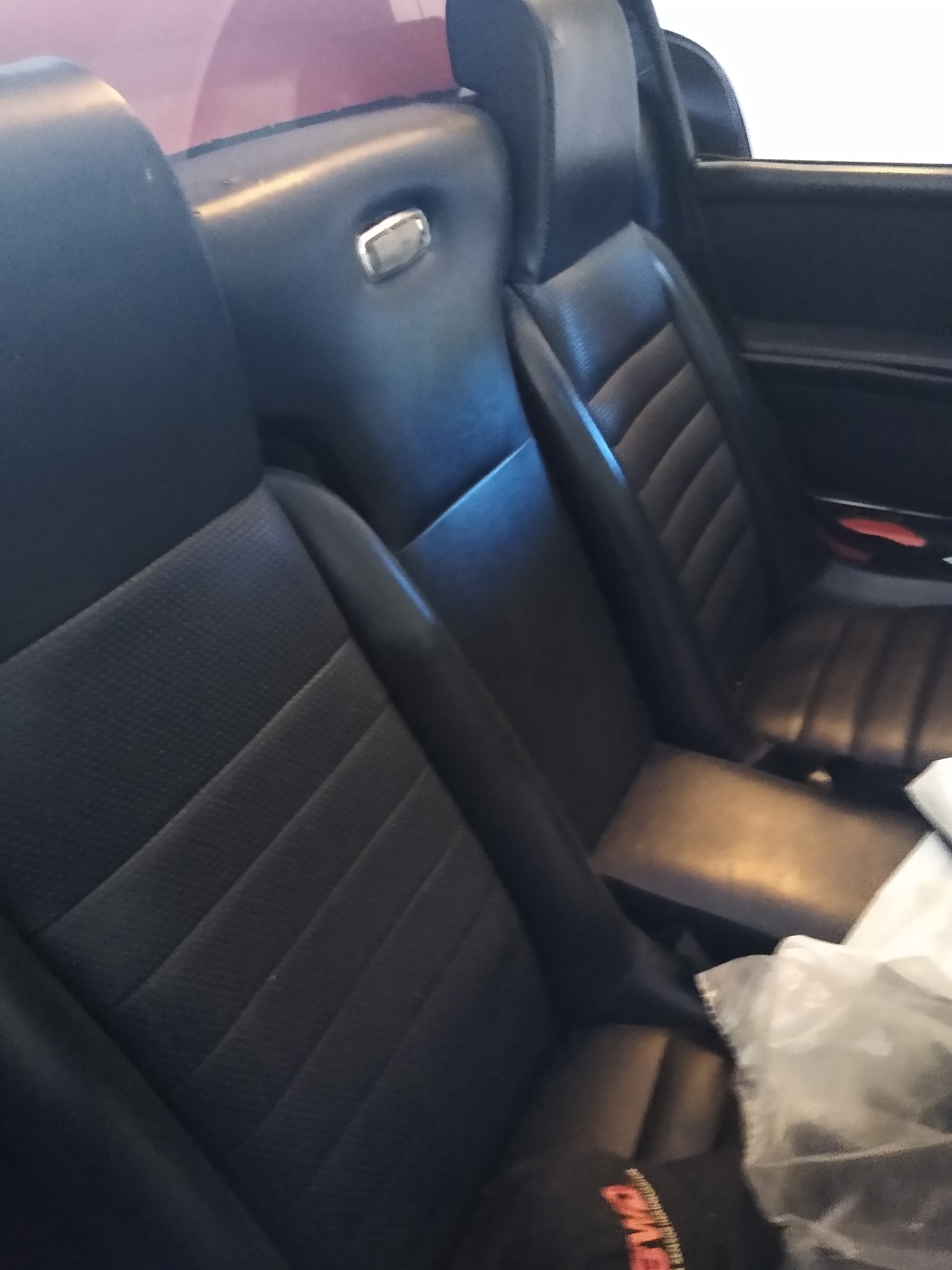

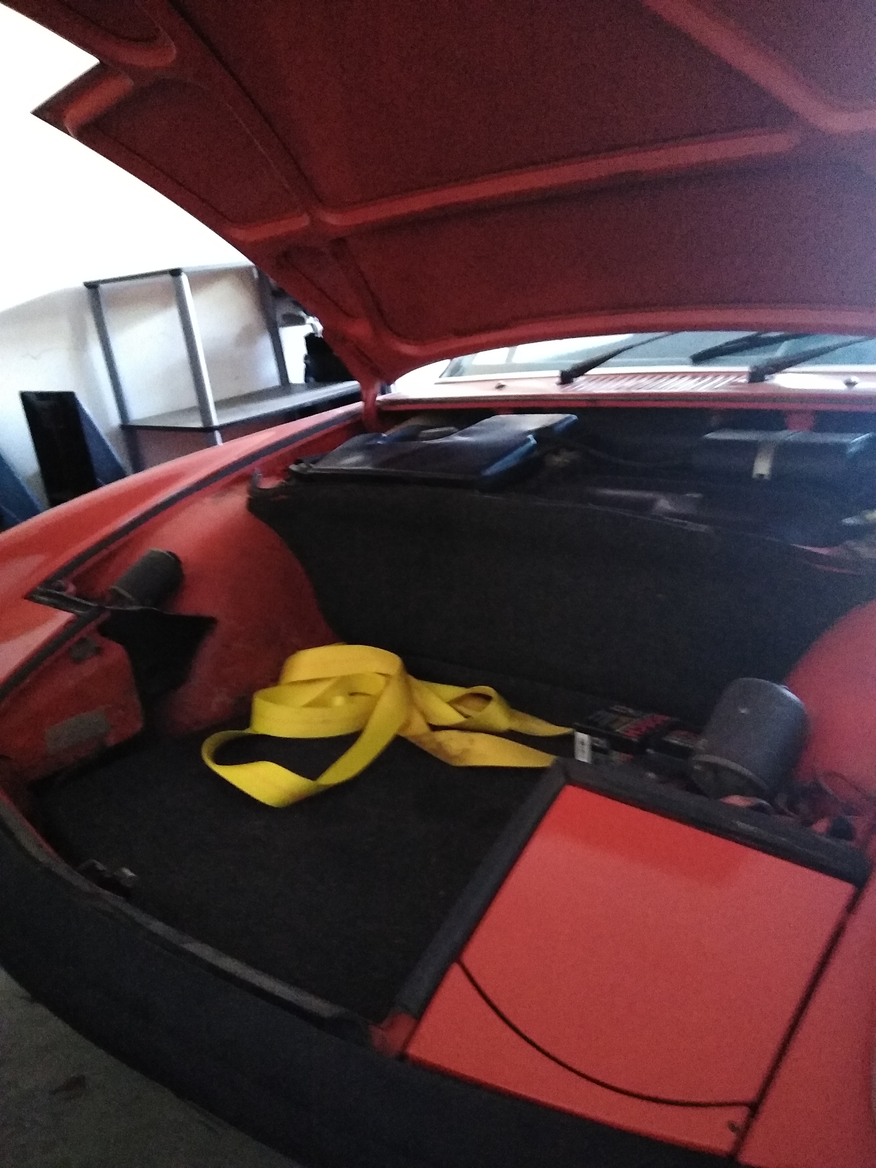

I pulled back the carpets in the trunk and inside the cockpit and didn't see any signs of rust or repair. The doors opened and closed perfectly. The head lights worked. The longs looked perfect except for directly under the battery was the only place and it didn't look to awful.

– The interior looks good, with the exception of the carpet, obv.
– The left rear wheel well arch inside the trunk looks like there's been some damage that hasn't been repaired properly.

– The single carb setup is far from optimal. You'd need to invest in better fuel delivery from day 1 to have a reliable, decent performing driver.

He fired it up and it seemed to run good other than a lifter tapping which he attributed to the car sitting for a while and having hydraulic lifters. The hell hole doesn't bother me very much because I have lots of experience dealing with repairing rust because of all the other cars I have owned and my personal shop has a car lift and would be very easy for me to remove the drive train to repair the hell hole correctly. I guess I have some thinking to do. Thanks everyone for the advice.
Hydraulic lifters are a giant red flag. OEM is solid lifter. Hydraulic is not the way to go for 914's. Make sure this isn't a bus motor via engine serial number. Even if it is a 914 case, someone has rebuilt it with hydraulic lifters and a hydraulic lifter cam. Not a good selling point. Only way to fix is to split case and rebuild the engine. EDIT: oops -- sorry I missed that you already know it is a bus engine. Even worse!

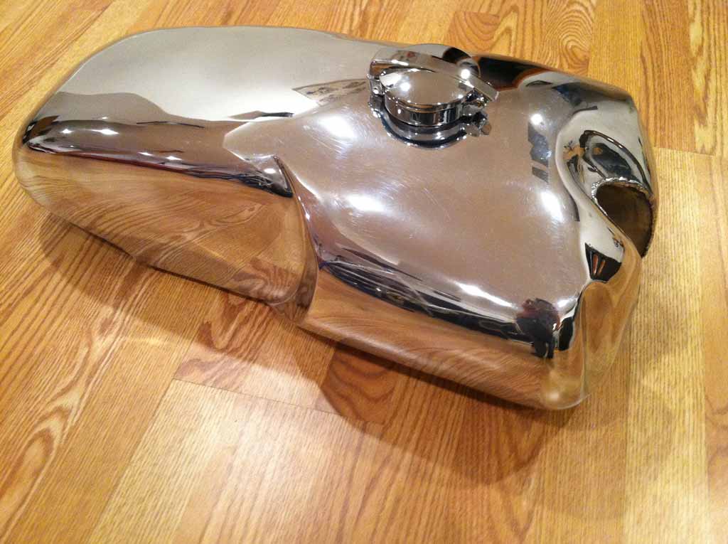

The rust should scare the crap out of you. I have lots of experience with metal fabrication. I built this tank from scratch.
Rust in the hell hole should not be underestimated. The rust on my car scares the crap out of me and like you, I know what I'm doing and have the tools to fix it. Fixing hell hole and longitudinal rust is not easy (or cheap).

The gentleman who is selling the car said that when he had the bus engine built he went with hydraulic lifters instead of flat tappet so the valves wouldn't need to be constantly adjusted . I don't know the first thing about a VW engine but I understand the basics. Also he said the car is stuck in first gear , he thinks something broke on the shifter linkage. I'm starting to think I might pass on this car unless I can get it cheaper but I hate low balling people. Super nice guy that owns it.

I just saw the picture of the tank, wow that's amazing. Great work

Hydraulic are easy but they do take away a few HP.
