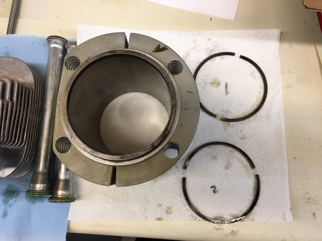

When you say you didn't gap the rings, I'm assuming you mean ring end gaps. Do you at least know what the end gaps were when you built it?
Likewise, did you stagger the ring gaps between top, middle, and oil scraper rings? If all of those ring gaps are lined up, that could be a source of too much blow by.
Likewise you could potentially do a leakdown test and see if you have cylinders that aren't sealed and blowing into the case.
Correct, ring end gaps. I don't have it written down in my notes but I seem to recall gaps being roughly 15 thousandths or thereabouts. I really debated whether to gap them further, but deferred to Jake's philosophy.
QUOTE(Superhawk996 @ Sep 6 2019, 05:17 PM) *
Yes, definitely tried to stagger the gaps.

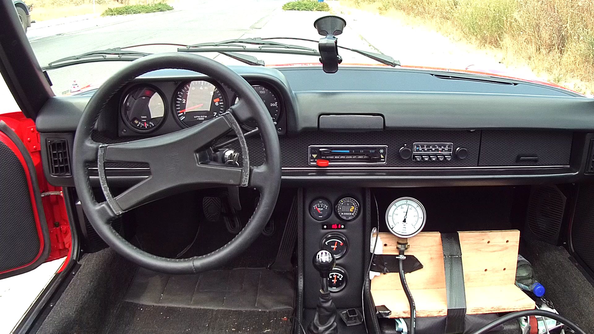

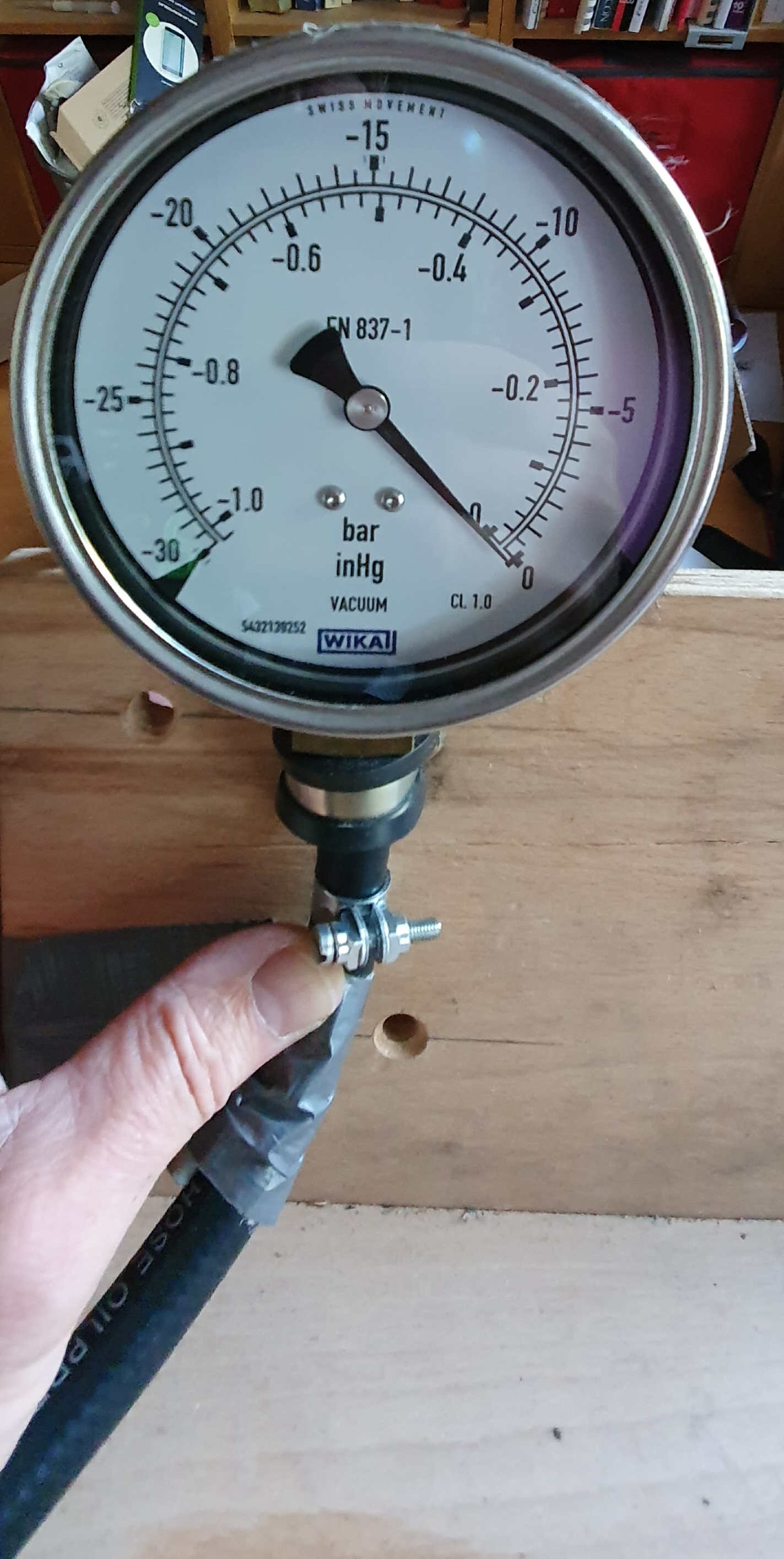

Went through this with two different engine combos, latest with same combo you are running.
Much easier and faster if you measure what you adjust.
If you hook up a vacuum gauge, using a T-Piece in front of the MPS and route the hose to the gauge, it's pretty easy to adjust the MPS, as you can clearly see in which region you are running (part load, transition, or full load).
Tune for drive ability first, then start to play with idle settings (ignition timing and maybe recalibration of AAR)

Wow. I thought i was the only one driving with a lot of gauge data input. Looks pretty cool.
[/quote]
Hard to adjust something you can not measure. This is a easy and in-expensive way to tune it quick. Don't need more than 3 hours to adjust it perfect like this. Its a bid of effort to install the unit, but at the end of the day it's saving a lot of time...

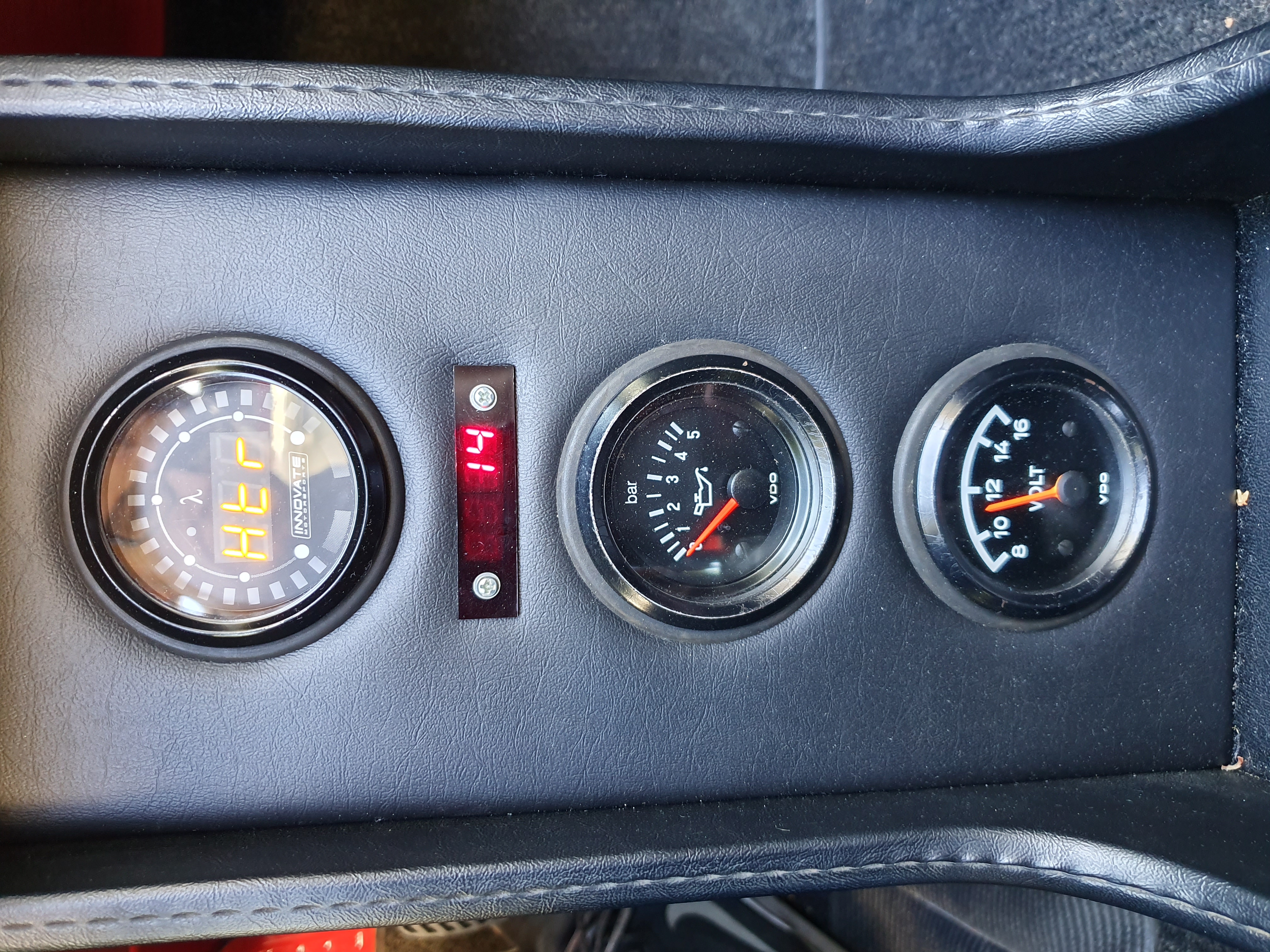

Don't want high jack this thread...
But here you go:
Slightly modified last winter. Moved Oil Temp Gauge up into the instrument cluster.
Here from top down:
Innovate LC2 Lambda Gauge, modified and fitted into original instrument housing.
CHT Gauge.
Oil Pressure Gauge, new style fitted also into original instrument housing.
Original Voltmeter Gauge.
Frank S

And here the Vacuum Gauge I use for MPS tuning purpose only:
Frank S
QUOTE(BeatNavy @ Sep 18 2019, 01:21 PM) *
QUOTE(Frank S @ Sep 18 2019, 05:39 AM) *
Yeah, that looks interesting, and I may try to set something similar up. I like the data, if for no other reason to help understand how things work. Need to find my vacuum gauge and enough correct size vacuum line.
It's also helping me that I have three working MPS's: one stock, that I use as a baseline for measurements, and two that I can tune and swap in and out to see the effects.
Rob, as you are running exactly same CR then I do, here my MPS adjustments:
0.83H @ 15 inHG
1.37H @ 4 inHG
1,57H @ 0 inHG
Maybe this will help to find a base line.

Hi Rob, good points!
I was working with a cheap inductance meter in the beginning too and decided later to buy a expensive one as the cheap one simply couldn't do the job.
To be clear about the whole Set Up, I'm using a 043 ECU in combination with the MPS values. From my memory you are running the same Set Up.
Stock non-molested 043 MPS values I've measured are:
15 inHG: 0.75
4 inHG: 1.21
0 inHg: 1.49
Frank S
QUOTE(Superhawk996 @ Sep 18 2019, 11:42 PM) *
In Franks case I assume he is using the lambda to adjust the MPS and not just relying on MPS inductance. That is why I wanted to see his console better. Am I correct - tuning to lambda?
@Frank S
I'm tuning for Lambda. But by using the vacuum gauge you have a much better idea what adjustments are needed.
Just to provide an example driving up a slight slope in 4th gear with contstant throttle at 4000 RPM, I thought I might be already in a engine load situation where the full load diaphragm is active, but with the Vacuum gauge you can clearly see, that you are still far away from the transition point (so it's still the main mixture screw sou have to adjust).
As I also have more than one MPS I measured the values after final tuning, like this it was easier to adjust the other MPS units.

Ok, circling back on this to add to the 914World knowledge base.
About 6 or 7 weeks ago I was having more trouble starting (and restarting) the car. Finally broke down and did a compression test. Based on the results, I pulled the engine and here's what I had:
Ok, yes -- cylinder #1 had not just one but two broken compression rings. I probably broke at least one when I installed piston in the cylinder a while back. I had cold compression numbers of roughly 60 on #1 and more like 140+ on the others. The broken rings could explain a lot, including elevated oil temps and oil leaks due to all the blow-by.
Anyway, I dropped the engine and pulled the heads. I replaced the broken rings and also re-gapped all the #1 rings based on KB's guidance that Tom pointed out in an earlier post in this thread. Also put installed a new RMS (although the old one probably wasn't really bad). Most of the time over the last 6 weeks was spent cleaning up the underbody like I've been meaning to do for years -- removing / replacing undercoating, fixing isolated rust spots, and repainting engine bay and underside of trunk. What a LOT of work, and dirty too sad.gif
Finally got the engine back in today, and got her fired up! Too early to say all my drivability and oil temp/oil-leak problems are solved, but I am encouraged so far, and glad to be back on the road (with a nice clean underside) aktion035.gif
Several lessons learned:
1. When chasing your tail, break down and do a compression test earlier rather than later. I don't know why I tend to avoid it - it's only a minor PITA but can give good info.
2. I went with Jake's advice on ring gapping (go with out of the box gap) -- which is fine, unless the manufacturer of the product engineered something different. Read the (****) instructions.
3. A type 4 can run surprisingly well on less than 4 full cylinders.

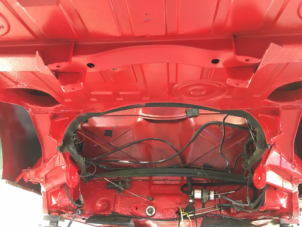

4. This came in handy both for engine drops/installs and installing the HE's and exhaust -- basically just lifted everything in place. If you have a lift and do lots of engine drops, you may want to treat yourself to something like this if you haven't already:
IPB Image
5. Even with a scissor lift and that cart, pulling the engine is still a PITA. Hope I'm done for a while.
Thanks for everyone's help. I'll post more when I get a chance to road test it more. In the meantime, here's my cleaned up butt (it's ok, you can look at it). Not perfect, but much better than before.
