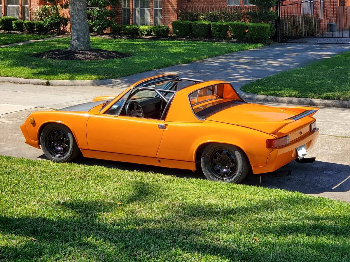

Hello,
Any one here that knows this car?
It’s a 1975 1.8L
My 14 yr old son is wanting it as his first car (leaves us a 1.5 years to get it ready).
Click to view attachmentClick to view attachmentClick to view attachment

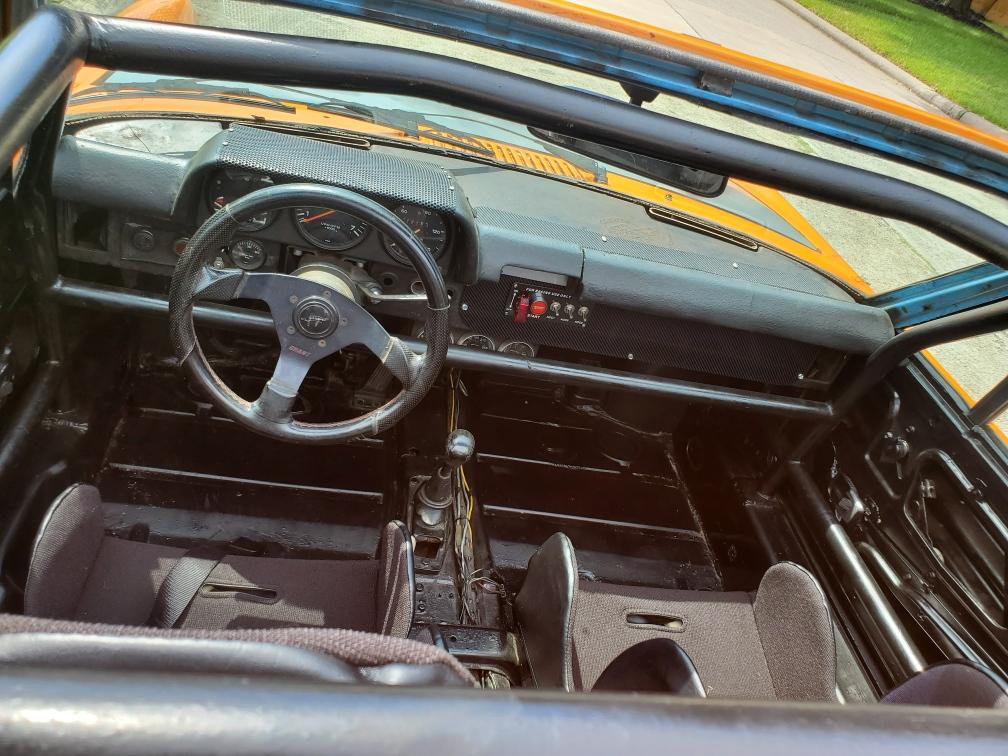

And, what do you sit on to drive it?

Check that cage for head clearance. Maybe it's the pics but it looks close, especially in a no helmet situation. You can always cut it out and add long stiffeners.

Can't install the roof by looking at those pictures

I was thinking the same thing. Permanent garage car and fair weather only. nahhhhh not my first choice for my kid.

Unless your teenage boy is going to wear a helmet all the time, the rollbar is more of a liability than an asset. A minor accident can crack your skull

BTW - I had a 914 that had a 4 point roll cage and it always looked like the top bars were too high when the roof was off. They were not though - it's just the they were built up into the targa top void snuggly. So, I bet the roof on this one fits just fine.

I like the blue and orange gulf colors!

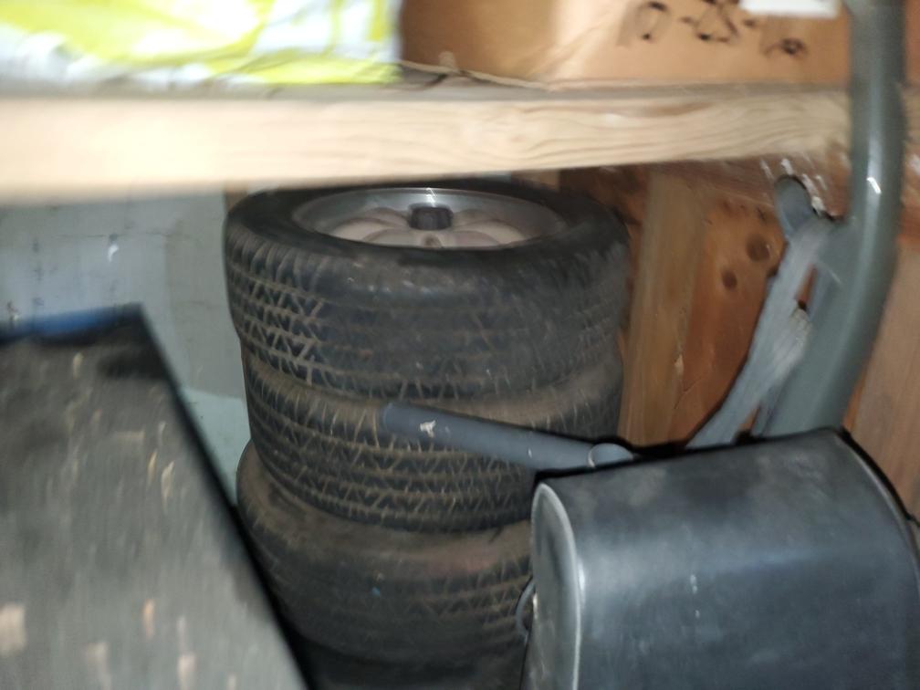

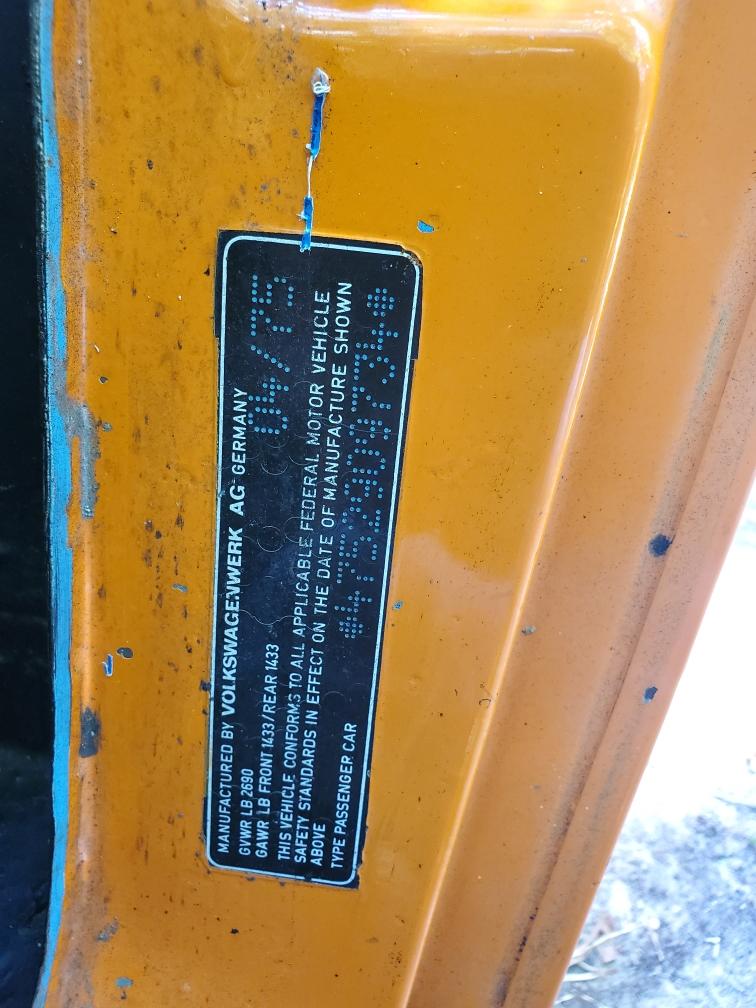

Thanks for the input.
Indeed it would need a bunch of parts to make it right.
Original hood and light assemblies come with the car.
Although my son likes it better with the headlights-delete as it is now.
VIN is not in the world database.
Also included is:
Original seats (that need rebuilding)
Extra set of wheels
Any idea about fair value?
Here are some pics.
Click to view attachment Click to view attachmentClick to view attachment Click to view attachment Click to view attachment Click to view attachment Click to view attachment Click to view attachment Click to view attachment Click to view attachment Click to view attachment

I will get to see this car tomorrow.
Looking for comments and opinions from all of you.
If the car is solid, the plan would be to make it a suitable streetcar (but not a daily driver). I rather have my son working on his car then playing with his phone on the couch.
Comments on the following are especially appreciated.
My own 914 has carbs and an uncluttered engine bay, so I get lost looking at the picture below. Please chime in.
Are Aluminum Kirkey Racing Seats a Pro, or a Con?
Are retrofit Projector Headlights good enough?
See Picture of Oil-cooler. Isn't this a little overboard for a 1.8L? If I get a smaller one below the rear trunk, would the hole in the frunk be suitable for an AC heat exchanger?
Oh Yes.. the roof fits.
Click to view attachmentClick to view attachmentClick to view attachmentThanks everyone (Don't hold back)

Okay well here is where I would start.
Kirkeys are fine, can become a pain in the ass / lower back, young kids don't care. 914 stocks are better, Stephan's sets are the best for long trips.
Ditch the cage even if the top fits, your head will not survive a hit with the cage.
Projectors retrofitted could work
@Gint would now for sure as one of his cars has a set he is driving to Okteenerfest with it right now.
A lot of oil cooler for a 1.8L unless it is not a 1.8L, but judging from the EFI it is a 1.8L. It could be needed if other cooling systems where not up to the task. The 1.8L with L-Jet is a nice engine, I ran one for a while with the 96mm pistons and jugs to make it 1995cc motor, short stroke 2.0L was great fun. Did not need an external oil cooler on it.
If your son likes all of this stuff then great, the cage has to go, as been said a 100 times
If it runs and moves under its own power and you don't see the ground it is a good starting point.
Keep it running and driving and fix small things at a time. I can not count on my fingers and toes how many "project" cars I purchased where people got discourage by it not running, no site at the end of the tunnel to get it going, I lost interest, etc....

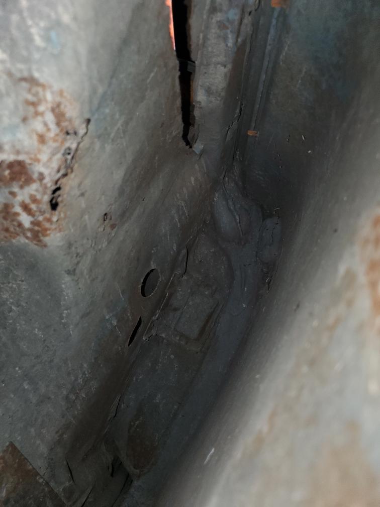

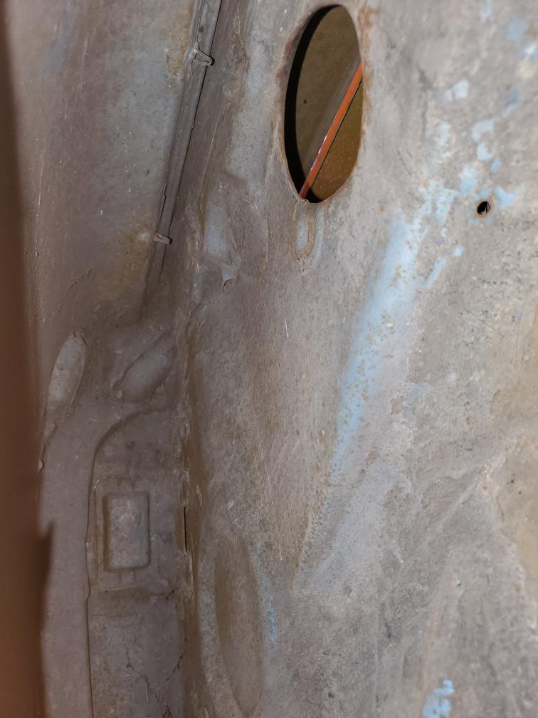

The seller came to my home yesterday to show it to me.
I have decided not to purchase it (unless its super duper cheap).
Asking price is $4,500. I offered $2,000. So there is no deal.
The car needs a bunch of work, and is "almost" at the point of no-return to be roadworthy. But for AutoX it should be fine.
Here is what I have seen.
Paint is cheaply done, but decent shape.
There are rust bubbles where the cowl meets the front quarter panels. Repairing that will mess up the paint. The gaps between cowl and quarter panel have been hidden (with bondo?) and this is where the bubbles are.
Door gaps look to be narrower on top then bottom. But when jacking up the car at the jacking point the gaps don't move. Chassis seems stiff. The gage could be instrumental in this.
Longs The rocker panels were still on, so I couldn't really see the longs. But from what I did see there was not too much rust. And I did jack-up the car through those square tubes.
Donuts were dented etc, but not rusted out. Right rear showed some rust behind the donut.
Hell-hole is not great but also not bad.
frame stiffening was done around the rear wheel wells and suspension.

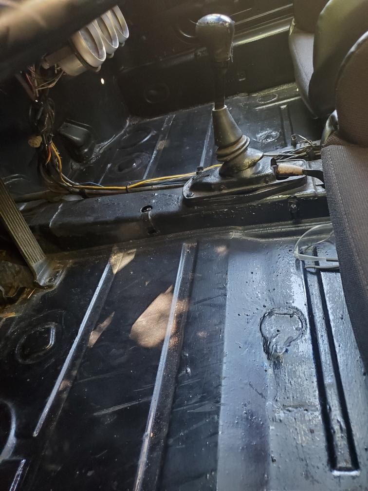

Floor board on passenger side had a 10"-12" piece of sheetmetal welded in. Done by an amateur worse then me.
besides these areas there was not too much rust.

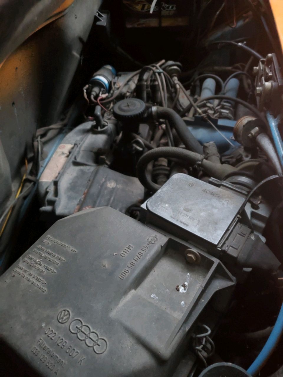

Engine # starts with EC (US model)
Oil leak, left some drops of oil on my floor.

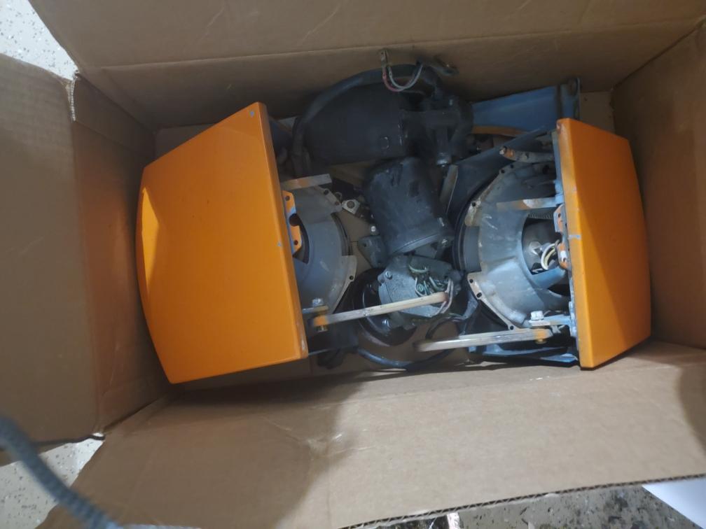

The pop-up headlights are replaced by extremely bright white LED's in the side markers. But the originals are included in a box.

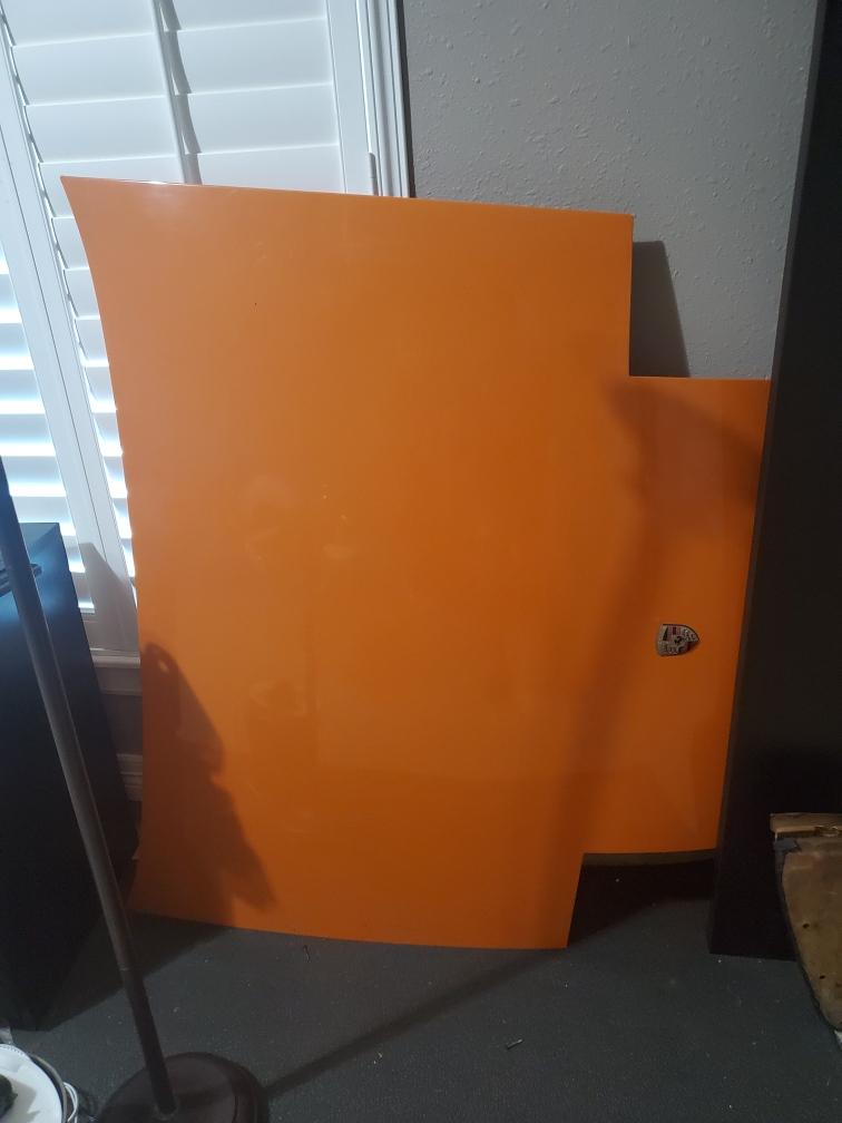

Hood is polyester (but original is included separately).

The wiring in and around the dashboard area is a mess. You will be like an airplane pilot, flipping a bunch of switches before take-off. Turning the key doesn't do anything besides avoiding steering-wheel lock.
The dashboard itself is basically non-existent (not sure how to describe this.

The engine runs nicely and idles calmly. Although the cover of one of the control units is missing.
