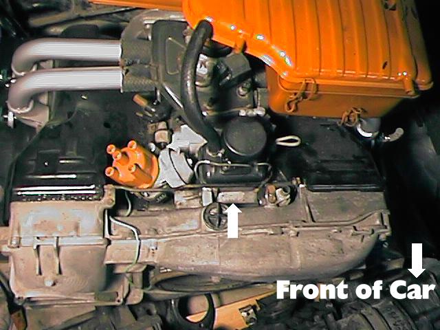

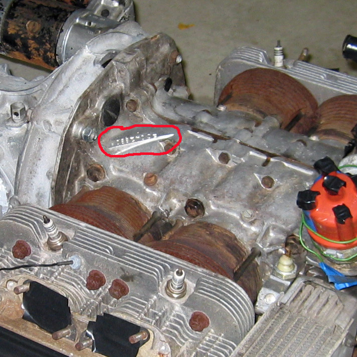

Hello folks. I’m a new member here. I am having a shop perform a PPI on a 1975 2.0 that I am looking to purchase. They can’t find the engine serial number. Isn’t it located on top of the engine, in front of the oil filler neck? Thanks.
ndfrigi
Sep 11 2019, 12:53 PM
9**P-car
Sep 11 2019, 01:03 PM
Thanks for the Pic! On this car, that metal area is smooth - no numbers stamped. From what I have read, it may be a replacement block that doesn’t have a number.
ndfrigi
Sep 11 2019, 01:18 PM
QUOTE(9**P-car @ Sep 11 2019, 12:03 PM)
is it 2.0 or 1.8? if 1.8 the engine number is at different location.
mtndawg
Sep 11 2019, 05:59 PM
QUOTE(ndfrigi @ Sep 11 2019, 11:53 AM)
Yes, mine is a 1975 2.0 and it’s by the oil filler in the same spot.
914werke
Sep 11 2019, 07:50 PM
if not a replacement case a transplant from 912e ?
ndfrigi
Sep 11 2019, 08:00 PM
is it F.I. or carb? can u share pic of ur engine?
porschetub
Sep 12 2019, 01:55 PM
QUOTE(ndfrigi @ Sep 12 2019, 02:00 PM)
,would really help,have the numbers been ground off or is the area smooth as it would be cast from the factory.
I would certain get your guy to check that.
9**P-car
Sep 12 2019, 03:46 PM
The first 2 pics are from the dealer selling the 914. The 3rd pic is from the mechanic performing the PPI. That area where the number should be is smooth.
davep
Sep 14 2019, 02:06 PM
If a 912E engine, the serial is located on the fan shroud. If a normal fan shroud is placed on a 912E case, then there would be no engine serial to be found.
9**P-car
Sep 14 2019, 06:05 PM
Mystery solved. I was able to track down the original owner, and he said he threw a rod in 1979, and had to get a replacement block. Thanks for everyone’s responses.
