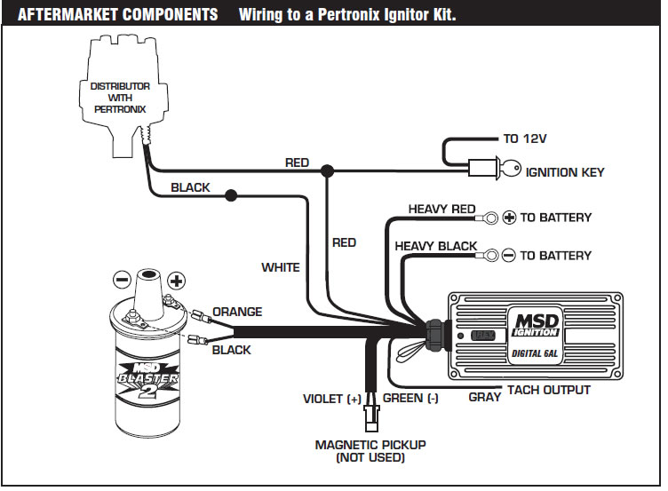

How is it all wired up? Should look something like this aside from the tach adapter wiring.
mb911
Sep 15 2019, 07:17 PM
QUOTE(sportlicherFahrer @ Sep 15 2019, 05:16 PM)
How is it all wired up? Should look something like this.
Yup just like that..
