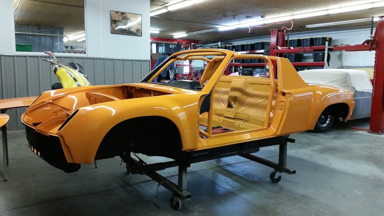

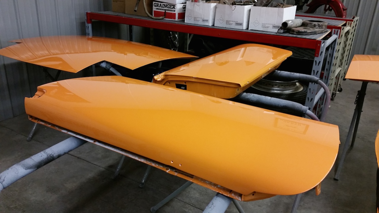

Funny, when I had my car painted a few years ago the painter asked me why the passenger door weighs twice of that of the drivers....I had a small accident at Road America 15 years earlier and a early drivers door was stuck on. I had to act fast to find a early passenger while still at the painter.Click to view attachment Click to view attachment
