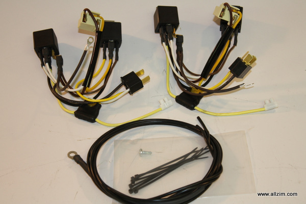

If you up the wattage on the headlights or the fog lights, you need to add a relay to the circuit. There is a kit available for the headlights on a 911, but all you have to do is add a wire and fuse back to the battery to power it if you use it on a 914.
Zim's headlight kit.
IPB Image
You can do something similar for the fog lights.
Or go to LED bulbs. They actually cut the wattage, and get MUCH brighter. Now you can be as annoying as the new cars.
