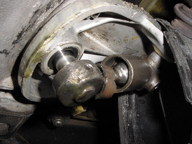

This shows a broken bush where the rear rod attached to the selector
IPB Image

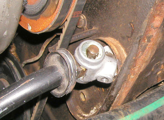

This shows the firewall bush. This should be a snug fit around the road and also not moving around in the firewall.
IPB Image

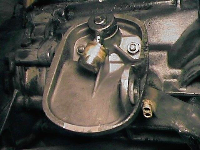

This show both of the rear bushes
IPB Image

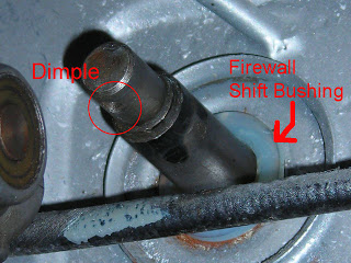

This is at the firewall and show deteriorated bushes and the hole where one of the set screws go.
IPB Image
So these are the bushes. With these pics and the Haynes manual you'll be able to find your way around and inspect them all.
Good luck.
