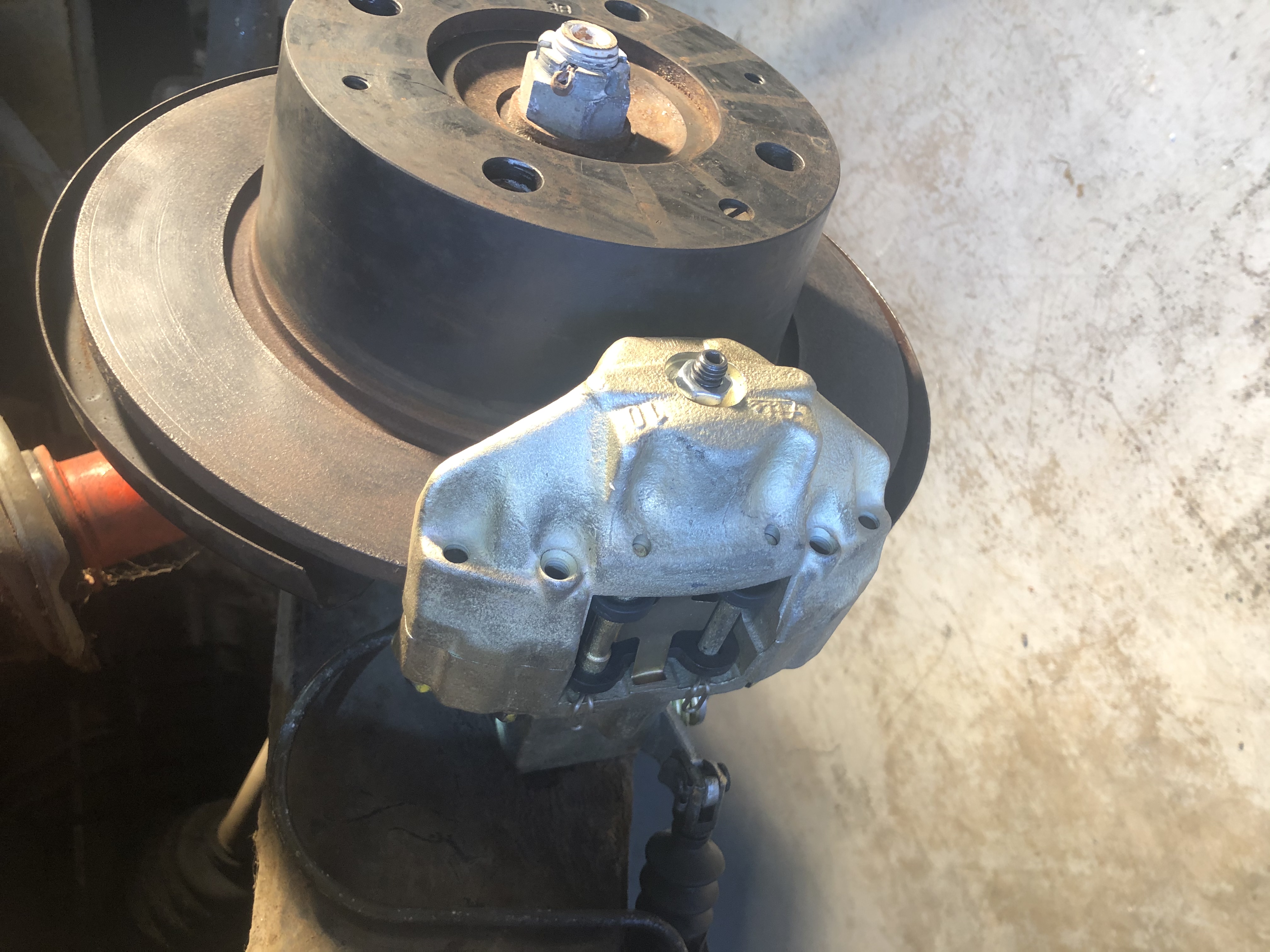

DucRS
Dec 29 2019, 02:23 PM
I’ve been heavily lurking and learning from this group
Stainless fuel lines and PMB calipers just completed.
