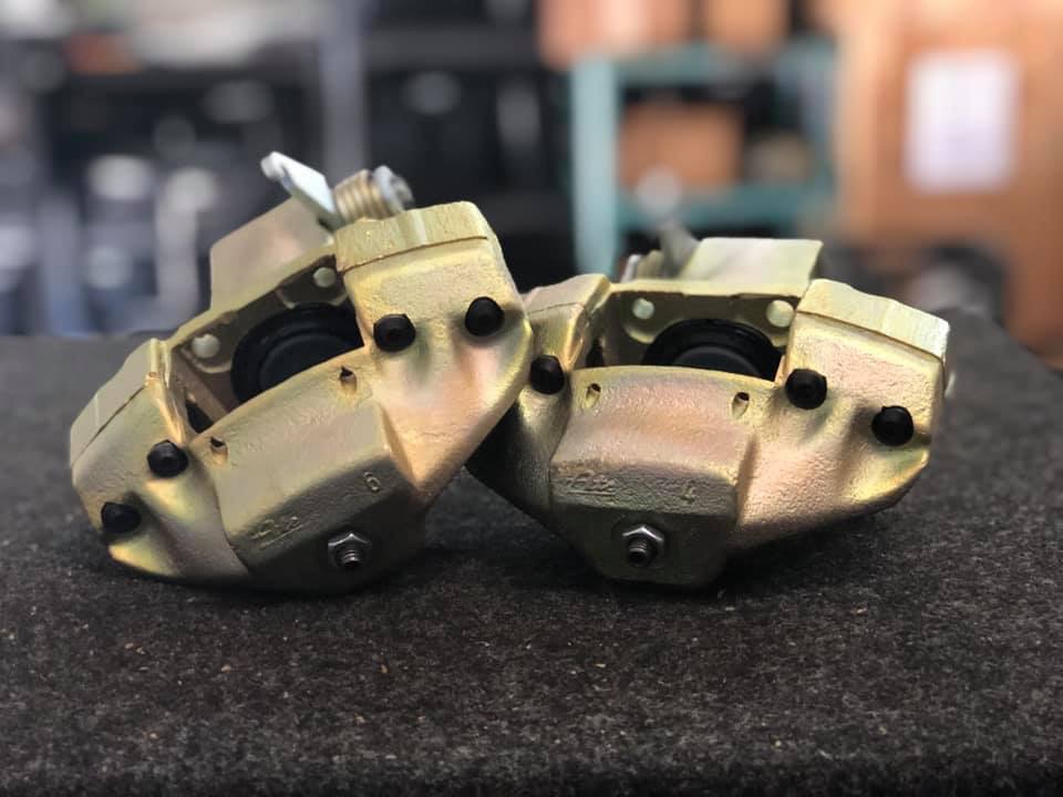

The rebuilt calipers from PMB really are works of art and great folks to work with. They’ve done several for me with a quick turnaround time if desired to have yours rebuilt, or have rebuilt ones available to ship with a core charge.
BTW, the Chicago Region of PCA is extremely active. You might want to check them out as there are several 914 enthusiasts among the membership. You also have one of the best 914 shops in the Midwest with 914Ltd. (Brad Mayeur), and a great source of used parts from 914 Ecology (Garold Shaffer)
