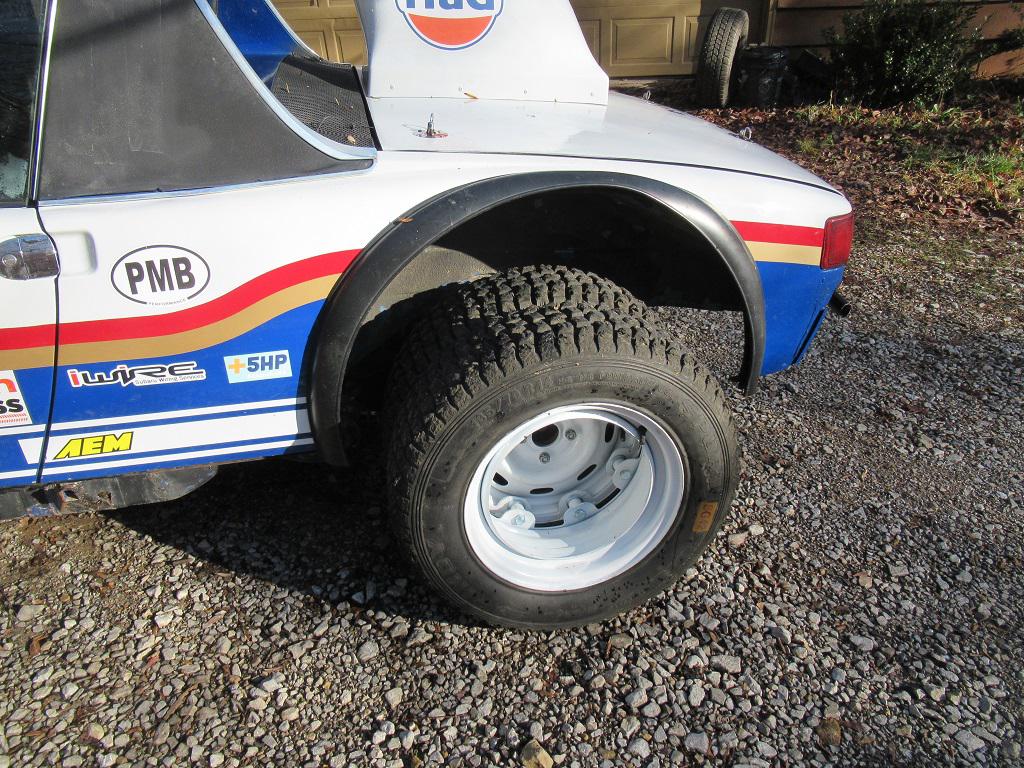

You think that +5 hp sticker really works? And just think if there is one on the other side...

I liked it all the way up to the duel rear wheels. Oh and the fender extensions could have been handled with a bit more creativity IMHO... other than that looks fun!

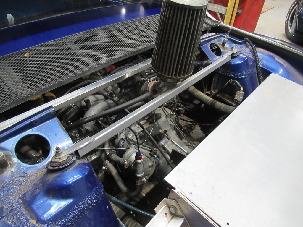

Note to Goober: Adding a brace betwen the top of the small diameter shock rods that are already isolated in rubber really isn't much of a structural reinforcement. And to top that off, it will cause your damper rods to flex and then side load the damper seals leading to quick failure. headbang.gif Suspsect it really doesn't matter to this guy. The Home Depot T pipe fitting is another nice touch.

I don't know shit from apple butter unless it's my car but here goes: Is that outer wheel a time bomb? Not much metal attaching it to the inboard wheel. confused24.gif

Certainly not TR&A approved. I'm pretty sure it would not pass fatigue testing that would be expected of a produciton rim and especially a dually rim.
