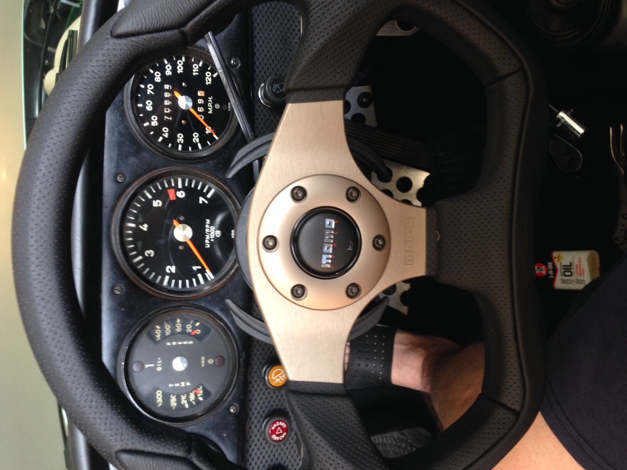

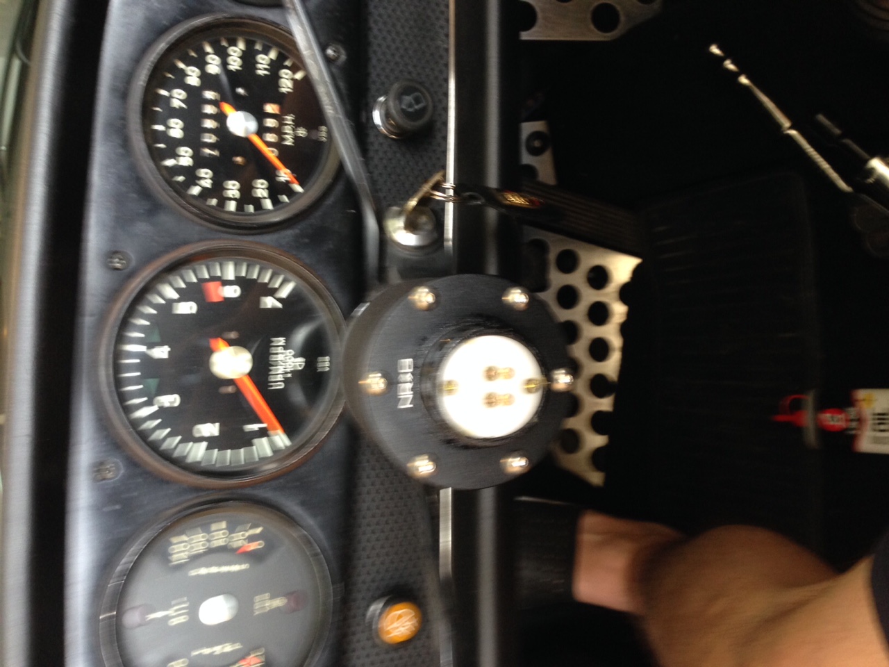

I think mine may be the NRG 2.5. I used the Momo adapter too IIRC. It's been a few years and my car is on the other side of the world. One thing I like about it is that it moves the steering wheel closer to me, and I can see the gauges even though it's a smaller diameter. Sorry for sideways pics...I'm too lazy today.

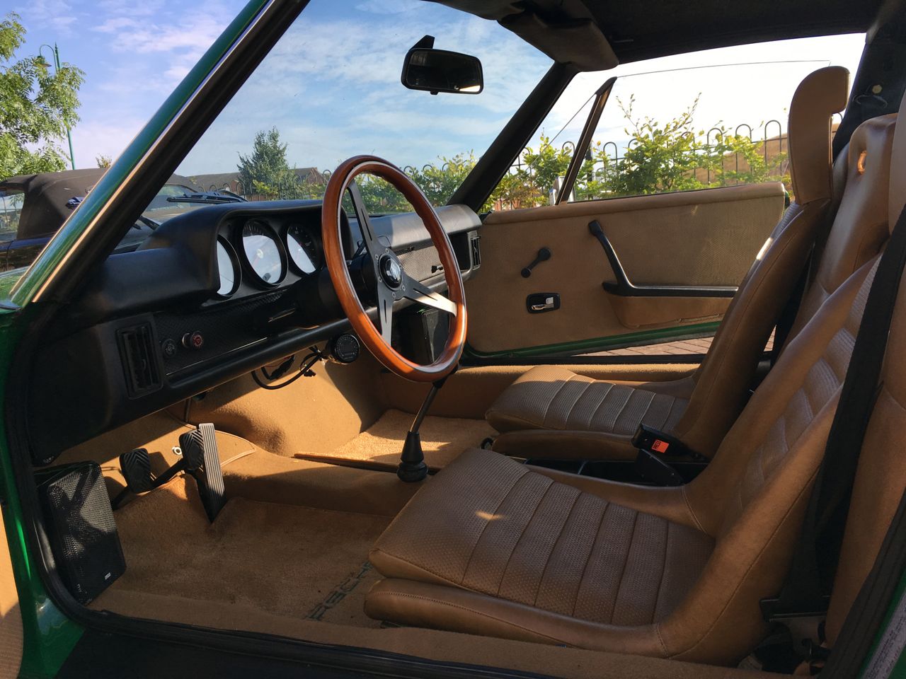

I have a quick release too...
nardi adapter & quick release spacer (from driftworks), MX5 miata special edition wheel (cheaper than anything else and looks nice)...
I'm 6'2" and having the wheel closer to me vastly improves the comfort of the car... can get into first without bashing my knee... (and makes it easier to work on the dash)(and can be removed for security).
alex
jim_hoyland
A few pic and a ref: This QR has provisions for the horn.
https://www.pegasusautoracing.com/group.asp...mpaign=201708-1
Also: http://snapoff.com/racing/
Scroll down the page to Snap Off R100B PCD 6 x 70 Those pictures look like the one I have
