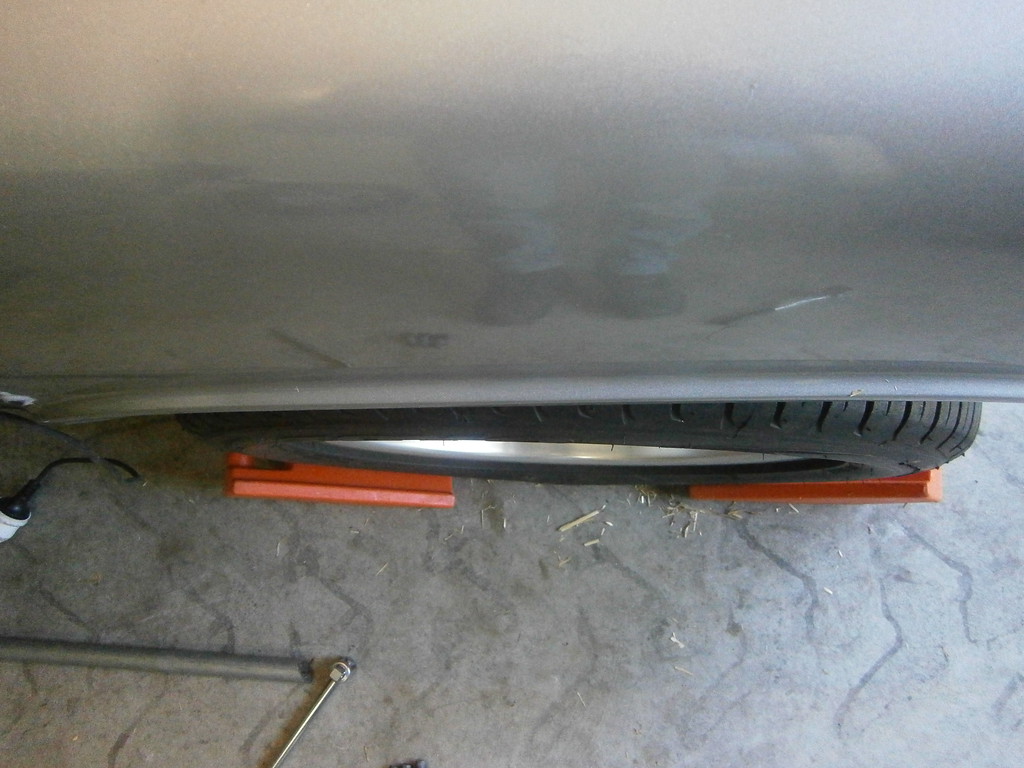

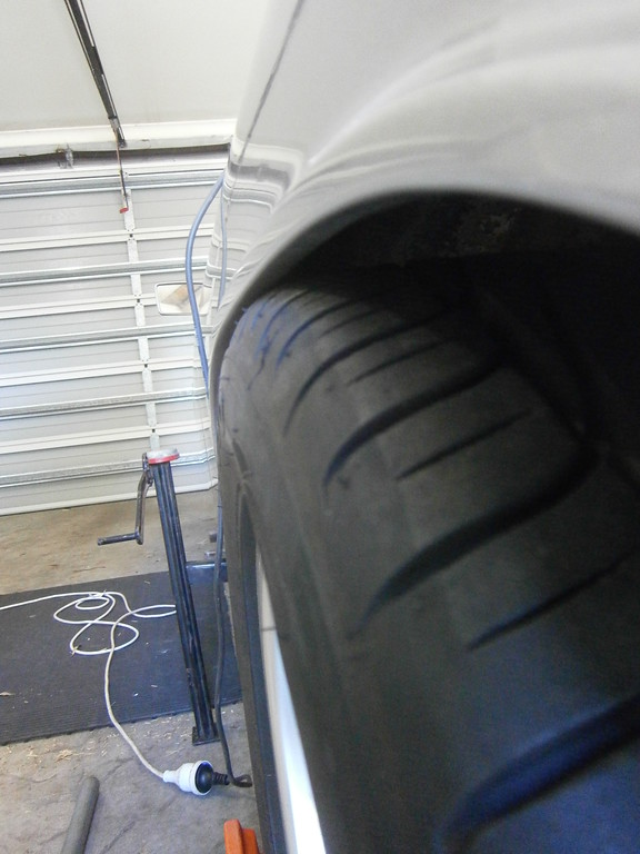

It can vary from car to car or be different on the left hand side compared to the right. This is due to variability in the construction of these vehicles. On my '72, 6"x16 Fuchs fit nicely on the rear but my 7" Fuchs have no chance, I'd have to pull out the guards or roll the lips in a little, something I didn't want to do. No problem with guard clearance on the front for 7" Fuchs. I think it best you wait for the vehicle then measure. If the car is 4 stud you can still check by holding on the Fuchs with one bolt - just don't drive it biggrin.gif
Images testing with 7":
IPB Image
IPB Image

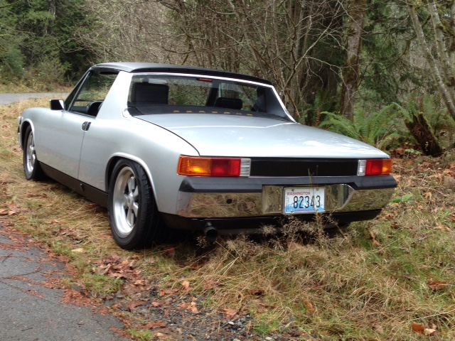

Proxes 205/55 on 7" Fuchs 911 361 020 44 in the photo.

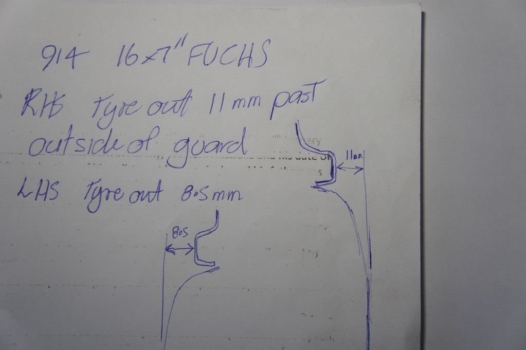

I found my old measurements. It is an example of the difference left compared to right on my car. The outer edge of the rim is 12.5 mm inwards from those particular tyre outlines.IPB Image
