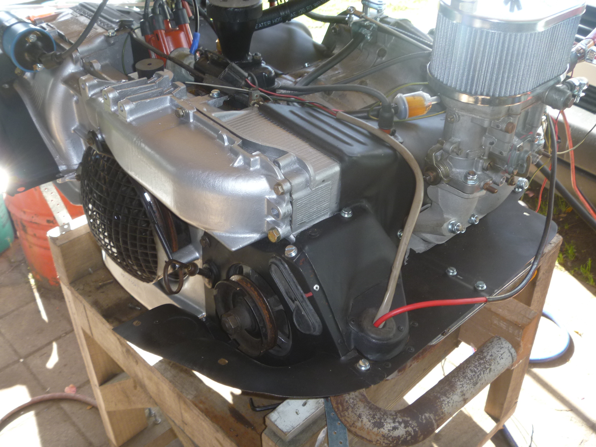

Just done a 1.8 carb cam motor on Dellorto DRLA's 36mm easy to tune with 28mm vents,nice idle with easy starting,I really like these carbs.
40mm will run fine with 28mm vents on a mild small bore motor,and provide a good driving street car.
I'am constantly amazed @ the amount of folks trying to run oversize carbs on these engines ,they just run like stromberg.gif and are SO hard to tune due to poor vacuum signal ,leave the big carbs to the high rpm big horsepower big bore motors IMO.
