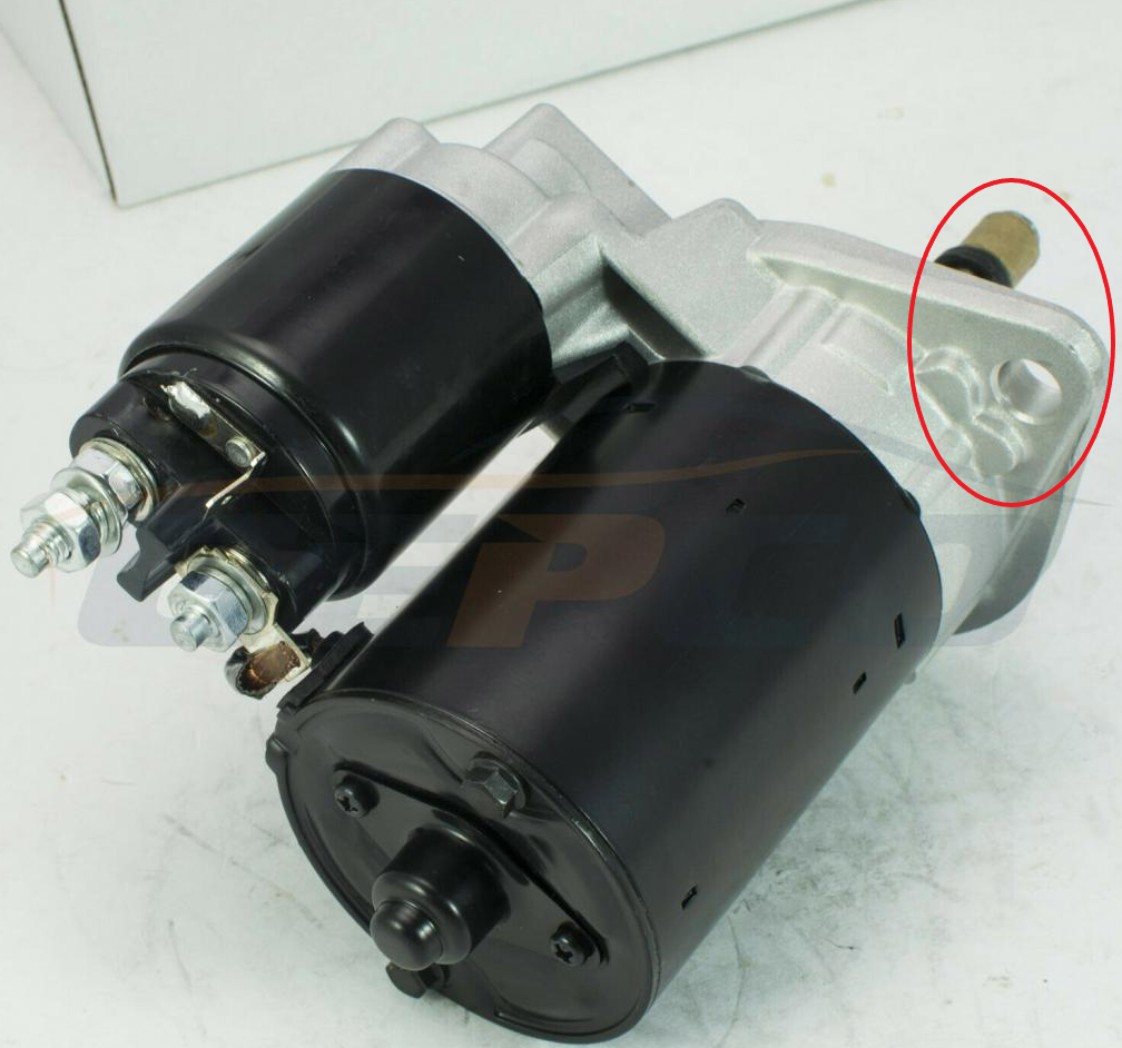

dt4
I guess I can make this easier to get the jumper leads to the starter by putting the battery under the car? so not having to thread them down and around and also not as likely for the positive to contact something it shouldn't?
I am clear on which is the positive for the starter
could some one show which is the negative or is it obvious once I get back under and take another look?
dt4
I took a photo from ebay, I am guessing the negative is the terminal that is not the positive biggrin.gif

We still have some conceptual work to do.
The entire car - everything metal is negative. So, the negative lead should be connected to the starter chassis or a point close to the starter. See the red circle in the picture.
We are testing the connections from the neg term on the battery, through the car to the starter, there is a ground strap that connects the engine/trans to the chassis - this may be a problem.
Spoke
QUOTE(dt4 @ Feb 12 2020, 02:36 AM) *
The lug closest to the starter body is the positive power for the actual starter motor. The lug towards the top of the picture is the connection to the battery. The bendix (small cylinder above the starter motor) is a contactor which connects the 2 lugs together electrically to turn the starter motor. The bendix also pushes out the gear which engages the flywheel so the starter motor will turn the flywheel.
The small electrical tab on the bendix is the power (from the ignition switch) to power the bendix.
Personally I wouldn't try to connect any wires or jumper cables to the starter. I would inspect the wires and if anything, measure the voltage on the lug from the battery when the starter is engaged.
Once you have the voltage at the starter, do the same measurement at the battery measuring from the positive terminal CLAMP and at the actual battery terminal. This will test the clamp and wire to make sure it is electrically sound.
Also check the ground strap on the battery to chassis AND the ground strap on the transmission. All cables should be clean and secure.
