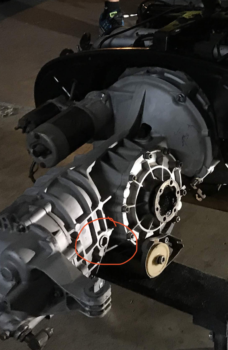

How can we check the trans fluid level don't know if there is a dip stick, don't think so.
ndfrigi
QUOTE(brcacti @ Jan 18 2020, 05:54 PM) *
you can just open the filler plug and just use your finger to feel the gear oil or fill-it up till it pours out. Need un usual size of tool to open it.
914Sixer
Use a 17mm allen head socket or L shaped key.
Bartlett 914
If it has been awhile, don't check it. Change it! Remove the fill hole first then drain plug. Dino GL5 oil. Transmission oil is too often ignored. It needs replacement. I do mune annually
