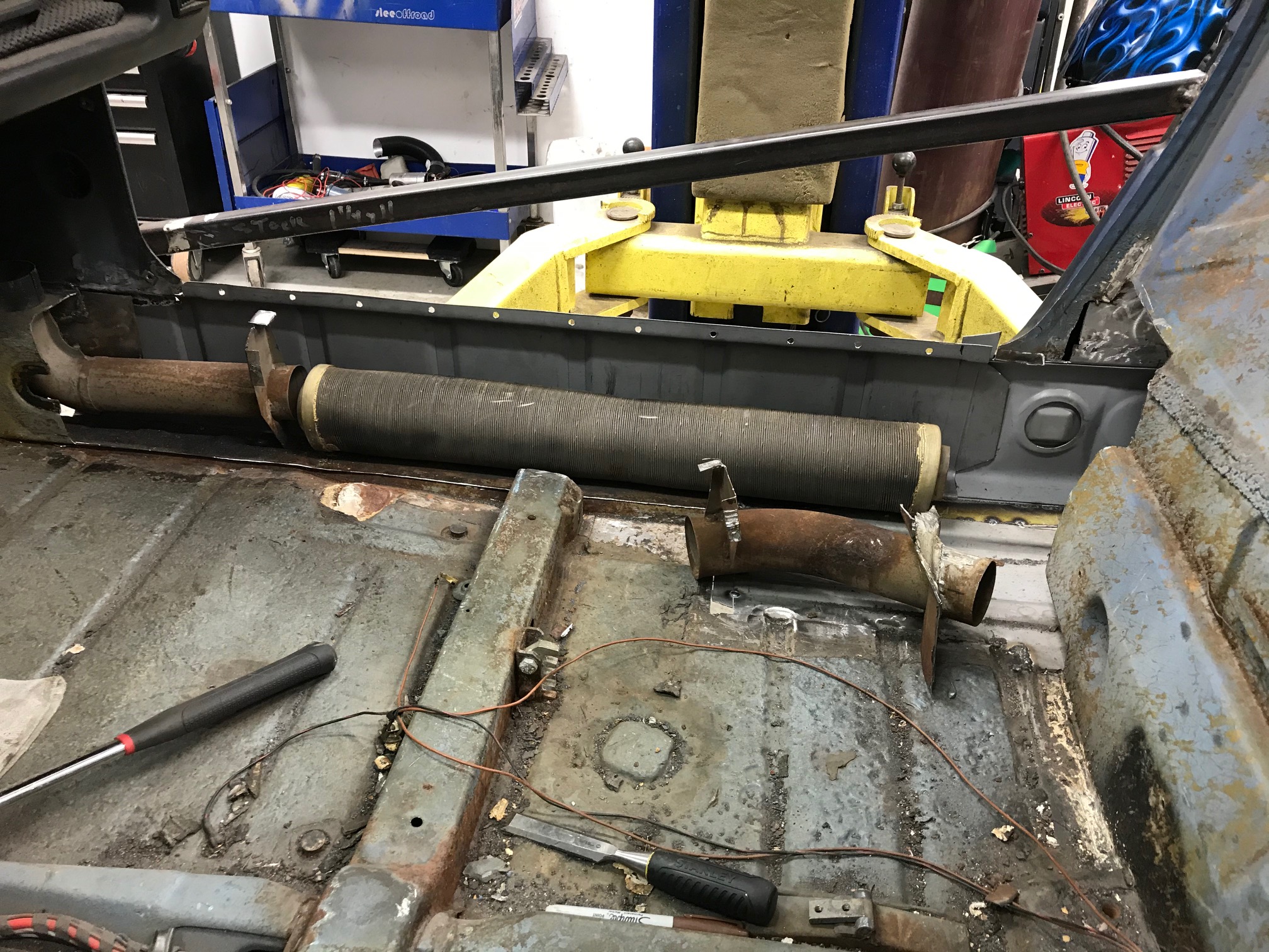

What bracing do YOU use when your doing rust repair to that level? Surely a door brace is not sufficient...
I would imagine you guys have a bench or a jig?
dr914@autoatlanta.com
yes we have a bench, many other braces (like the top brace) and a frame machine and measuring sticks. We are constantly measuring while we do the work so there are no mistakes.
Years ago I was welding the battery area in my 914-6 with acetylene and prided myself in how well I could swing a torch (LOL). Got the whole job done beautifully and then tried to shut the passenger door!!!! The hole was too small, I had shrunken the car with the heat!!! Had to put it on a frame machine and stretch it back out. Learned a good lesson A measuring stick is your friend and should be used often

I made a dolly that holds the car at the suspension points, and of course door braces. Like in this case, the longs had to be completely cut from the car and replaced. I wanted to make sure the front and back halves of the car would neither translate nor rotate when the longs were severed. Won't know how effective my dolly is for a little while yet. I am measuring the door openings constantly as I work.
This is what I would have expected.. The pic just looks like its on a 2 post with a door brace which is why I was concerned. I know they work on a lot of 914s so Im sure they had more than just what was pictured.
