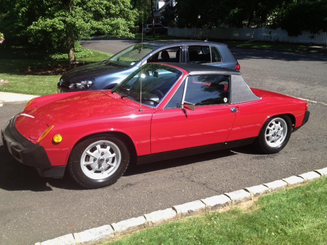

Don't really have a photo that shows the fit well, but I have run them for many years in my 914. You can slip a finger between the body and the tire.

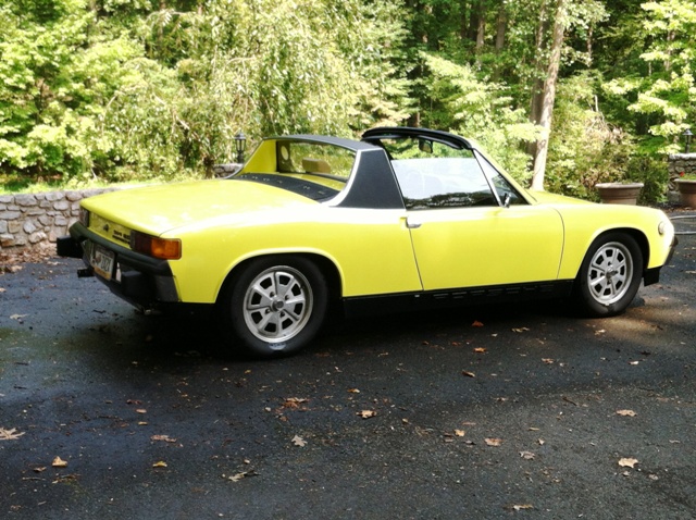

Here's Pete Stout's (000 Magazine) '73 914/6 conversion wearing 185/70/15 Avon CR6ZZ tires on deep 6's.....
rgalla9146
Perfect ! They all look great.
When handling them they seem so tall compared to modern tires.
Thank you all.

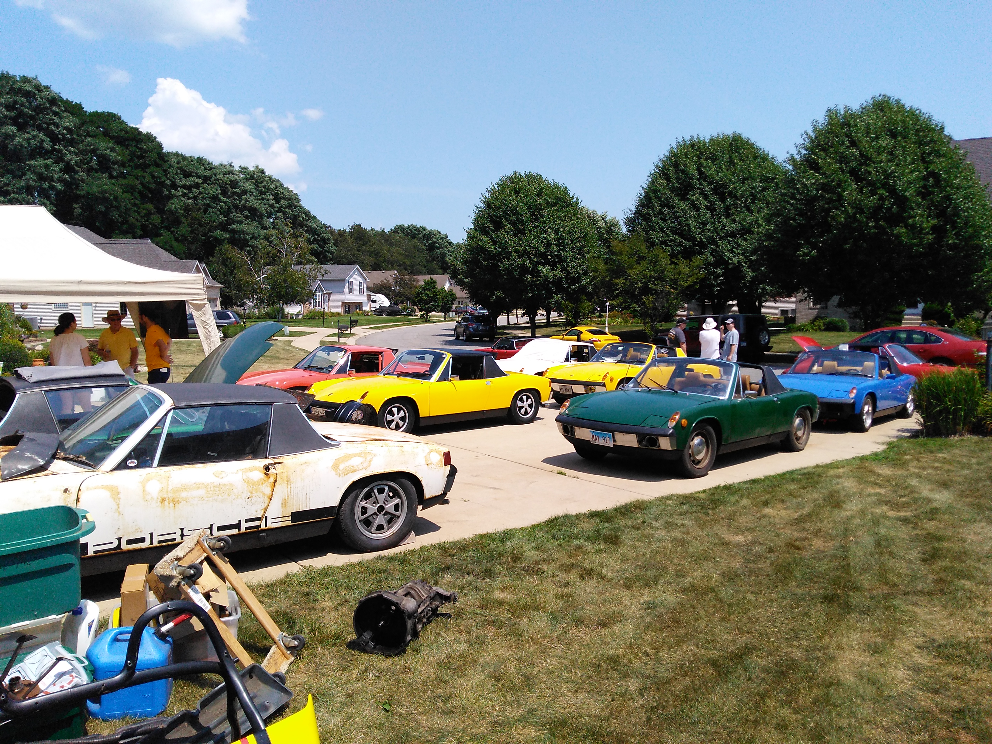

Hey Charlie this pic's for you.
Do you remenber the Red Apple Rest on Rt.17 ?
205/55 15's all around

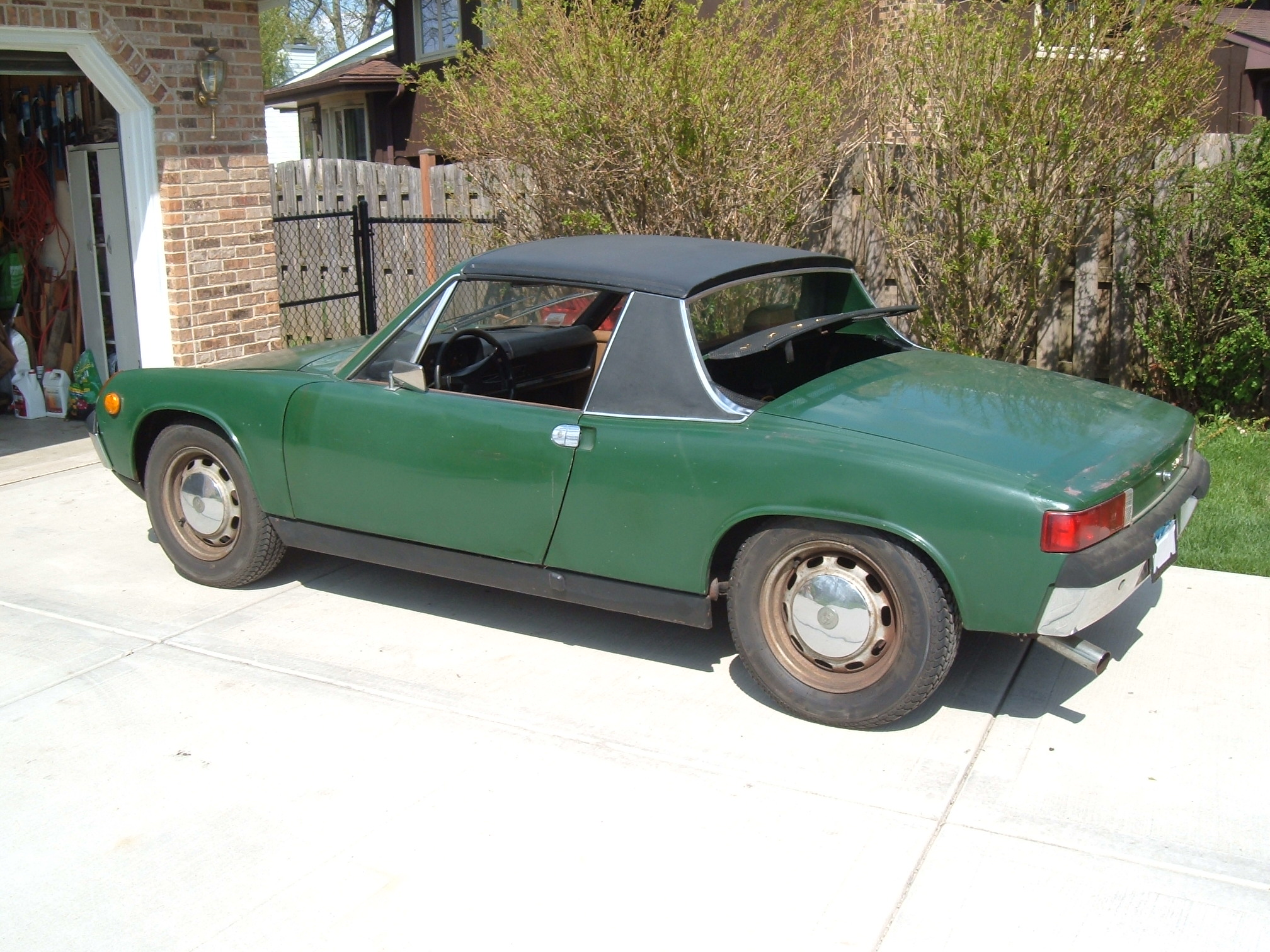

Mine is the green one. '70 -6 with stock 'steelies', 185/70-15's.
I have a better closeup picture somewhere....Click to view attachment
fixer34
A little better..Click to view attachment

QUOTE(fixer34 @ Jan 24 2020, 08:17 PM) *
Your car is perfect.
The ultimate anonymous 6

QUOTE(fixer34 @ Jan 24 2020, 05:11 PM) *
Love this picture!
