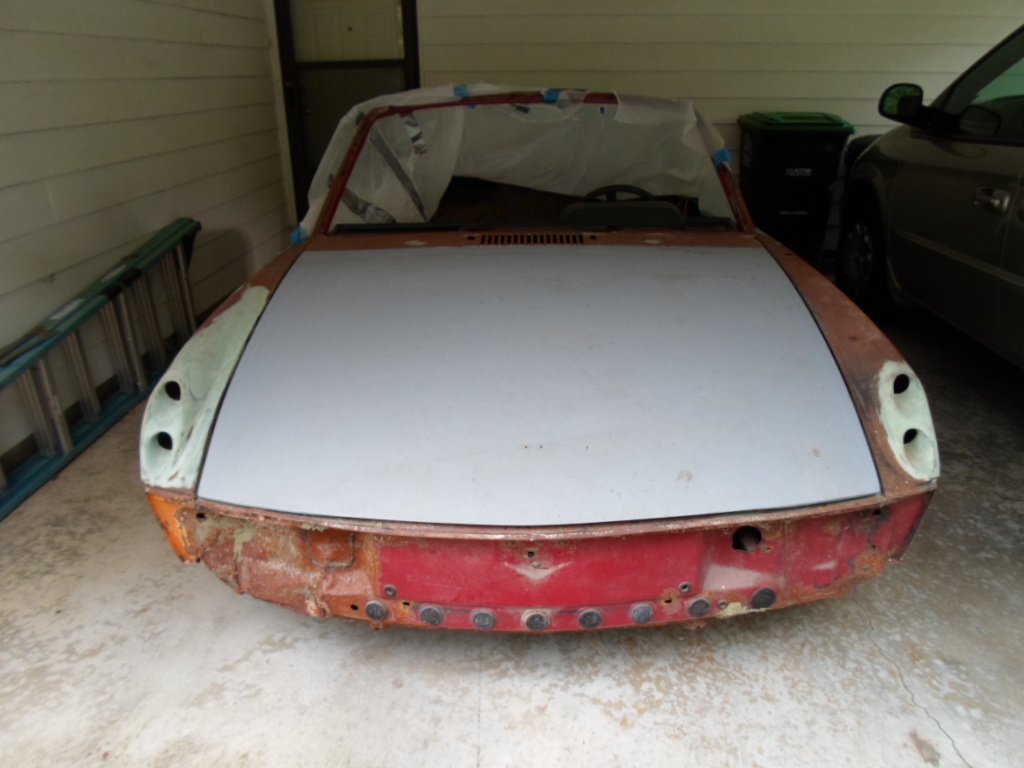

That's a valid point, and I really didn't want to get too deep in the weeds on this before I have laid eyes on exactly how things are set up with this vehicle. However, I THINK the current owner is using airflow from the holes behind the valence/spoiler area, as it is currently missing the front spoiler.
When I replace the front spoiler, I don't think there will be sufficient airflow to feed the cooler. Ideally, I would like to close those holes back. My other option would be to make a proper cutout for the cooler, however there is a better than 50/50 chance that this car is a mostly original Bumblebee LE, so I don't want to cut on it.
Much of this is supposition on my part, and I need to see it in order to really view what is going on. I've included a pic of an old car of mine with the area in question that I think he is currently using to provide airflow to the current unit. It's where the 8 or 9 black caps are....imagine if they were removed.

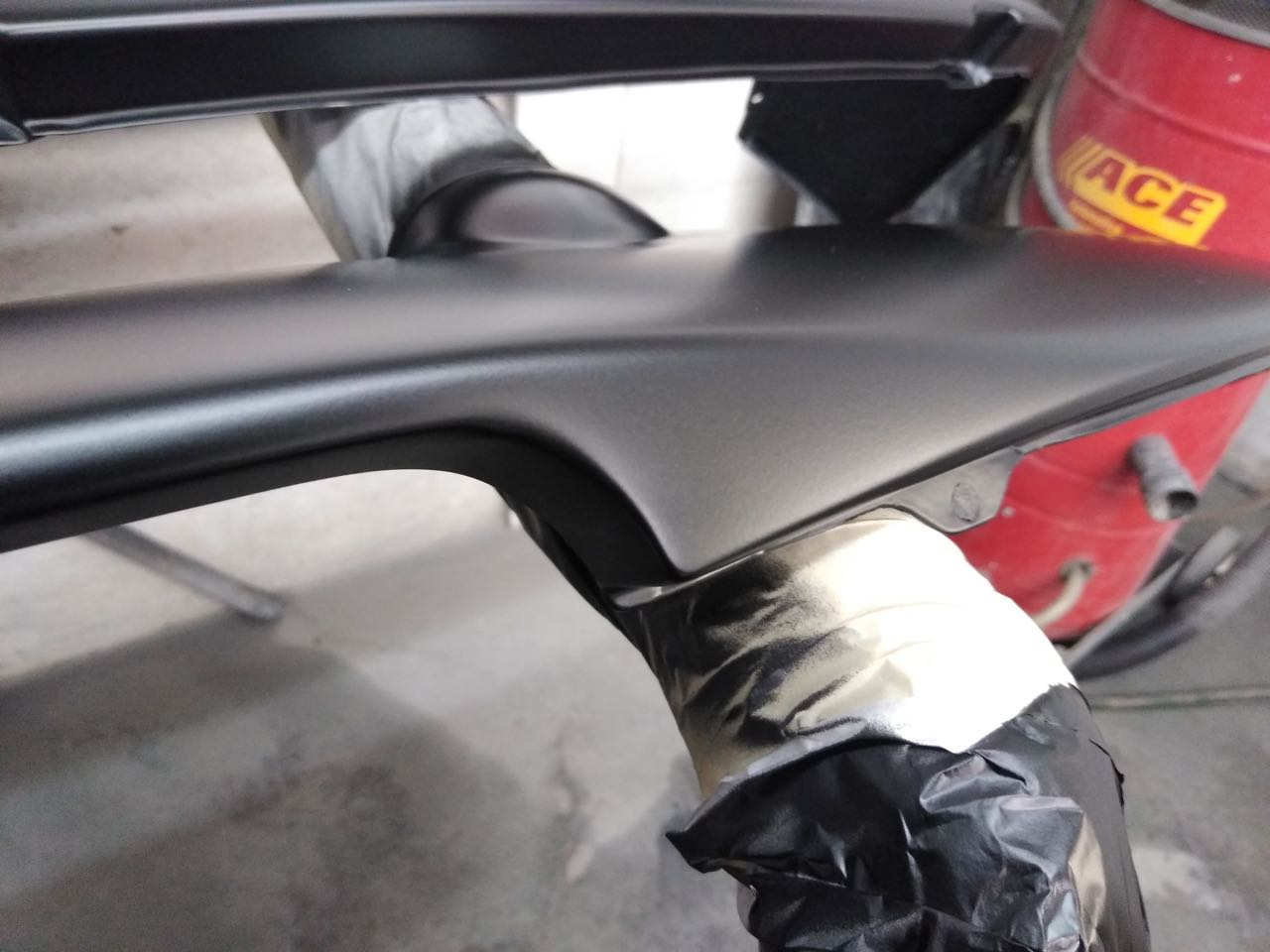

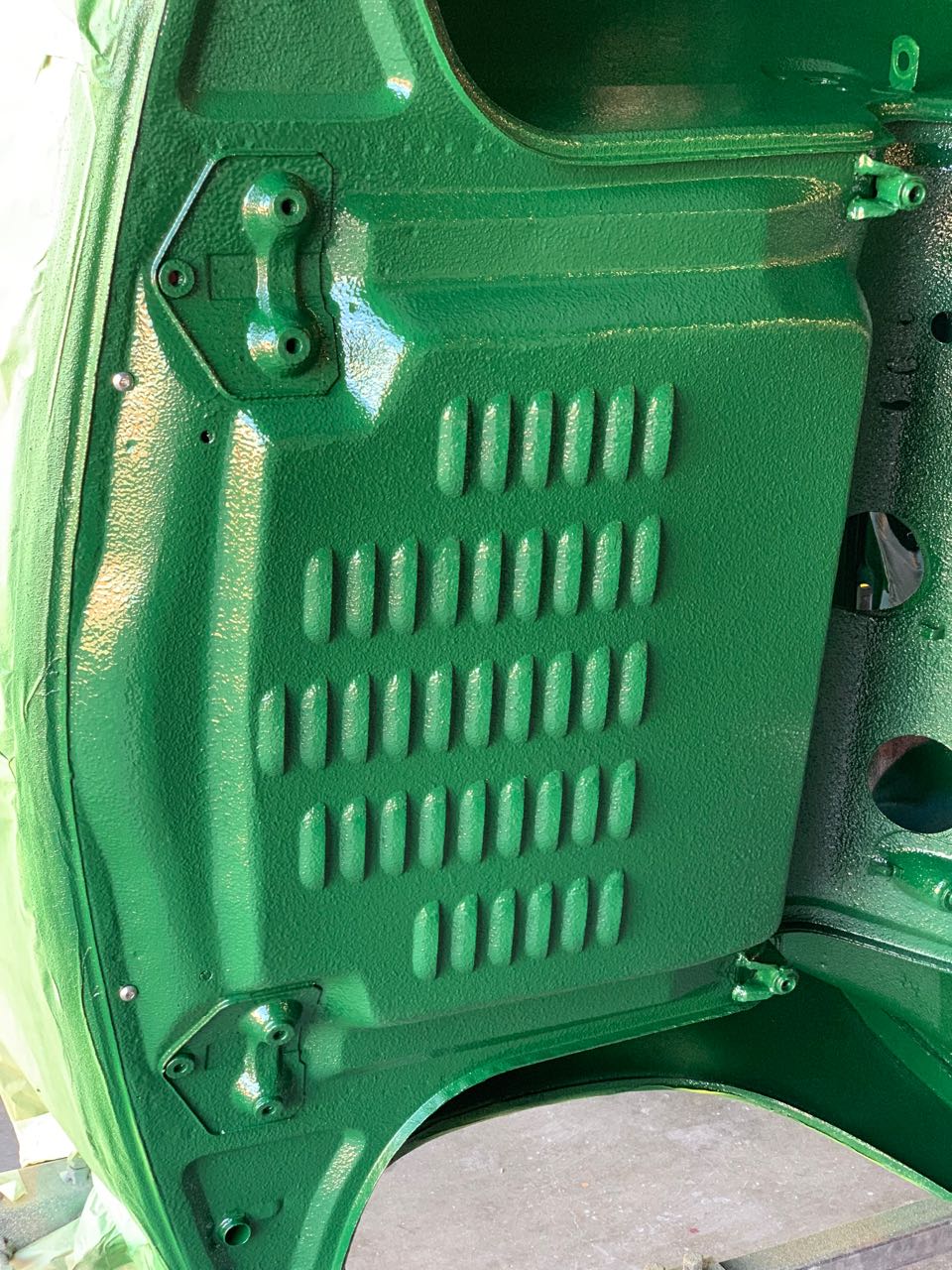

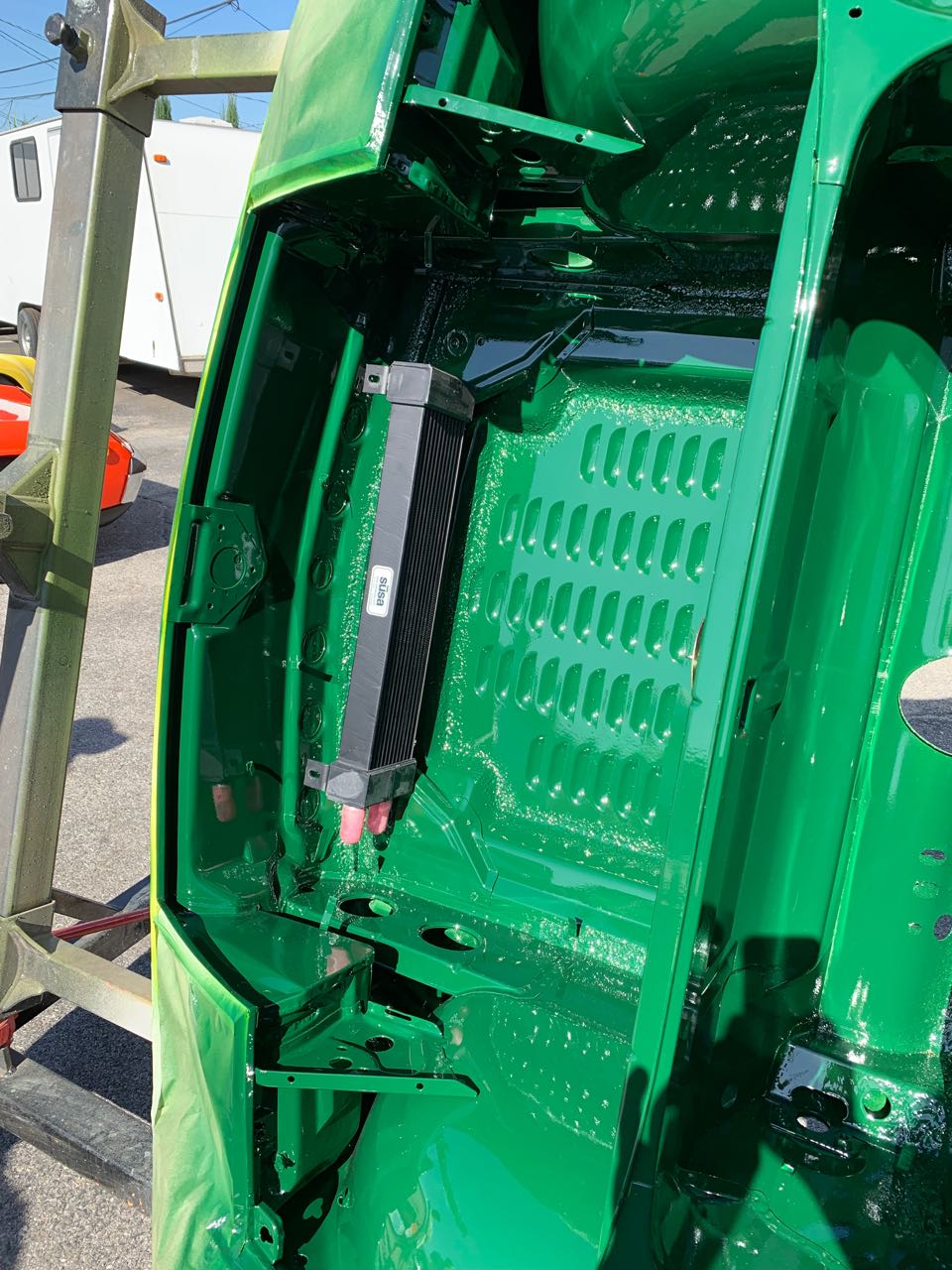

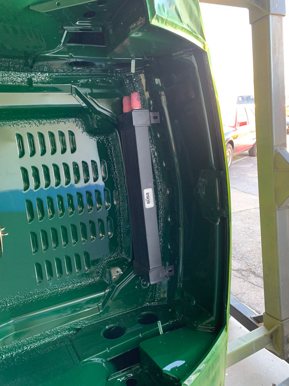

So, that is exactly what we did on my car. I have the GT style oil cooler in the front trunk and we left the 5 center most black plugs out and have the valance slightly modified to allow more air to flow to those openings. We have a shroud covering the oil cooler and sealing to the trunk floor. The floor is louvered for air to flow out. We should know pretty soon how that works for cooling. beerchug.gif

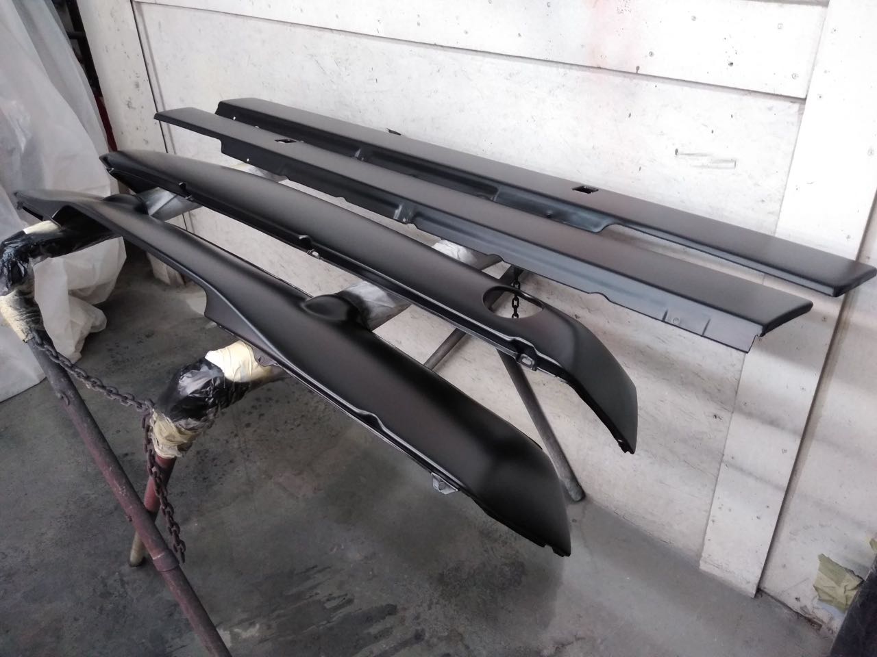

Here are a couple pictures showing the front valance:
