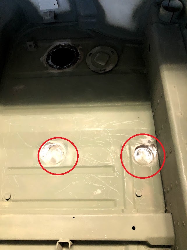

Ok I had my car media blasted and found something very interesting. On both sides of the floor board and one under the foot pedals there are round impressions with a half moon shape cut into them, total of five. Is this from the factory? What was their thought process on that? idea.gif screwy.gif Thinking of welding them up.

peteyd
I think that Al is asking about the circled portion.
These were present on all 911 floorpans as well. They were probably for drainage. That is all that we can imagine they were for. Whether it was for a process on the assembly line? I'm sure the 911 guys have discussed it as well.

ahycaramba
Thanks for the insight gentlemen.
Pete you were right on the money as to what i was referring to.
I'm glad to know mine is not a one off.

ClayPerrine
The big round holes with the plugs in them were to hold the panel to the assembly jig. Once the body was assembled, the jig was removed and the plugs installed.
As for the small ones with the half moon cutout, I would doubt they were for spot welder access. That would require bending the metal before welding, and bending it back once done. Most spot welders on assembly lines are either big monsters with huge jaw openings, or they are built into the assembly jig.
Maybe for drainage when they dip primed the chassis.
UROpartsman
Indeed, these cut outs have been the subject of many discussions on 911 forums. Many folks believe they were intended to allow drainage after the parts were dip-primered, but Clay's body jig explanation also makes sense for the large holes. The openings were later sealed with bitumen on the inside and body schutz on the outside, so they were never intended to be open on a finished car.

ClayPerrine
I have a Porsche factory video of 356 bodies being built. It shows the metal being put on the jigs as they add each part, and they use the same big holes to connect to the jig. The little holes were to drain away the excess paint when the chassis was dip primered.
