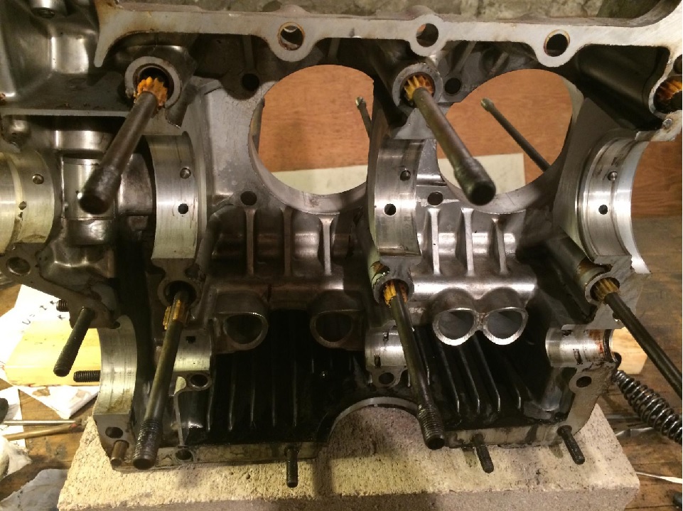

Not to high jack this thread, but what are the eight white ribbed plastic sleeve-like things that are shown in the plastic bags in the first couple of photos. My gasket kit also has them, but I haven't seen anything like them in/on my motor.
injunmort
Feb 4 2020, 05:47 PM
vibration dampners for the cylinder studs used on a bus.

motorvated
Feb 4 2020, 06:20 PM
QUOTE(914Sixer @ Feb 4 2020, 05:02 PM)
Vibration dampers go on all type 4 engines.
If I'm not mistaken, there are 16 cylinder head studs on Type 4 engines, and only eight of these vibration dampeners in the kit. Install two per cylinder? Install them where, bottom of cylinder, top of the heads? I'm confused.
BeatNavy
Feb 4 2020, 06:51 PM
Are there eight in the kit or six? They go on the long through case bolts, not the head studs:

6 vibration dampers on case thru bolts. Have never seen windage tray rubbers in any of the 3 dozen kits I've used.
