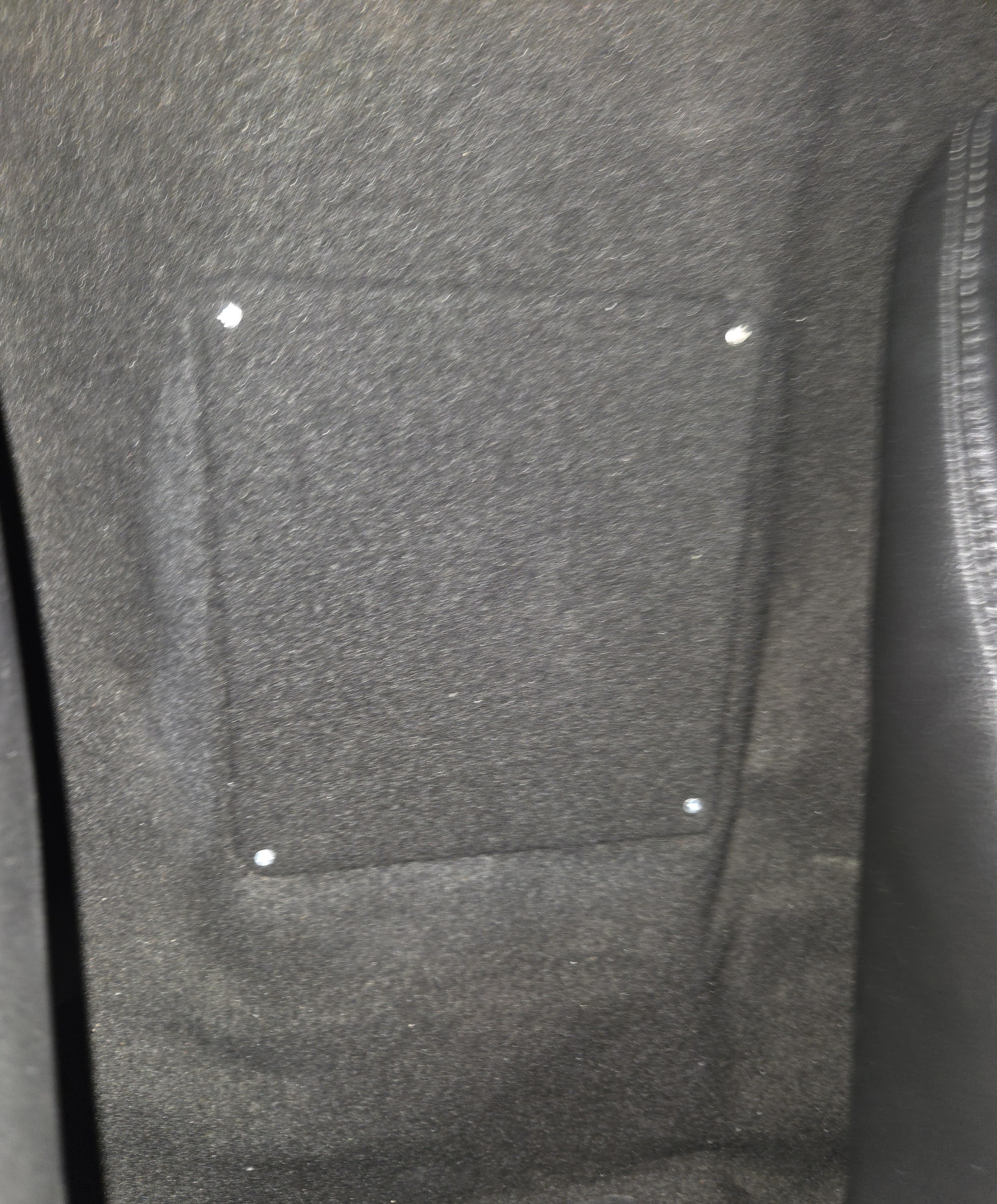

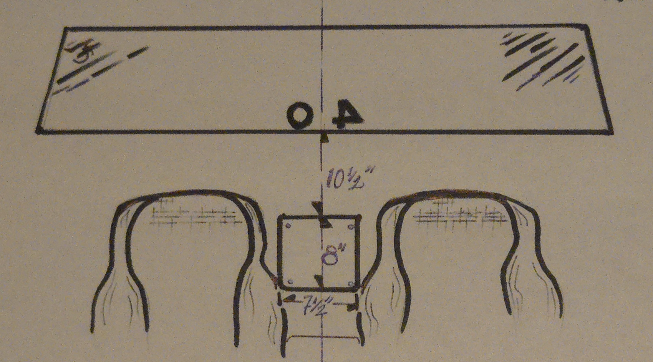

Hey Marty, can I request that you post some dimensions (length/width) and location (distance from either the floor or rear window) of the firewall access panel? Going to try to replicate it in my 6 conversion.
Maltese Falcon
QUOTE(troth @ Feb 12 2025, 06:08 PM) *
Yessir...I'll get some dimensions for you>> and post here.
M
Maltese Falcon
@troth the measurements will be as looking Aft' from within the 914 cabin.
This picture shows the basic layout, dark gray felt material, and the 4) sheet metal screws holding the metal plate (8" Height / 7½" Width) in place. Your firewall cutout should be smaller, in order to leave a metal edge where the fasteners will secure to.
Your Center Line is established as Center of targa window. The 10½" distance = bottom of where the window sits on the metal 'Step of interior bodywork>> to the Top of metal plate location...next diagram.
Maltese Falcon
@troth Diagram with location/ dimensions, 18ga. Sheet metal is nice + stout.
troth
Thanks Marty that's perfect!

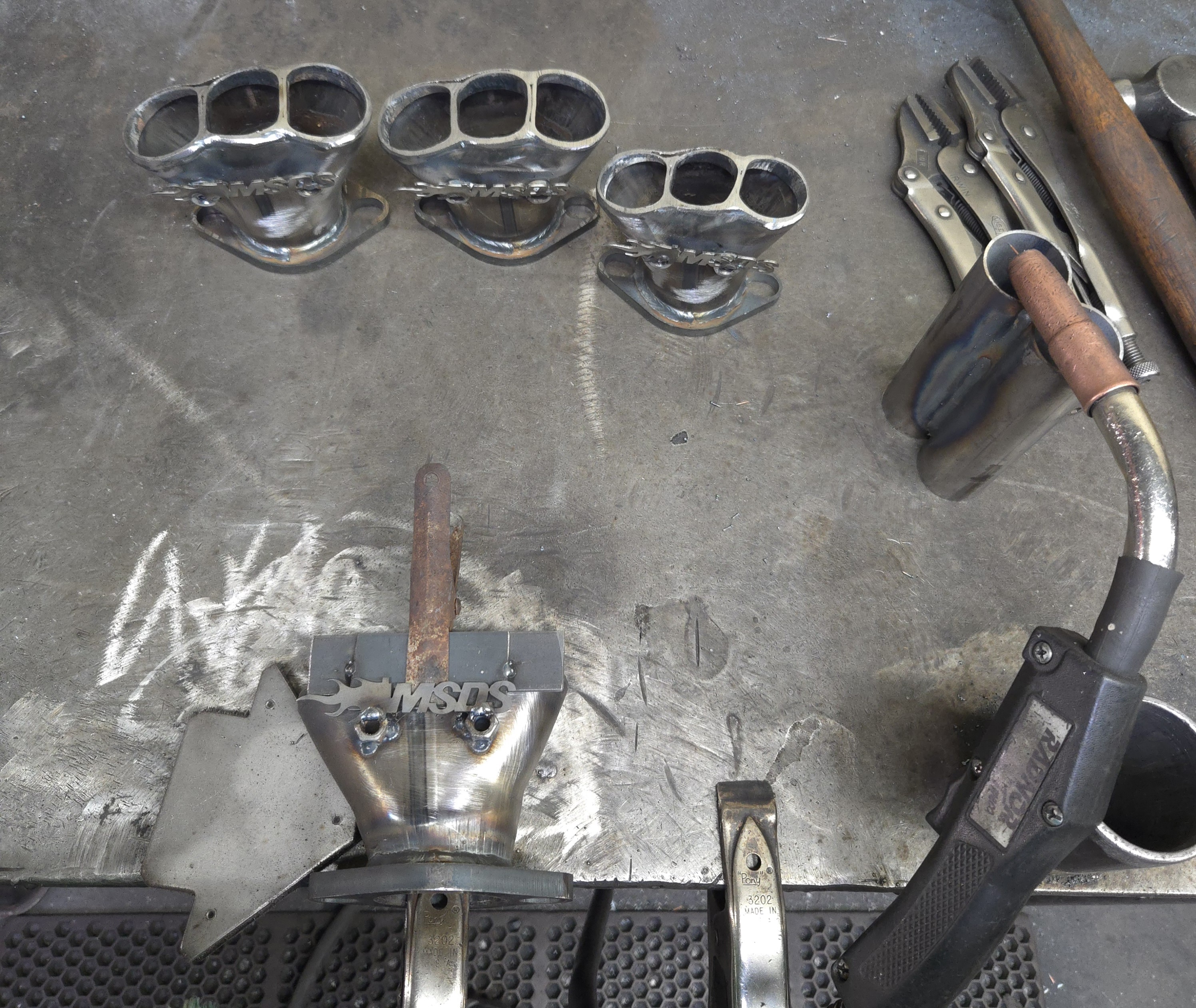

Some leftovers from our 'Prototypes on the gt exhaust headers...making some desk swag from the scrapped parts
