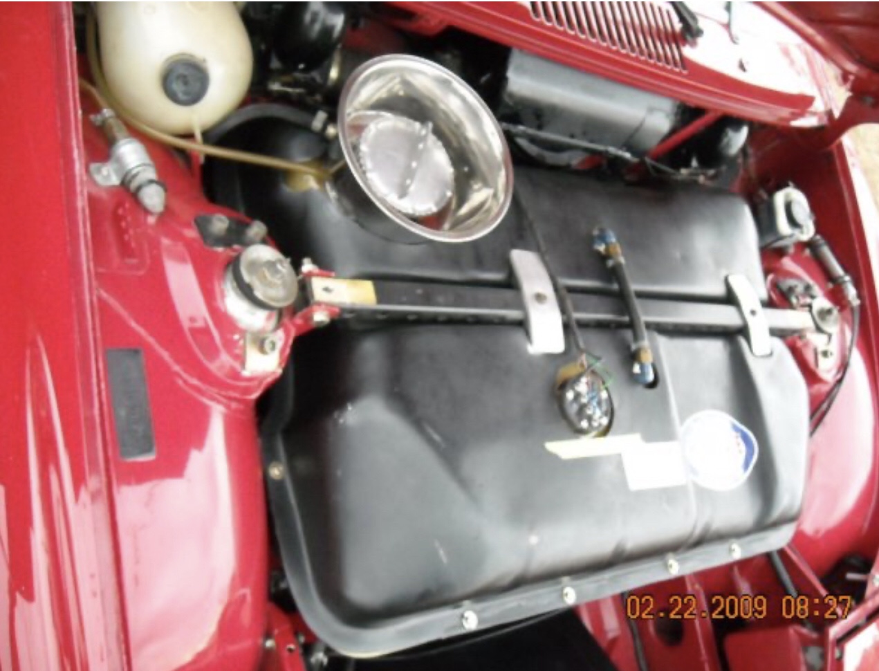

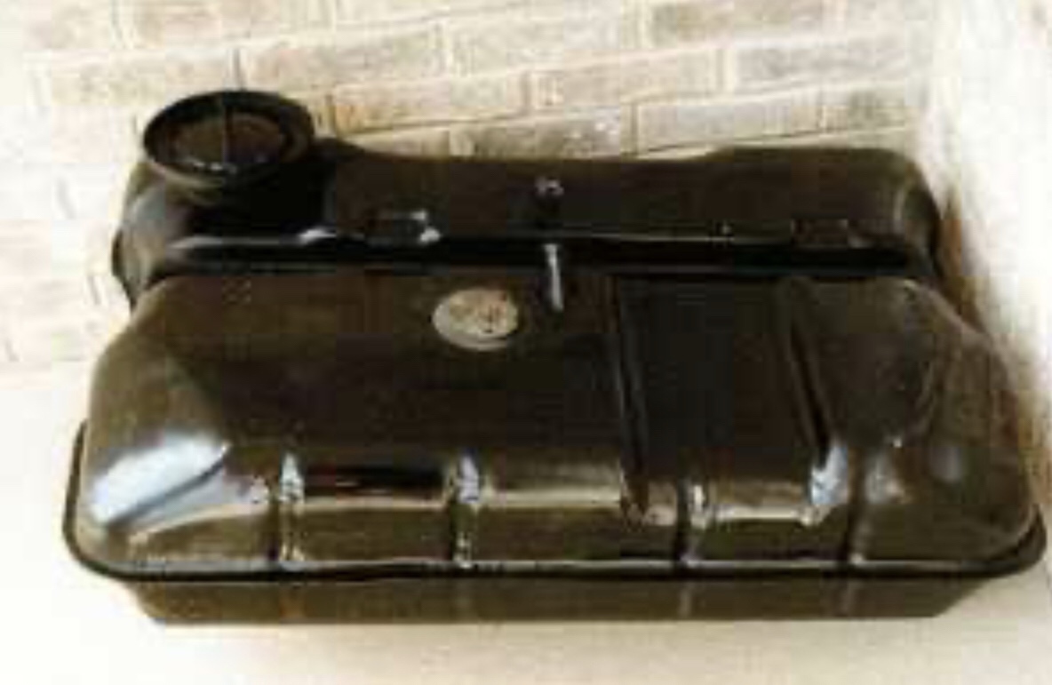

Just wondering if the GT fuel cells were ever reproduced or available?Click to view attachment Click to view attachment

Last one I knew of was fabricated by Kerry Morse, but that was back in the 90s, I doubt Jon would have paid 11K for a fuel tank, but who knows what he had invested in the #40 clone he was building.
I did not know Mittlemotors was building them, makes sense.

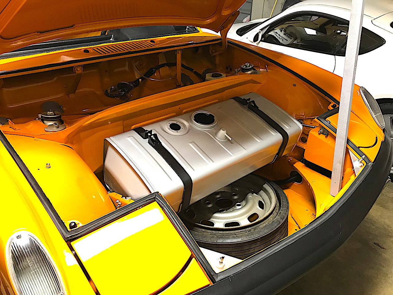

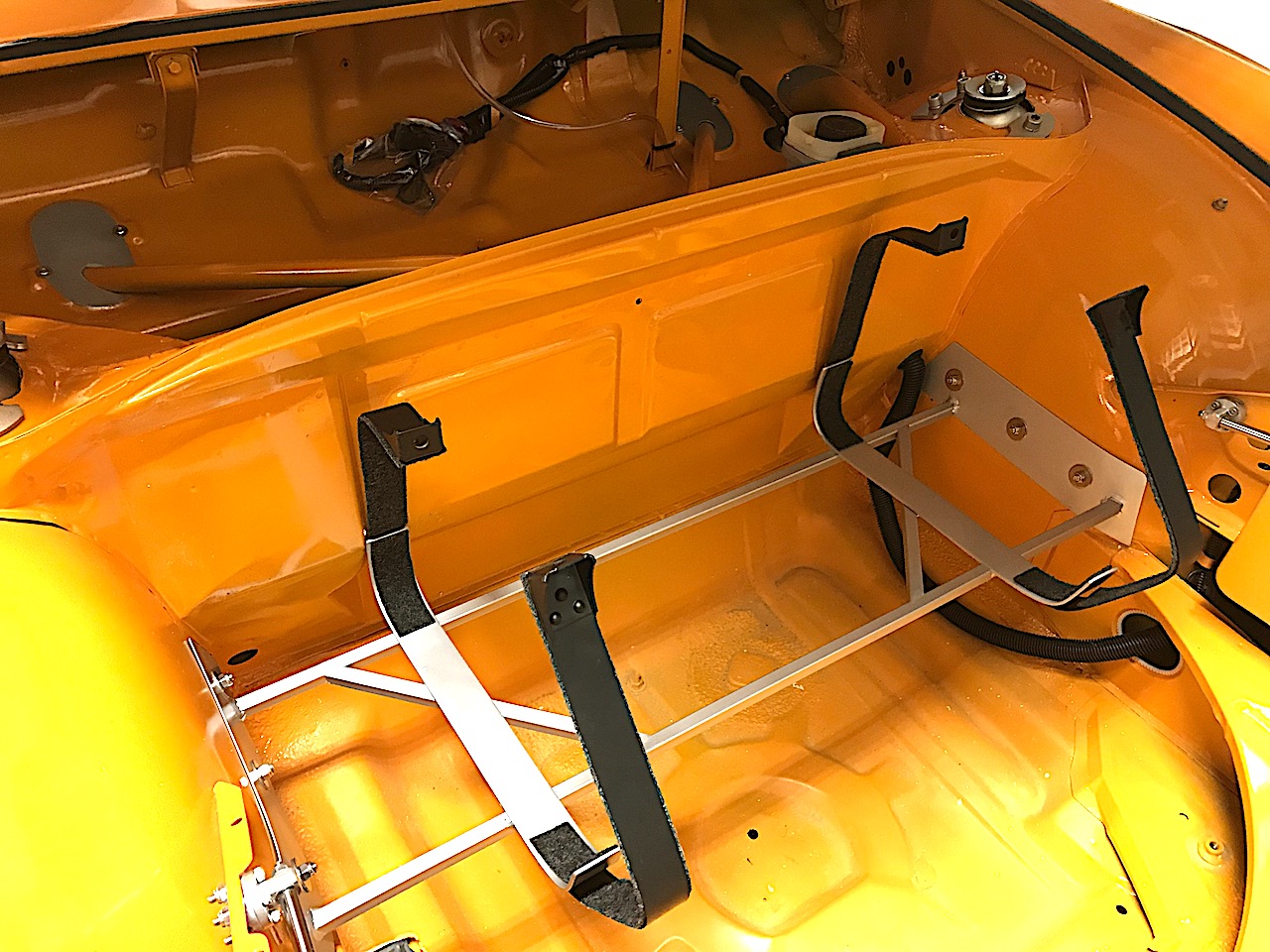

I was going to put in a front fuel cell, opted to create something else. 356 tank up front. Could maybe fabricate a GT out of two 356 tanks. Best, MarkClick to view attachment Click to view attachment

Patrick Motorsport’s makes a cell conversion of the original tank. I don’t think though that it is GT replicated...
Steve
QUOTE(ConeDodger @ Feb 9 2020, 05:45 AM) *
Nope the PMS tank is only 10 gallons and uses the old tank as a clam shell for the bladder. I had one in my car. The bladder is replaceable since they have an expiration date on them. Plus it’s pretty impossible to get rid of fuel vapors in the cabin, since the bladder is fabric. Besides being required for certain tracks, the only benefit was that the internal baffling prevented my 3.2 from starving for gas in the corners. With a stock tank, my engine would cut out, if the tank was 1/4 full in the corners.
