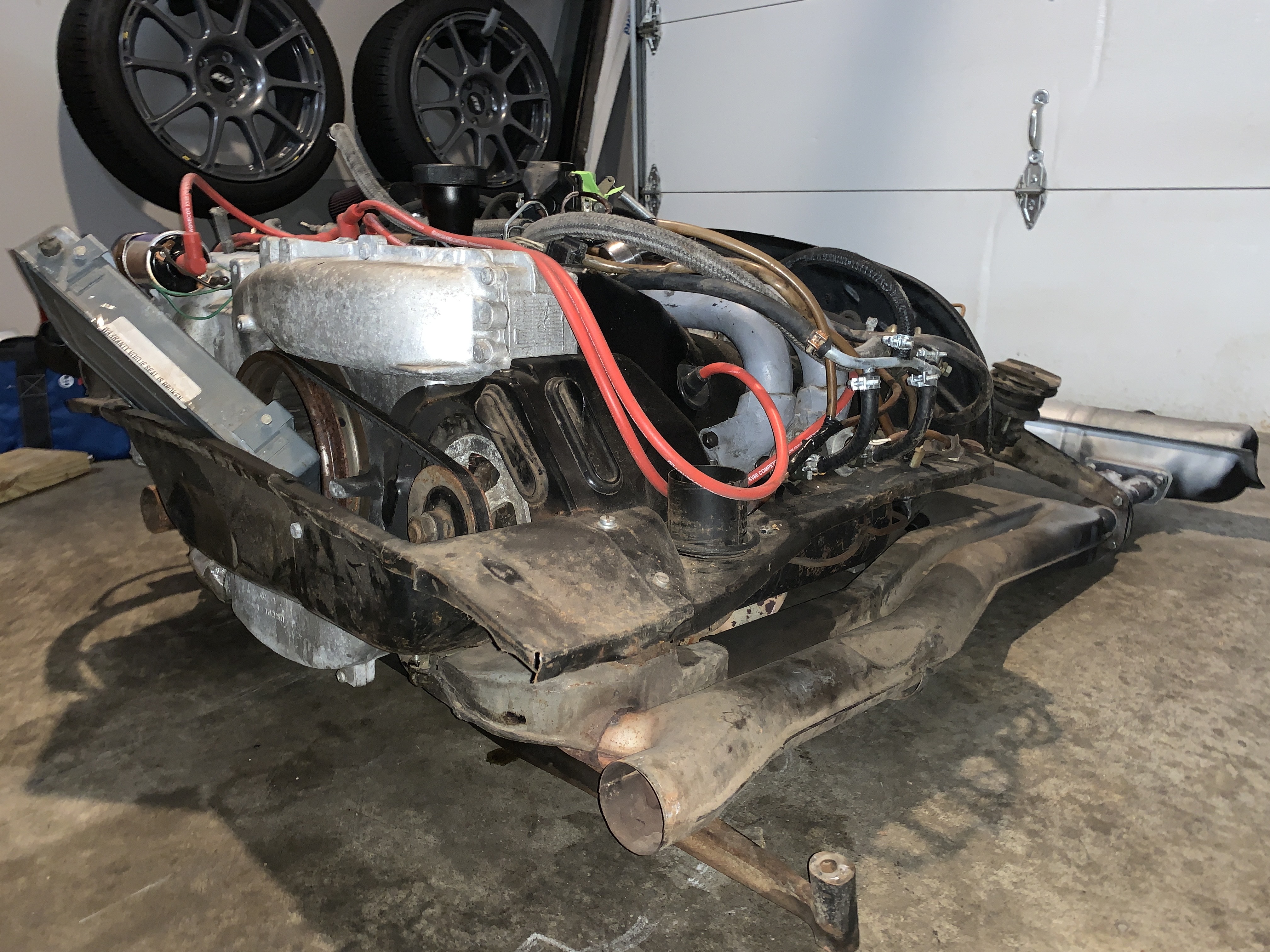

Engine is out, piratenanner.gif thinking about deleting heat exchangers. driving.gif What is the best source for ceramic coated exhaust manifolds?

Headers are the only true bolt on HP but with a stock engine the improvement isn't very big, I'd rather keep the heat.
It looks like you have an 75-76 exhaust, I'd back date to SSI stainless steel heat exchangers and a good muffler. The SSI's can be found good used if you watch the classifieds.
What's your budget? Headers you can expect to spend $600 (uncoated headers only) to $3K for a full system.

wow someone has really butched up your heat exchanger system, welding early pipes onto a late heat exchanger!

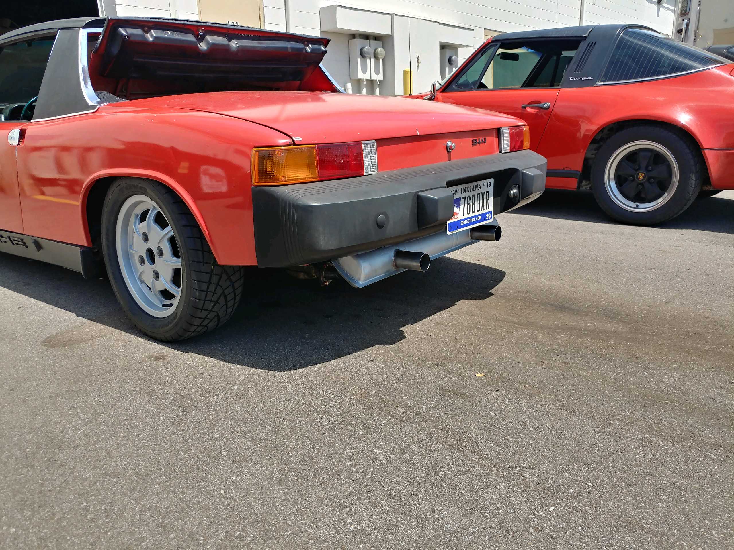

Yeah, the heat exchangers are crap. Honestly, I really don’t need them. My muffler was fabricated by Redstone Engineering here in Indy, looks better painted.Click to view attachment
