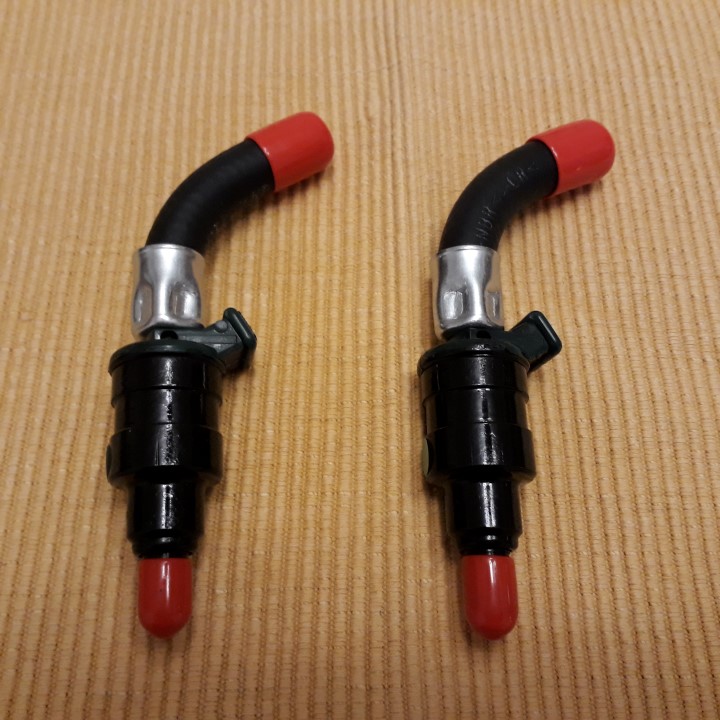

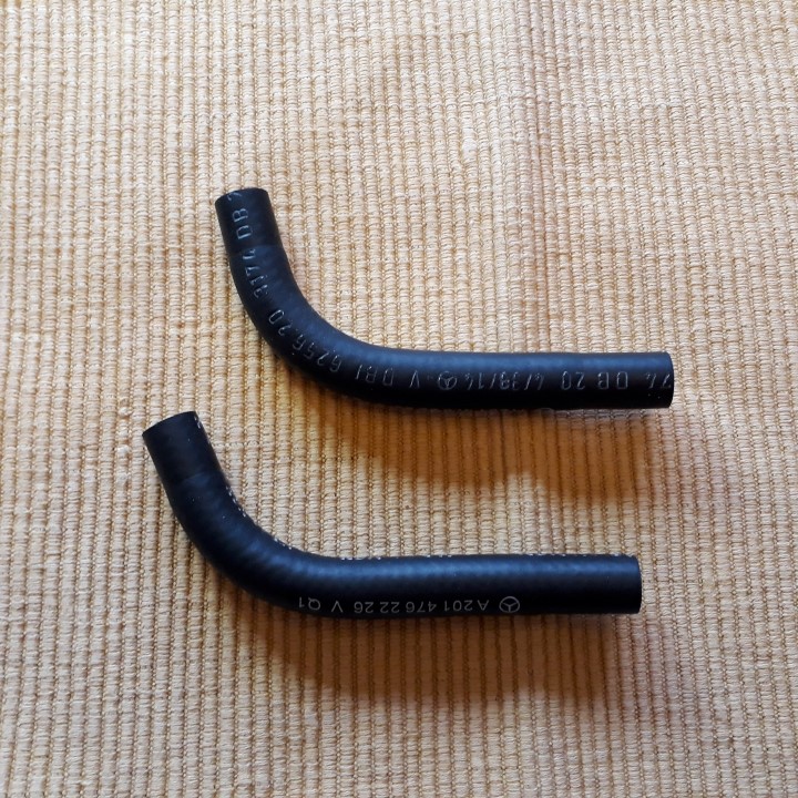

nordfisch
Hi,
you can use high-quality molded rubber hoses available at Mercedes-workshops.
Look at the upper picture - there is the part# A 201 476 22 26
Regards
Norbert
