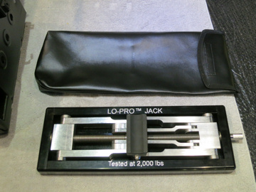

We also pack one or two quarts of oil, (just in case) and have a billet jack that's pretty light and compact.
horizontally-opposed
QUOTE(mlmgm @ Feb 15 2020, 08:48 PM) *
^ Pretty slick....
https://www.calcarcover.com/product/low-pro...uminum-jack/705
Suspect that might fit behind a seat? I like the aluminum 944 jack I've got next to the spare tire right now, but wonder if this is lighter or more compact, or lifts as high? Hm.

One review said that it didn’t raise his Porsche high enough to remove a tire. Had to carry a wood block for it. Fail.

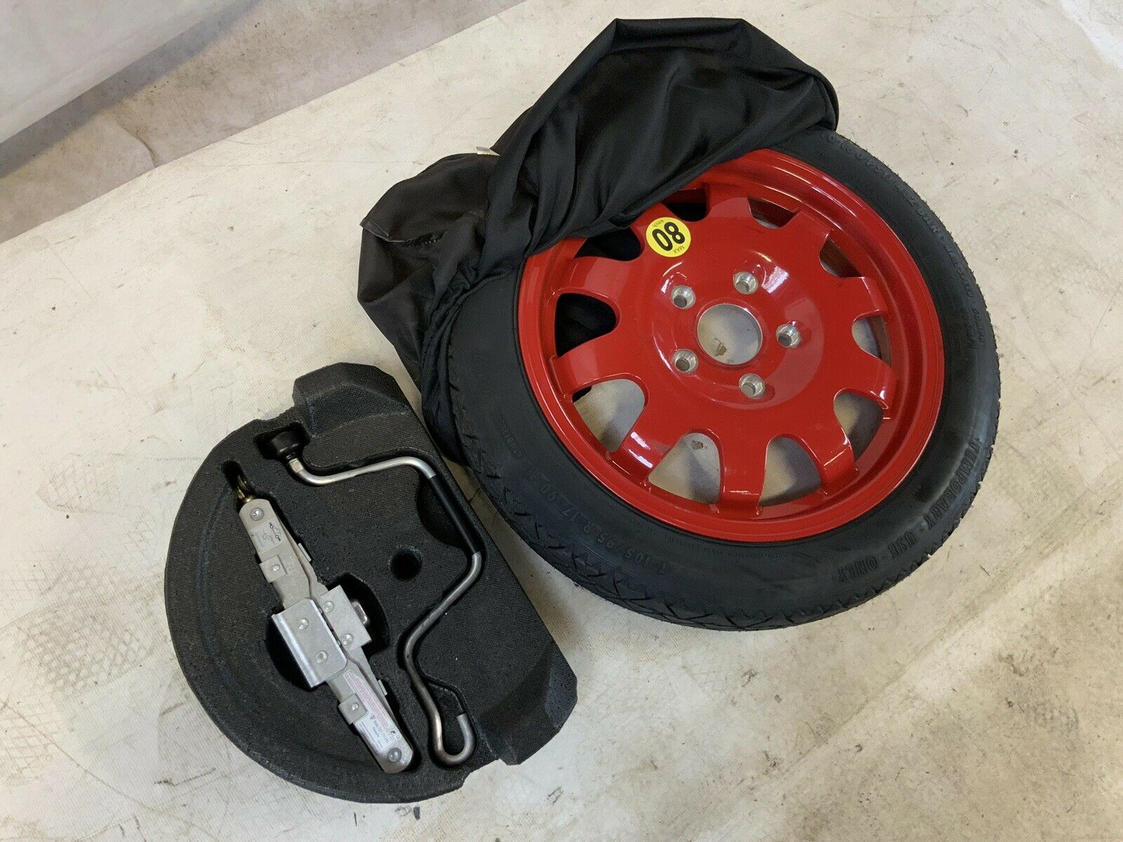

Throttle cable, clutch cable, cable ties, 19mm socket and breaker, and a small adjustable wrench. Oh, and my iPhone... And one of these:
Boxster 986 spare wheel/tyre (lightweight and same diameter overall as the 195/65x15s I have on the car) and matching alumin(i)um jack.

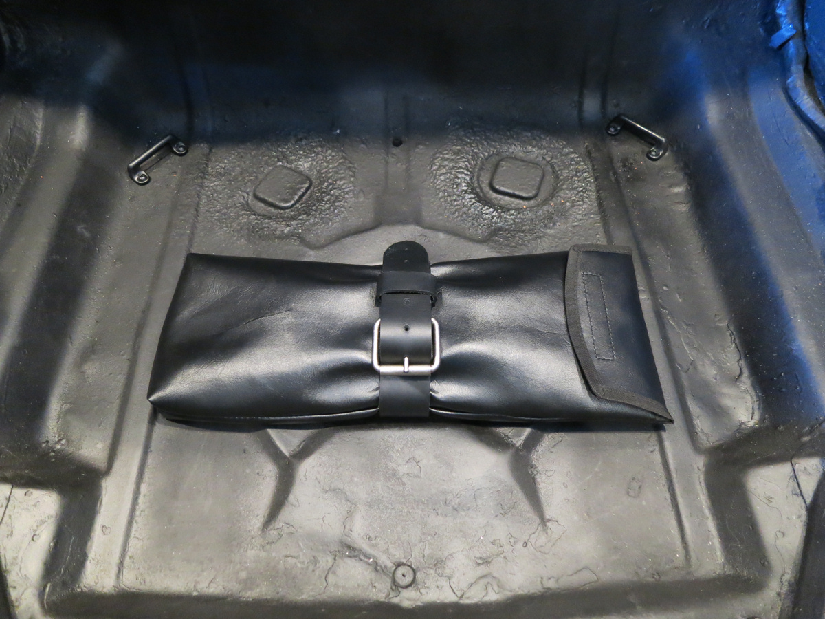

Our car sits fairly low, so the billet jack works for us. We looped it under the factory bracket in the front trunk and trimmed a leather belt to secure it.

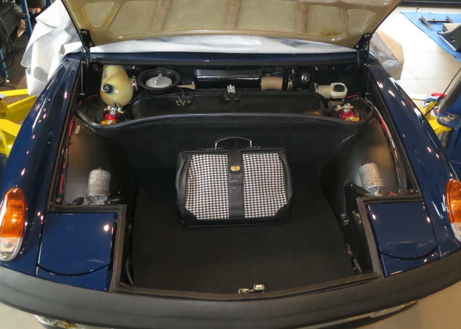

We used the Porsche medicine bag to carry the tools, etc. It also matches our seats.

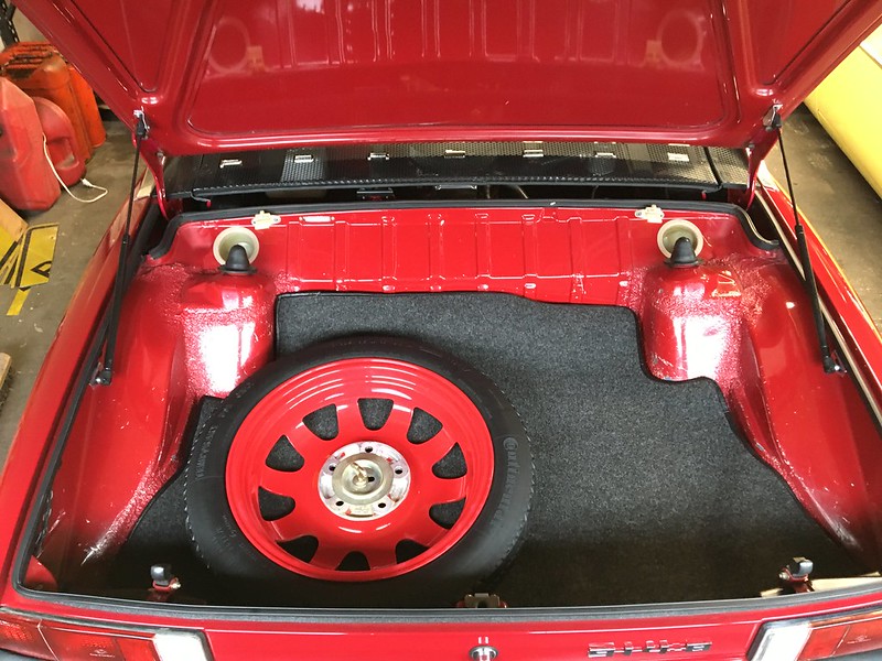

My frunk is filled with radiator, so I carry the 986 spare in the trunk...
IPB Image
The roof panel still fits and clips into the stock holders. The threaded hole for the hold down and the grommet in the trunk carpet were already there. The 986 spare in either location is the hot setup (especially if you run 195/65/15s).
