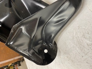

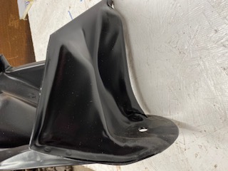

not bad, remove the swing arm, grind and sandblast and reweld. Look at the inner console and see if it is bad. The inner console we sell has some of the metal you need on it.
Click to view attachment Click to view attachment

QUOTE(dr914@autoatlanta.com @ Feb 17 2020, 01:49 PM)
Click to view attachment Click to view attachmentThanks George I’ll go and see how far it runs.
