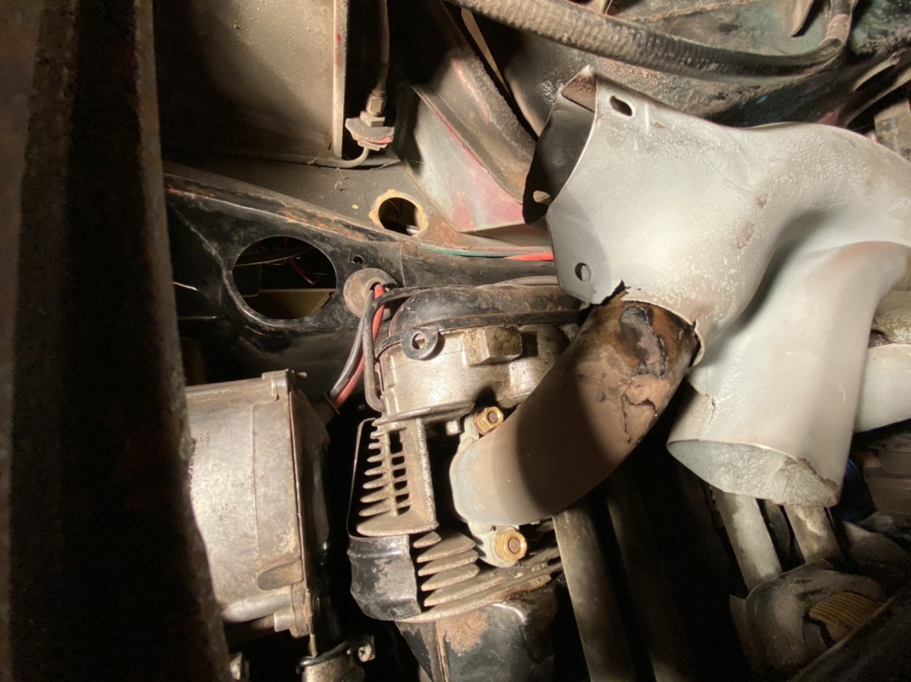

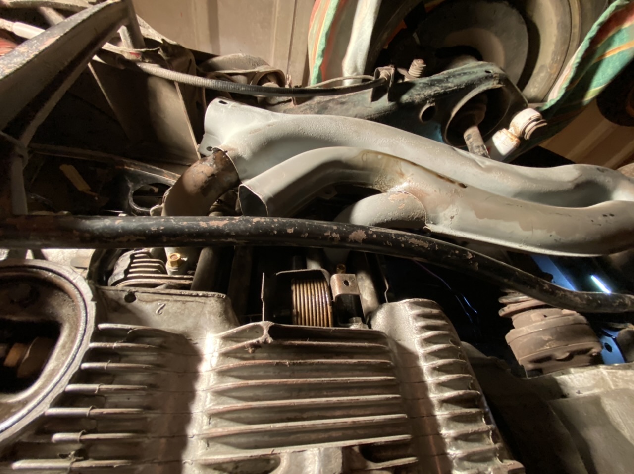

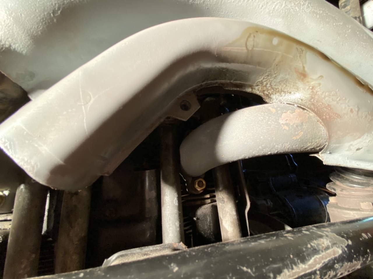

Your thoughts and pointers as to the likely source of the oil leak please
Only noticed it since starting the car at the weekend after resolving the battery screw up problem Click to view attachment Click to view attachmentClick to view attachment

Might pay to start with valve cover gaskets,then check pushrod tube seals,report how you get on beer.gif .

agree.gif with P'Tub. You should be able to get a light on the valve cover edges and the pushrod tube ends and see if you see any drips or seepage. Valve covers and pushrods are the normal suspects with oil on HE's.

Yes, both can be done with engine in. Valve cover replacement / reseal is part of normal maintenance with valve adjustment. Pushrod tube seals are a little trickier, but there are plenty of threads here about how to do it. To do the pushrod tube seals you need to remove valve cover, so plan accordingly.

yup like everyone said, left front leak valve cover gaskets or pushrod tube seals. The only other two possibilities are:
left front breather hose leaking
thermostat roller stud loose and leaking
