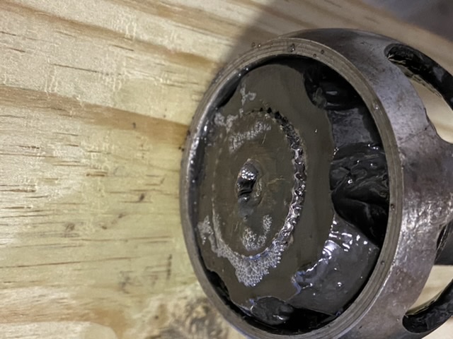

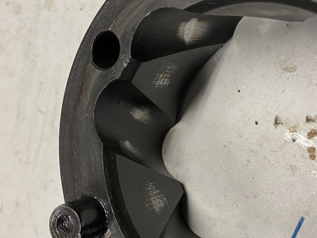

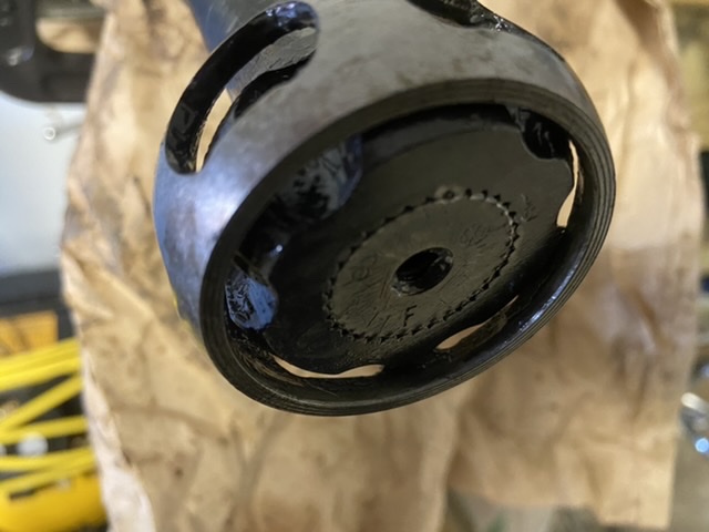

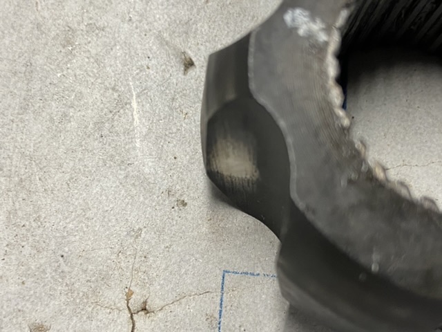

here’s some pics of the first one l got cleaned up and the stuck one
looks pretty rough but l really got these to clean up and have as spares
so no harm done really but would like to get them cleaned up
rgalla9146
make friends with or pay someone with a shop press.
The clean one pictured looks great. Reassemble, lube and use.

Replace as George suggests. Not worth your time.
Superhawk996
If you're a doc or lawyer and your time is worth $200/hr for sure just replace them as recommended. However, if your hobby time, like mine is worth the going rate of $1/hr it might make sense to just work it out. happy11.gif
You've likely got a burr where the Circlip used to be that is catching the axle splines.
Push back to original starting postion. Clean up circlip groove with triangle file to make sure you have no burs obscuring the splines where it was hanging up on the 1st try. Try to remove again.
As previously suggested, a bit of heat to expand the diameter of the spider while keeping a cool, wet rag wrapped around the axle shaft as close as you can get to the spider without the rag touching the spider. That will help ensure it comes off on the 2nd try. You will have no metalurgical changes to the spider by heating it to 200-300F which will be plenty to increase the ID of the spider by a couple of thousandths relative to the OD of the axle splines to help the two parts to slide relative to each other.
