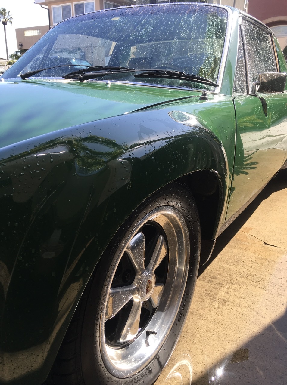

i'm running 245x40-17 on my 9" Fikse. I was able to fit 255x40x17 Kumho race tires. My Michelin Pilots have an outer curb rib that rubbed on the fender, so I had drop down to 245

Damn nice car, could you post a few more pics from different angles?

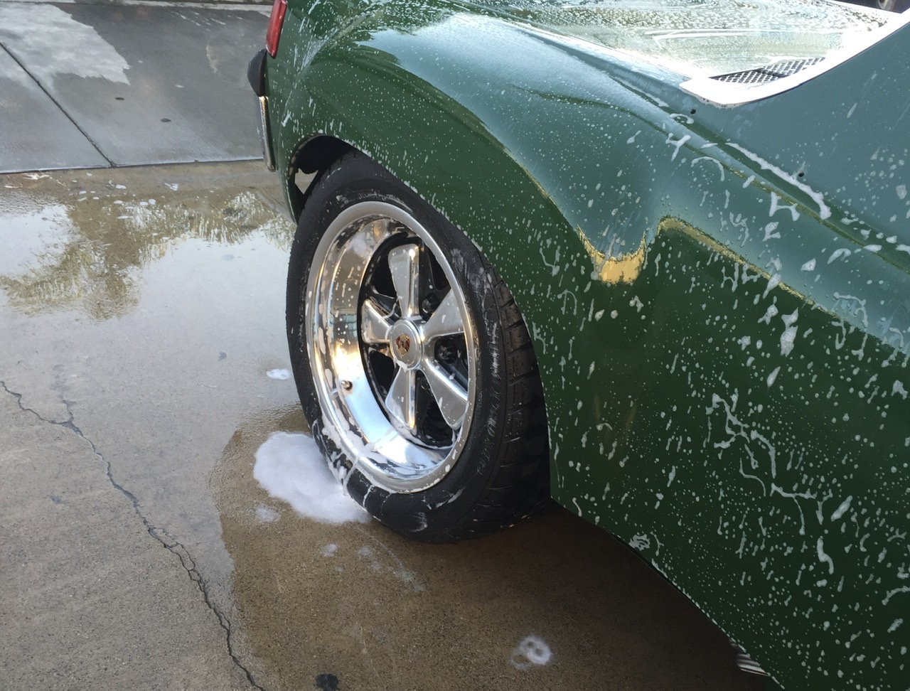

On stock Porsche Fuchs wheels I’m running tires that are.
225/50- 16 front
245/45- 16 rear
I’ve got tons of room on the front Porsche factory steel flare, like 2-1/2 inches..!
