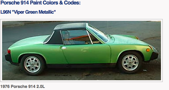

Pic for Attention-

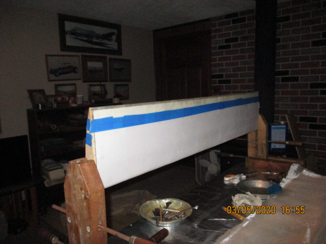

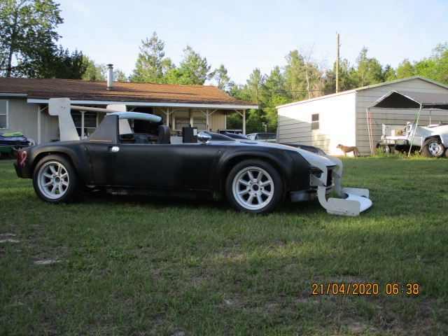

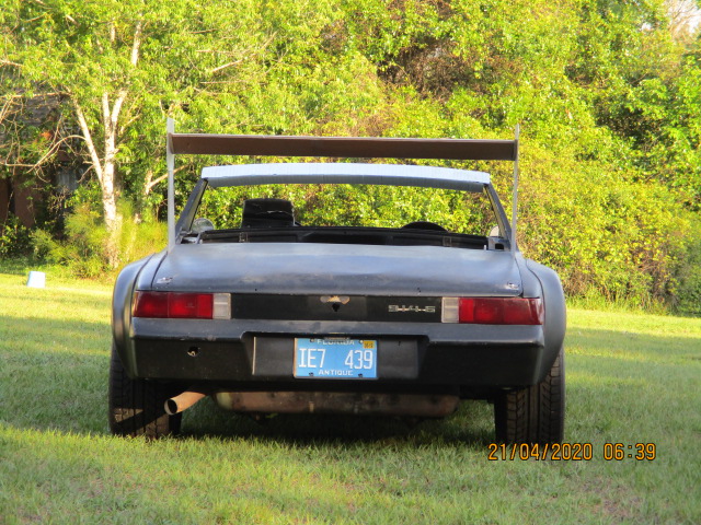

914 Ranch
I'm not finished building it yet. The build thread is in The Paddock under AR-14. All the stuff you dream of and front and rear wings.
Registered and insured in '18, all the lights work even the license plate light which you can see the the pic.

FWIW - the pic I posted isn't my Car - but ratehr an example I found and saved when I was researching Porsche Viper Green colors/images.
Looks like some really good suggestions - keep 'em coming guys.

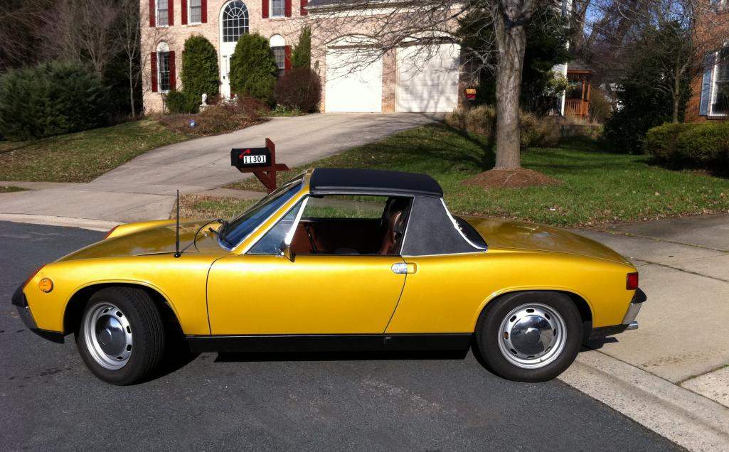

Chris914n6
I've already got a rolling chassis so...
• strip & repaint factory Metallic Gold
• stock 2.0L FI (have)
• drilled 5 lug to use 15x7 Cookie Cutters (have), sticky summer tires
• rolled fenders in rear
• stock trans (have) -- no benefit to the 915
• A/C system of my design
• sway bars
• black or painted trim -- chrome is just too much bling for the color
• new interior & weatherstrip
On the 75 I've owned since 91, I've swapped everything but the paint lol-2.gif

QUOTE(Chris914n6 @ May 3 2020, 04:30 PM) *
• sway bars
(not mine)
That’s my car! Credit goes to its prior owner wndsrfr !

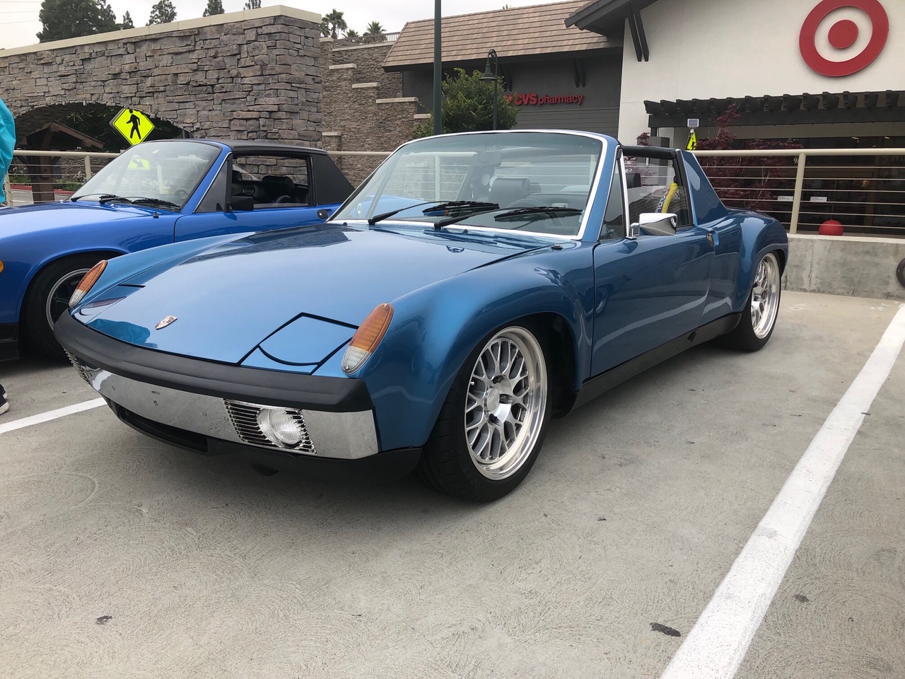

I’m happy with my build. I wouldn’t change a thing except for maybe ITB or a 3.6
Check out my blog in my signature for build specs.
