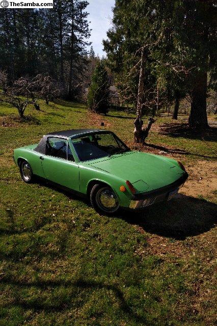

I have a 71 with the stock 8 slot steel wheel and hub cap, I am running 185/65/15 tires now but would like a chunkier tire. Can I go up to a 205/55 or 205/60 or something similar? Thank you.Click to view attachment

It depends on the car. The problem seems to alway be the rear. Have one mounted and check it on each corner.
Mine were off about 5/8" After working on my fenders over a weekend I was able to the clearance about the same on both side. I rolled the lip some on the rear to be safe and in the end went with a 195. This was all before I painted, I think I could have done it painted but I would have been sweating bullets.

You didn't mention the width of the stock steel wheels, either 4.5 or 5.5 makes a huge difference in tire selection. I'm running 205x65x15 on my 5.5 rims, giving very close to original tire diameter.

With a 5" wheel (which you probably have), a 195mm section width would be pushing it. 165-175 is ideal. 185 is the max recommended.
Tire width vs wheel width
A 195 70 15 is spot on to the diameter of the original tire (165 82 15). A 185 70 15 is about 1/2" less in diameter (2%). Your speedometer would still be pretty accurate. Any lower profile and you can forget about using your speedometer, you'll be racking up more miles than actual, and (IMHO) the car will look goofy with all that space in the wheel well.

Thank you everyone - this helps. I will pull a wheel and check the width but may try a 205/55 or 60. We live in the foothills between Sacramento and Tahoe so a lot of fun roads - nothing crazy, just lightly spirited.
