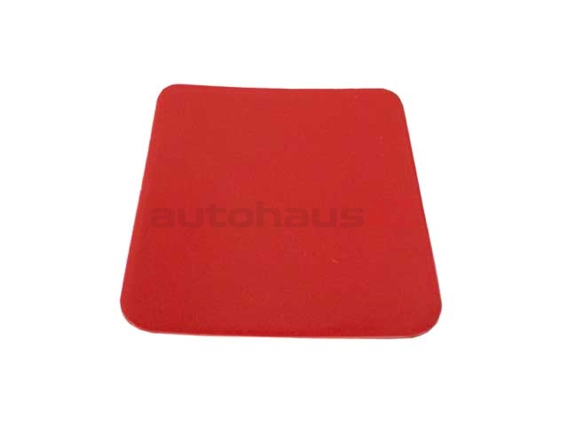

raynekat
I agree with those folks saying to use the correct pad.
They are easy to install, hold like stink and can be removed easily if needed (think piano wire or guitar string).
I would never try to GLUE the mirror to the window.
Just get something like this:
https://www.autohausaz.com/pn/12605265-OE-9...AyABEgKXkPD_BwE
And be done with it.
