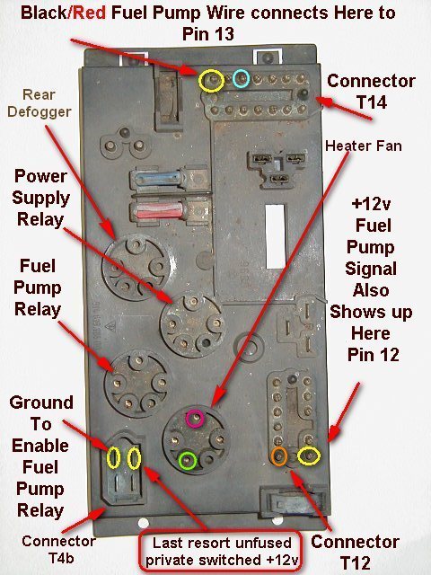

If the Relay is clicking then the issue is most likely somewhere between the relay itself and the pump (bad relay board connection, wiring, or pump itself)
Wiring from the relay board to the pump come off of the forward most (T14) connector on the relay board, (pin 13, most forward left pin if facing the front of the car) wire in the harness should be black w red stripe, this runs directly to the fuel pump.
The relay itself is controlled by a ground path enabled via the D-jet ECU (most forward left pin on the 4 pin connector to the d-jet harness) To test the pump you can jumper across the fuel pump relay itself, to test the relay you can ground out the activation pin where the d-jet harness plugs in. If grounding from the 4 pin connector activates the pump relay but cycling the ignition key does not, you have a bad ECU or FI harness.

This might help

That relay board often fails also, so some circuit checking is necessary.
