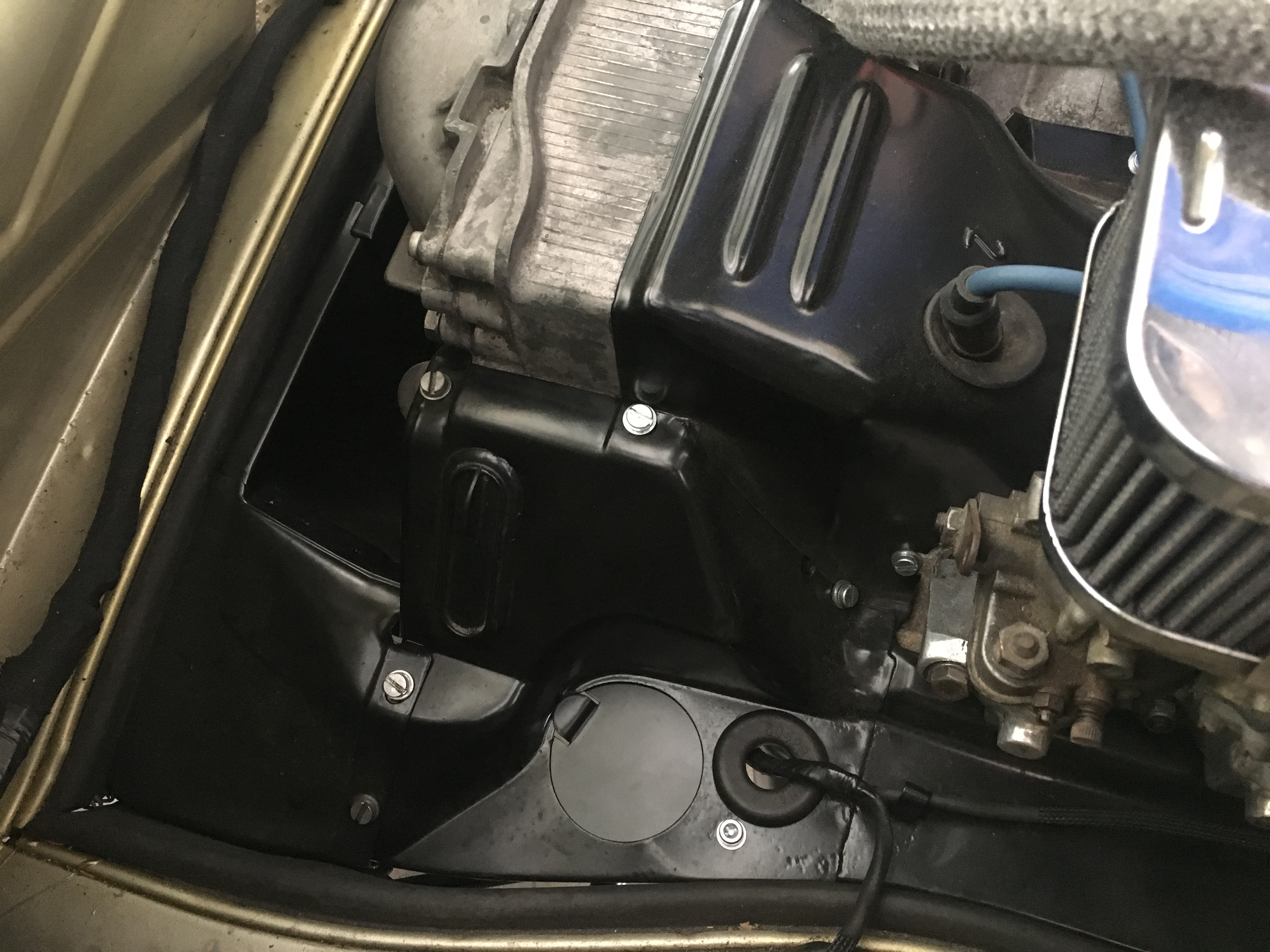

I just installed BDStone914’s heater block off plates.
For us that have headers and no heat, what to do with the big round holes through the engine tin?
Bruce solves it. Nice cut, painted, exact fit with hardware. beer3.gif Way to go Bruce!!

Hope he's still making these- I could use 2 sets.

Pretty sure he is still making those. I just them from him.
76-914

Those are great.. Maybe an option for my 6 sheet metal

I agree. That way you make one style. If someone wanted to add heat later they could remove the plates. Are there and lips near the holes in the 6 sheet metal? The RD sheet metal does.

Thank you. BTW you have the wrong grommet for the alternator harness. Note the big gap. I think 914 Rubber sells them. Or cut a short section of hose to fill the gap.
