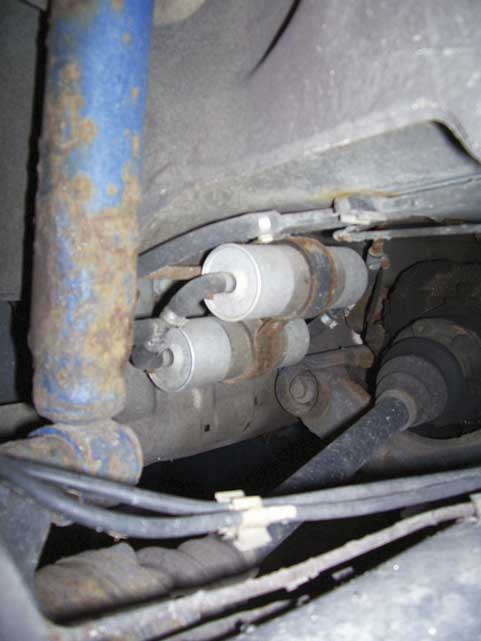

I wanted to give a shout out to Tangerine racing. Recently I have been working on getting our 95 BMW 540i back up and running. During the process, I replaced the fuel lines because the were all rotted from sitting for years (long story as to why). But the fuel filters were causing fits. The 540i uses two filters in parallel with t fittings and elbows to connect them up.
I tried making up the elbows out of plain EFI line, but they kept kinking. Then I thought of Tangerine Racing's 914 injector elbows. They are the same size as the fuel filter elbows on the BMW, and they are already bent.
So I ordered them. Chris shipped them out really fast. Kudos for the great service and great price.
And they are a perfect fit.
