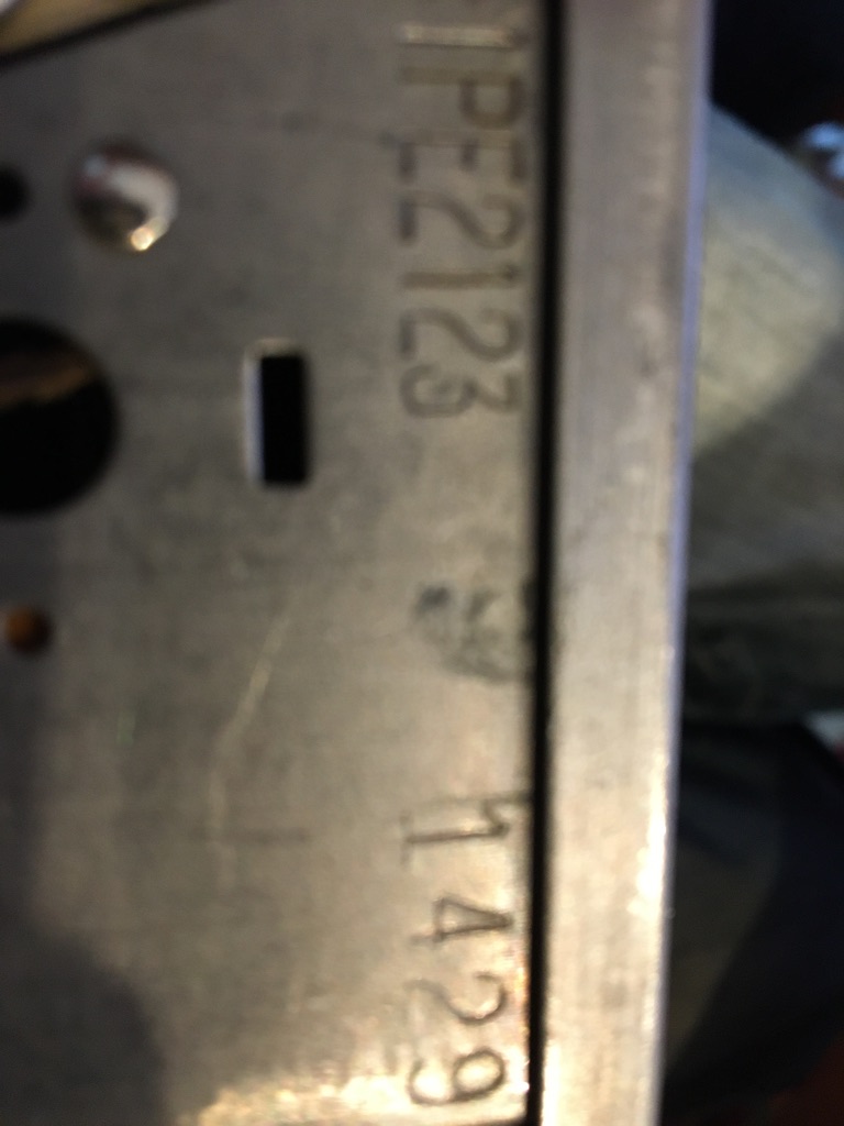

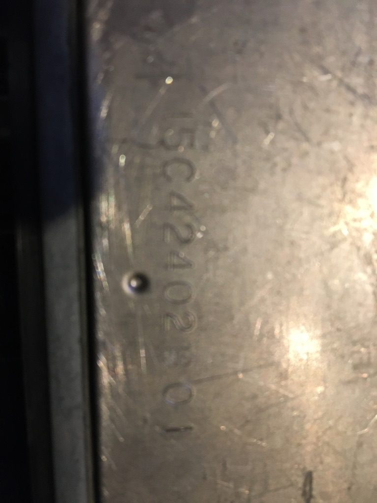

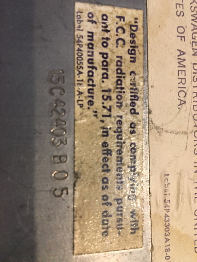

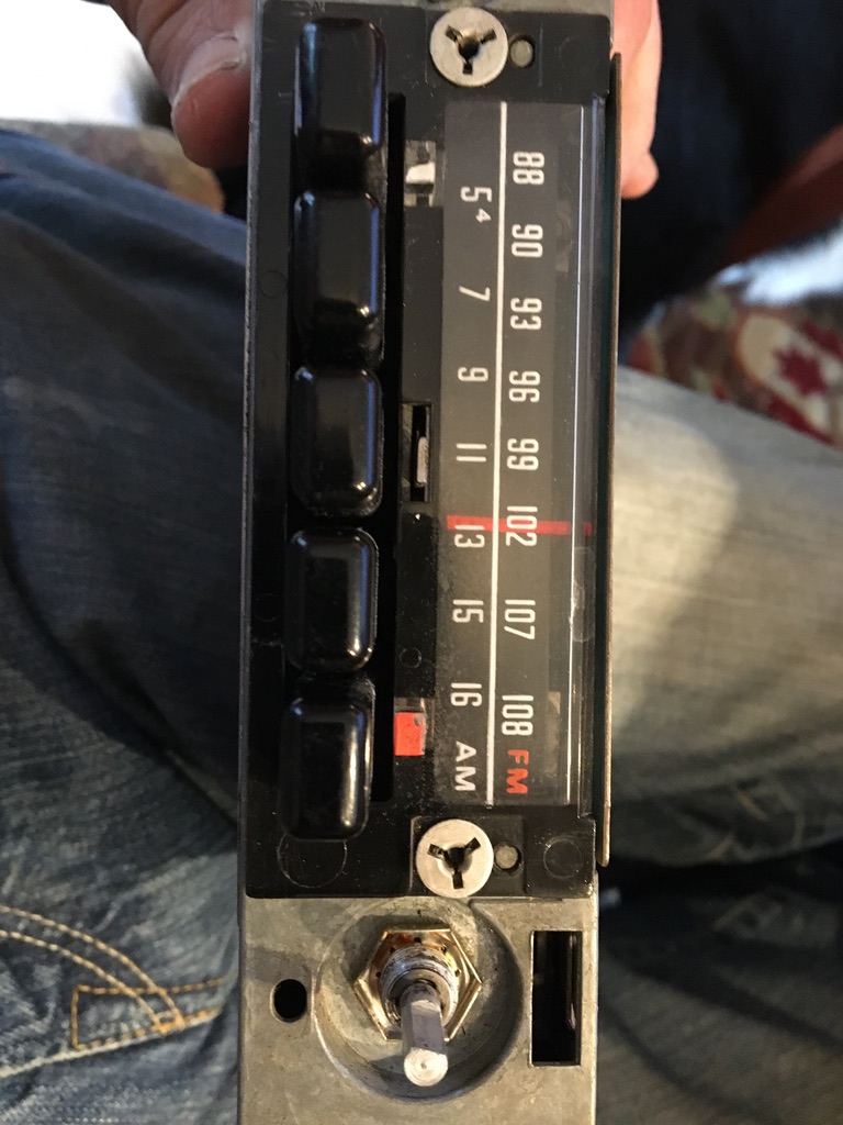

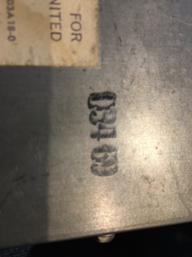

When I received my '72 914, the radio was not connected and previous owner indicated they hadn't tried to hook it up. I pulled the radio and sent it in to check out. I was told it was a Blaupunkt “Emden” model and that it worked fine. Here is pic of the radio with some codes which I have NOT been able to identify. At this point, I'm trying to figure out how to properly reconnect this. I was told the brown wire was for speakers, the blue wire was for "illumination", and should connect to dash lights, and the black wire was the power feed. The antennae feed connection is in the rear. I'm a little hesitant about properly wiring this. For one thing, I assume I need to attach a ground from the back of the radio to the chassis? Any advice on this would be greatly appreciated, either in confirming the model or advice on reconnection? Thank you.
914Sixer
Hate to be the bearer of bad news. It is a mono AM FM Motorola.
porschetub
Not sure if that is a Blaupunkt,the rear wiring isn't how Blaupunkt do it,looks like a dealer supplied Motorola.
Baumgardner
QUOTE(914Sixer @ Aug 7 2020, 06:04 PM) *
Interesting... (the repair guy told me that) but no big deal. I suspect that would be considered more valuable, but just having the Motorola working would be a big plus for me. The repair guy did send me a video with it playing, so I know it works if I can figure the wiring out.

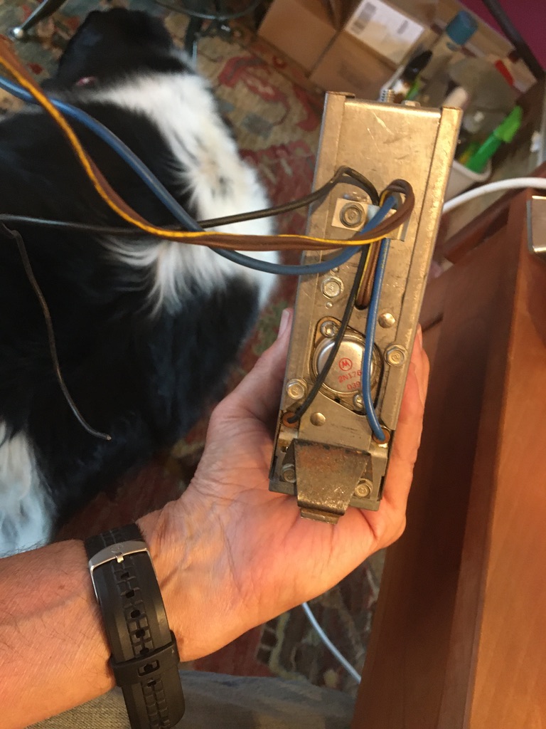

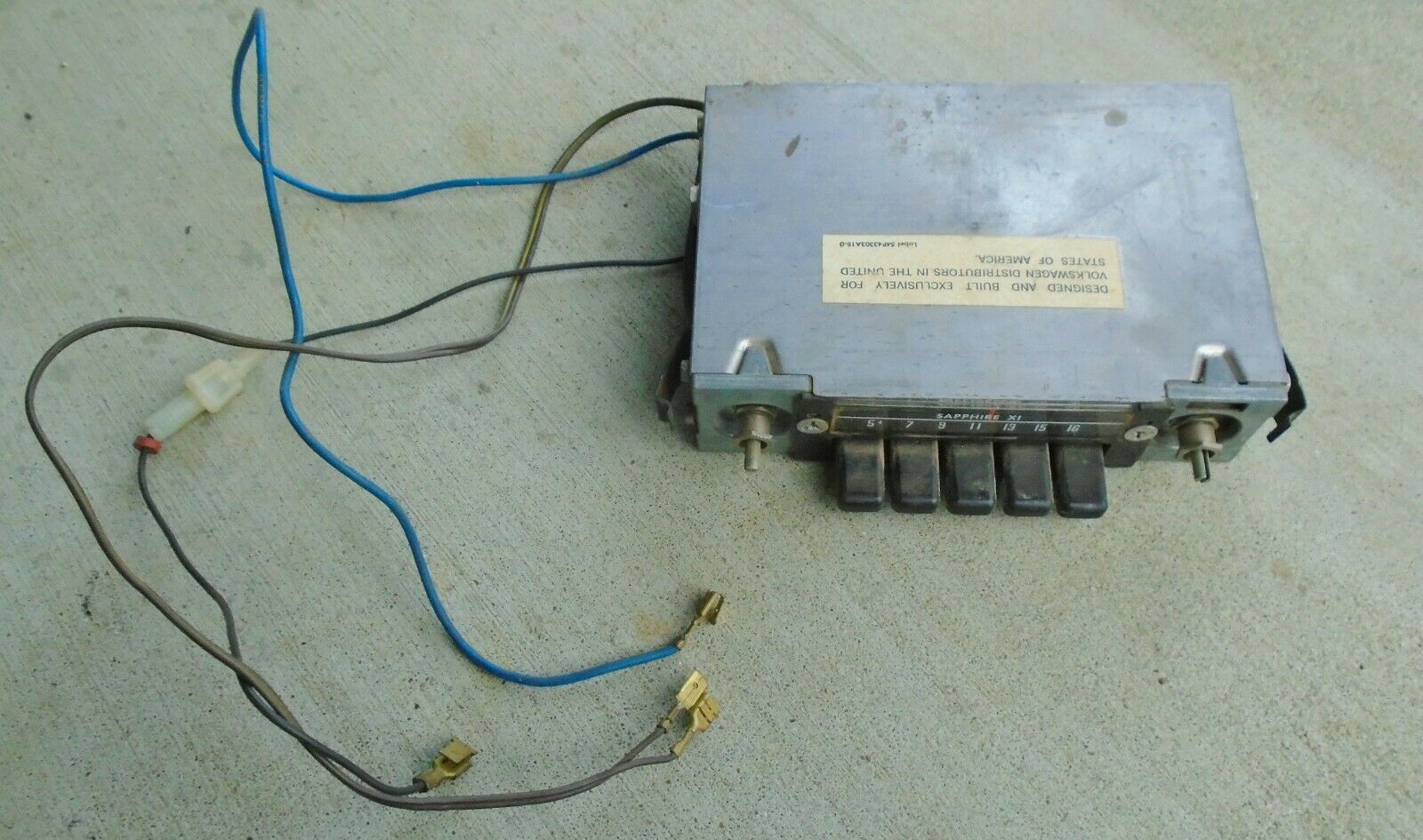

You can email matthiasklassen@aol.com, who owns Oldtimer-radio in Germany... outside of a person in London, I trust Matthias to fix these old radios.
Looking at the wiring, Black (ground), Blue (power), Brown (speaker)

I agree with the wiring. Matthias only repairs blaupunkt. We have a full line of his rebuilt radios on the shelf for all years and models of the 914 as well as owners manuals, instructions wiring installation pieces and ipod adaptors

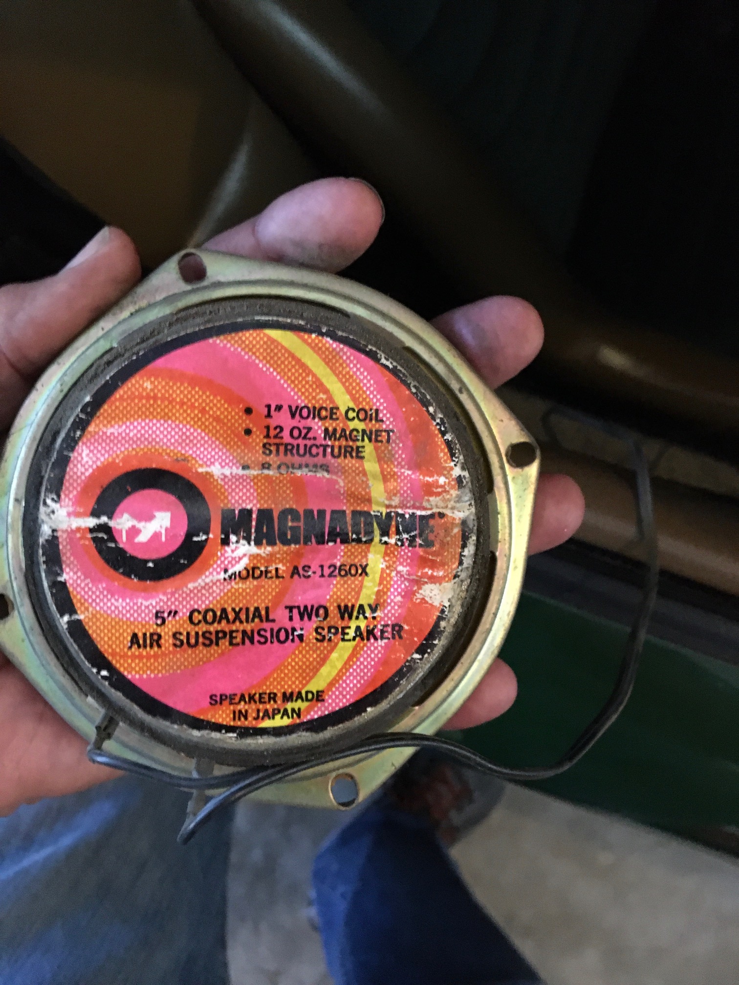

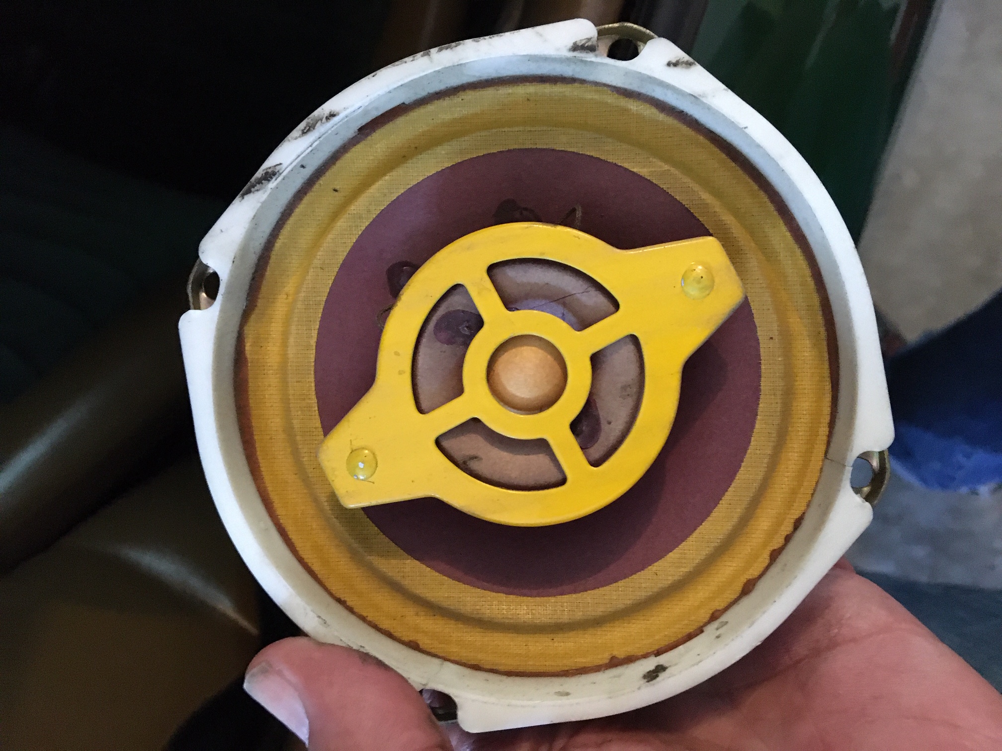

Actually, the Motorola is fine. I don't think these speakers are though as the don't really fit correctly. Do you have any speakers correct for an early model year '72? Or any manuals, instructions, etc. that would be of use to me with this Motorola radio? Thanks!

I have to look, but think we have an NOS set of Motorola speakers somewhere. Do you want stock or IIRC there are some new speakers out that will fit well.
NOS Motorola would be great... Thanks, let me know.

smile.gif I checked and we have a set of NOS Blau, but not Motorola. I must have out them in our 75 Palma car. Sorry.

Thanks so much. I assume the NOS Blau would fit fine on a '72? Would you be able to sell them to me? I think they would work fine. If you want to use regular email, mine is Baumgardner.Mike@gmail.com. Thanks again for getting back to me.

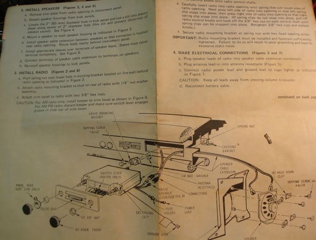

This should help with wiring. This is installation instruction for Motorola Sapphire.
Baumgardner
QUOTE(Mike Fitton @ Aug 9 2020, 09:33 PM) *
Thanks Mike. I really appreciate it. After continued research, it appears the Sapphire is very close if not identical to my unlabeled Motorola.

Baumgardner
QUOTE(dr914@autoatlanta.com @ Aug 8 2020, 11:07 AM) *
Just to make note on this thread, I believe that it is actually black = power, blue = ground, brown = speakers. This is based on looking at a number of Motorola sapphires that have these colors. Here is example:
Noting that the black wire has the inline fuse, I assume it must be the power...
