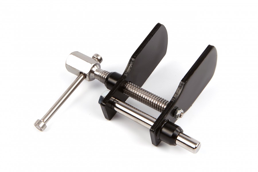

I use a tool like this after the caliper is off

Scissor style:
https://www.amazon.com/Laser-5252-Disc-Brak...r/dp/B006IRIP9M
Ratchet style
https://www.amazon.com/caliper-TUTOOLS-pist...tive&sr=1-3
I used to have a pair of the scissor style and they worked well. Somewhere in life, they got lost. I'll have to replace them when I put my car back together as they were much easier than C-clamps in my opinion.
Can't vouch for the ratchet style but work probably work too.

In have this one. Works well. Cheap tool, and since I do not use it daily, the quality is good enough.

Thanks for the advice and the link! I just ordered a pair of the scissor style....those look like just the ticket.
Craigers17

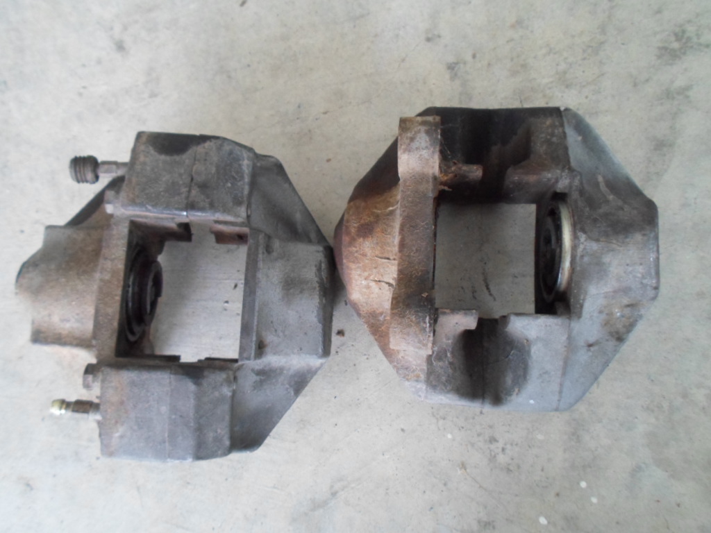

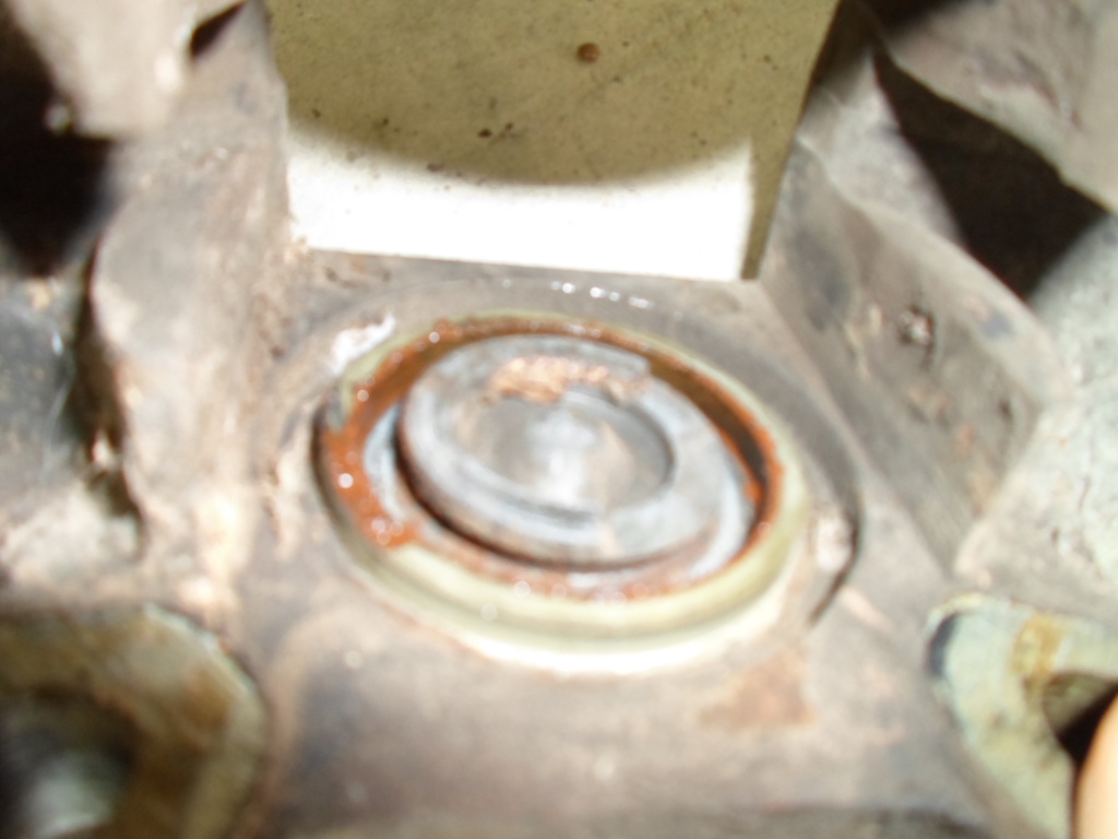

Just to add a quick update to this thread. I purchased a scissor style spreader, and it worked well. Unfortunately, the brakes are not functioning well, ...one of the pistons is completely seized and another is close.
....So....I took them off and am sending them to PMB today for a rebuild. Click to view attachment Click to view attachment

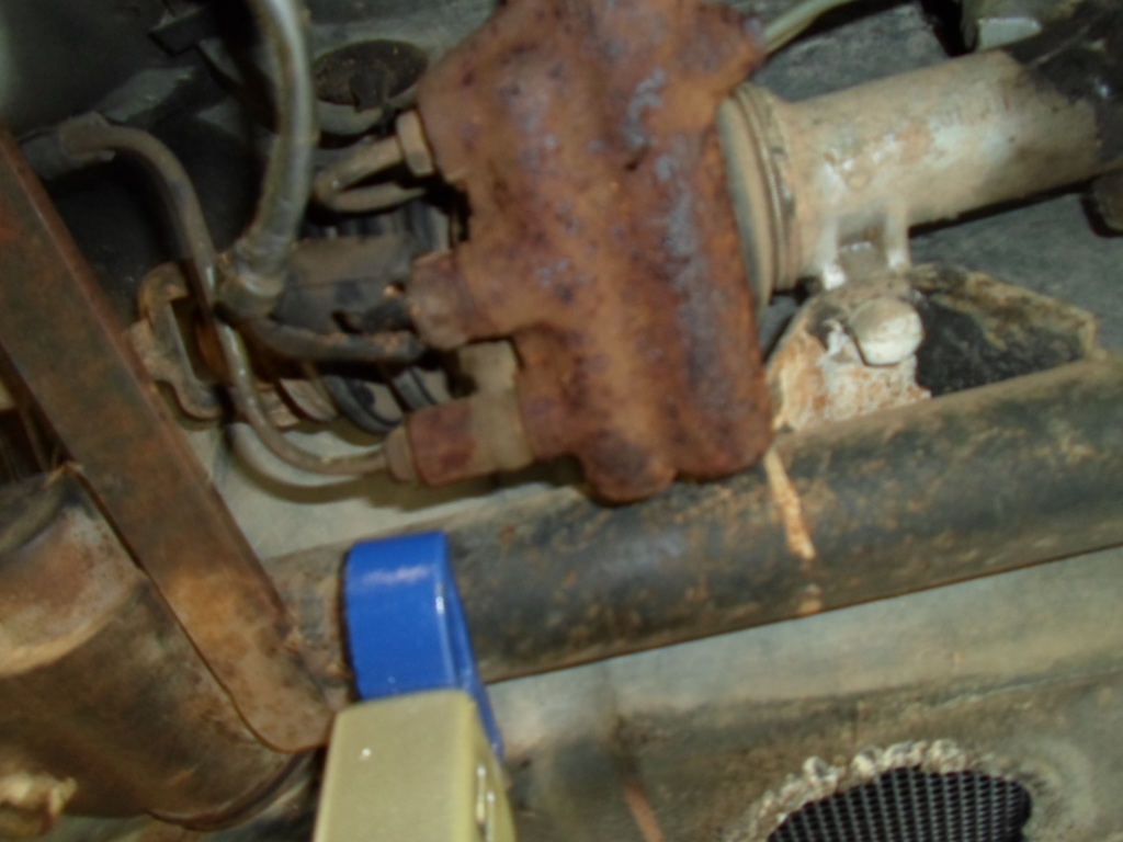

I'm also going to replace all the lines and master cylinder. I took off the steering rack cover and found that the 45 year old master cylinder probably isn't helping things.
....which begs the question ....why not replace the pedal cluster while your taking out the master cylinder...... frigg'n slippery slope....
