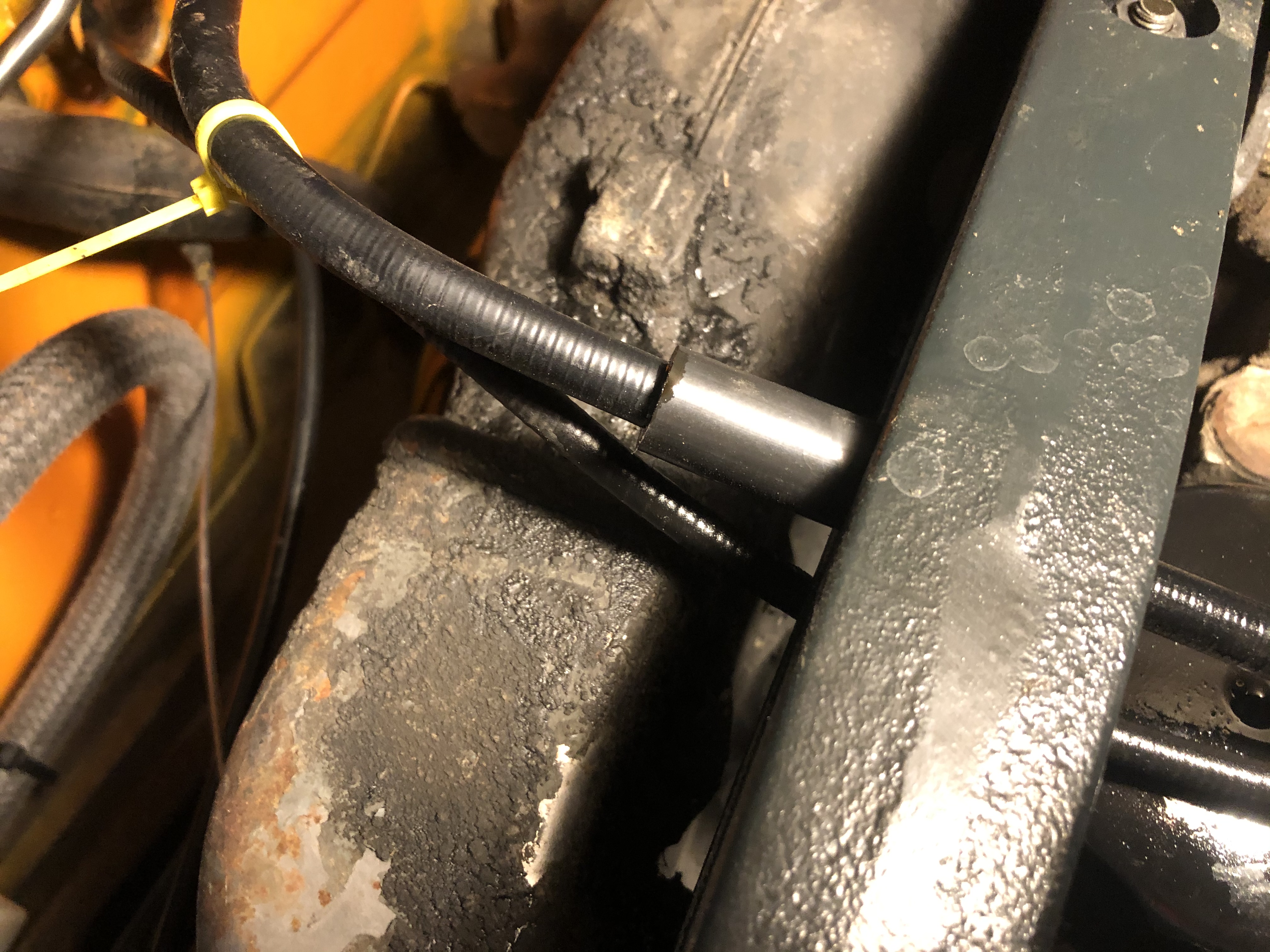

The only thing that comes to mind is how the cable itself is run. On the old and new cable, for that matter they have on the outer housing an extra piece of rubber sheath about three inches long that envelopes the cable housing. The old one slides up and down the length while the new one does not move. I assume it is used as extra protection where it runs through the engine support mount. My question, since the new one does not move and does not fit through the engine mount support hole, would it have an effect if it were up against the front of the engine mount instead? I have a picture attached which shows that is how mine currently sits. The extra rubber piece shown is between the engine support and the fire wall side of the engine support. Is this my issue?Click to view attachment
