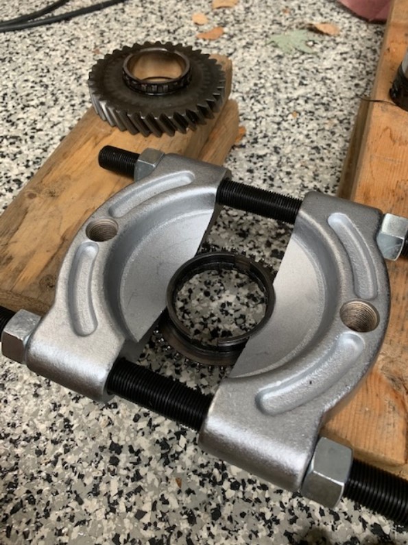

'74 2.0 901 side shift
I had it in a jig, hit it for a few minutes, no luck - then put it in a press until the jig broke.
Took it to a machine shop - he brought it to 6000 lbs before his jig broke. Told me to cut it off or heat and more pressure.
I thought I would come here for guidance.......perhaps a vintage Porsche mechanic in the NE area?
Help!
ctc911ctc
Success - I could not get a new P225 tool. Every supplier is sold out. Or could I get a used one at a price I thought was appropriate (for me) so I used a bearing splitter......a really big one.
You perhaps remember the last post where the machine shop put a couple of Buicks on top of the gear and it did not budge. Well, I put it in the bearing splitter and then whacked it with a large hammer a few times. Success!
