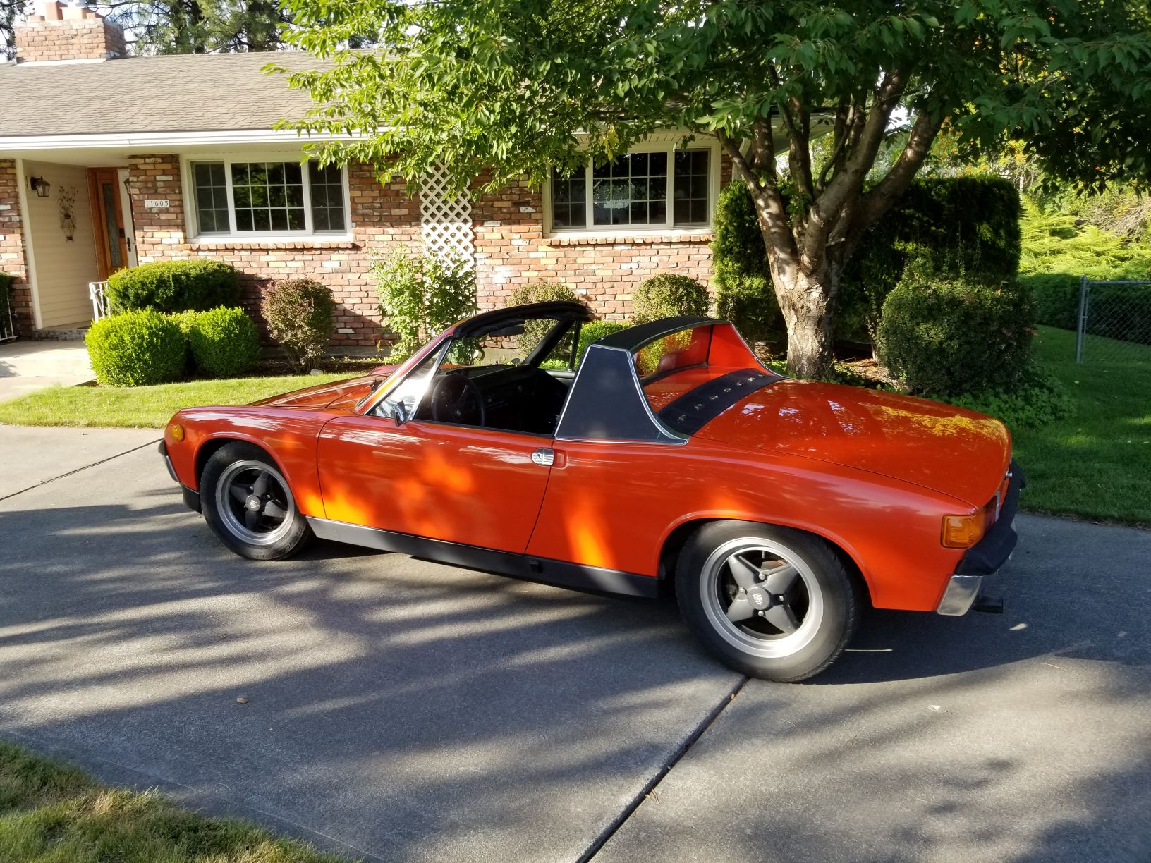

I'm picking up a sweet little 1970 build 914 today. When I drove it yesterday I could barely find the gears. The car is very original and I'll keep it that way. I've been up too long tonight perusing threads related to shifter bushing replacements and I'm a bit confused between tail shifter parts and side shifter parts.

nice ride ! do not forget new conescrews, one time use only !
