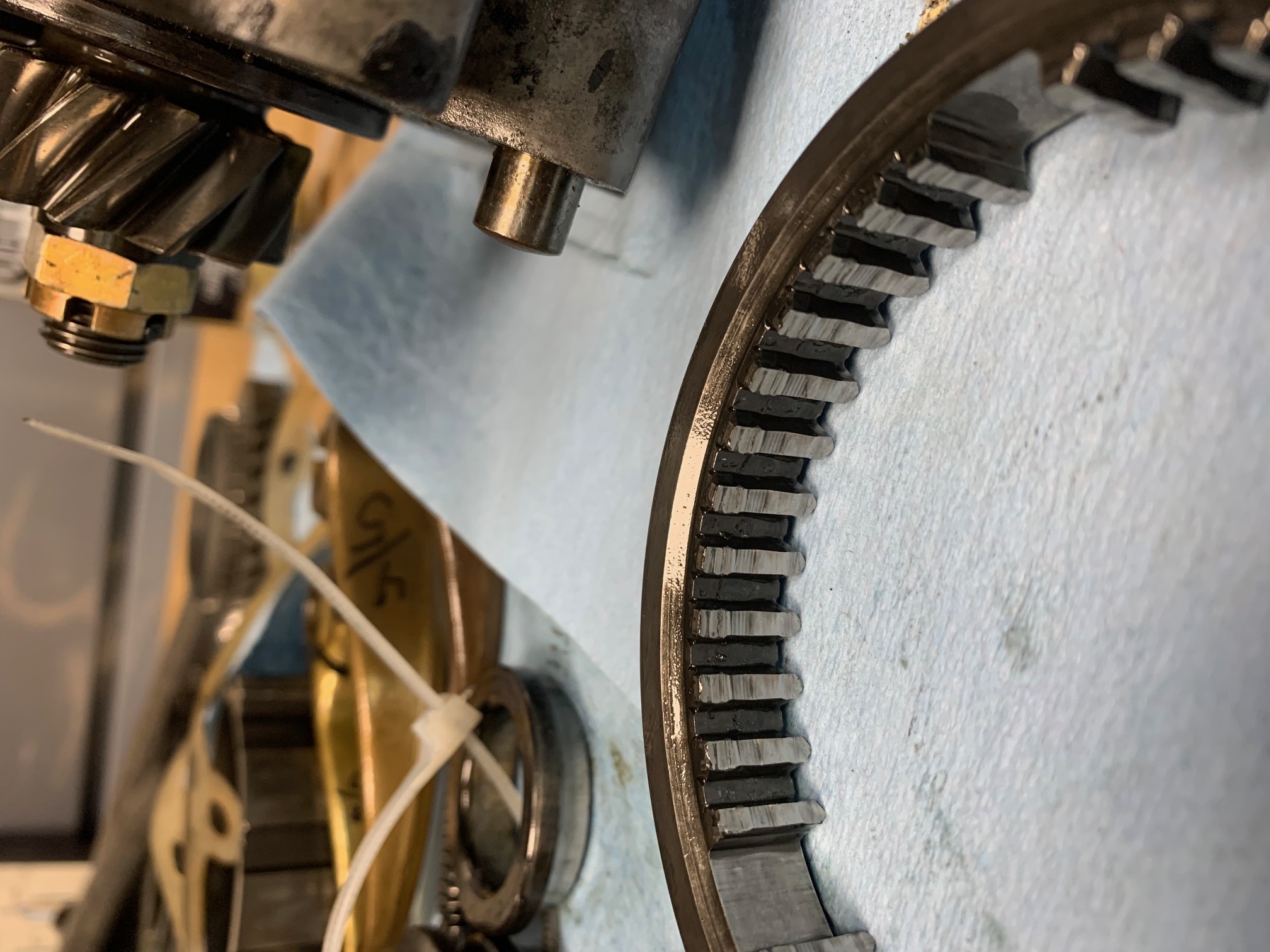

So, I break down all of the gears, replace dog teeth on 1st and 2nd. Last thing to do is to swap the selector. I removed the selector from the 4th/5th position and this is what I found.
The side that faced 5th gear has NO teeth. They are not worn off, they are evenly flat all of the way around! blink.gif confused24.gif
The tranny had very mild amounts of metal in the oil, i put a magnet in the oil after it was drained to check. Pretty sure they were not ground down! Fifth gear worked great - never ground or had trouble.
The fifth side is FLAT, (above) not a point nor ANY wear where the points should be.

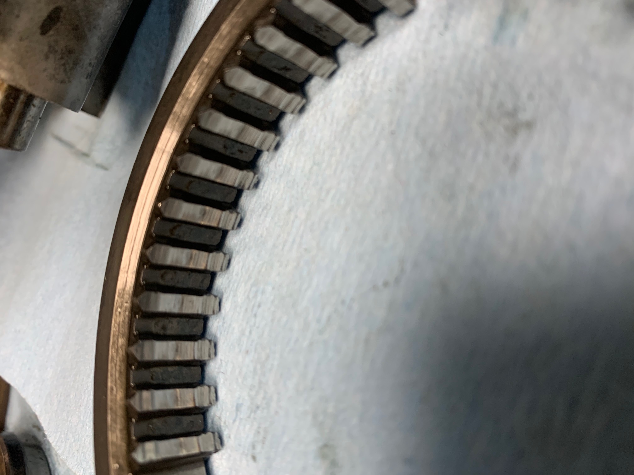

The fourth side is perfect (Below). Sharp even teeth with very little wear.
Has anyone seen this before? Guess I will need to either buy a 2/3 selector or flip it and hope for the best.......sigh.......
