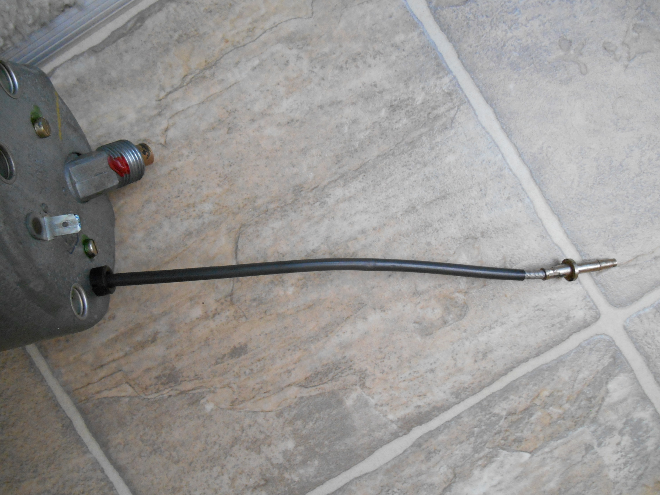

you will also need to free the odometer reset cable

That is the trip meter re-set cable for resetting the trip meter to zero. It goes into a hole in the bottom of the dashboard. It’s missing the re-set knob, washer and retaining nut.
brcacti
Aug 22 2020, 11:29 AM
Oh oops, YES I think I know exactly where it goes now, will go out and check. THANK YOU for that bit of information.

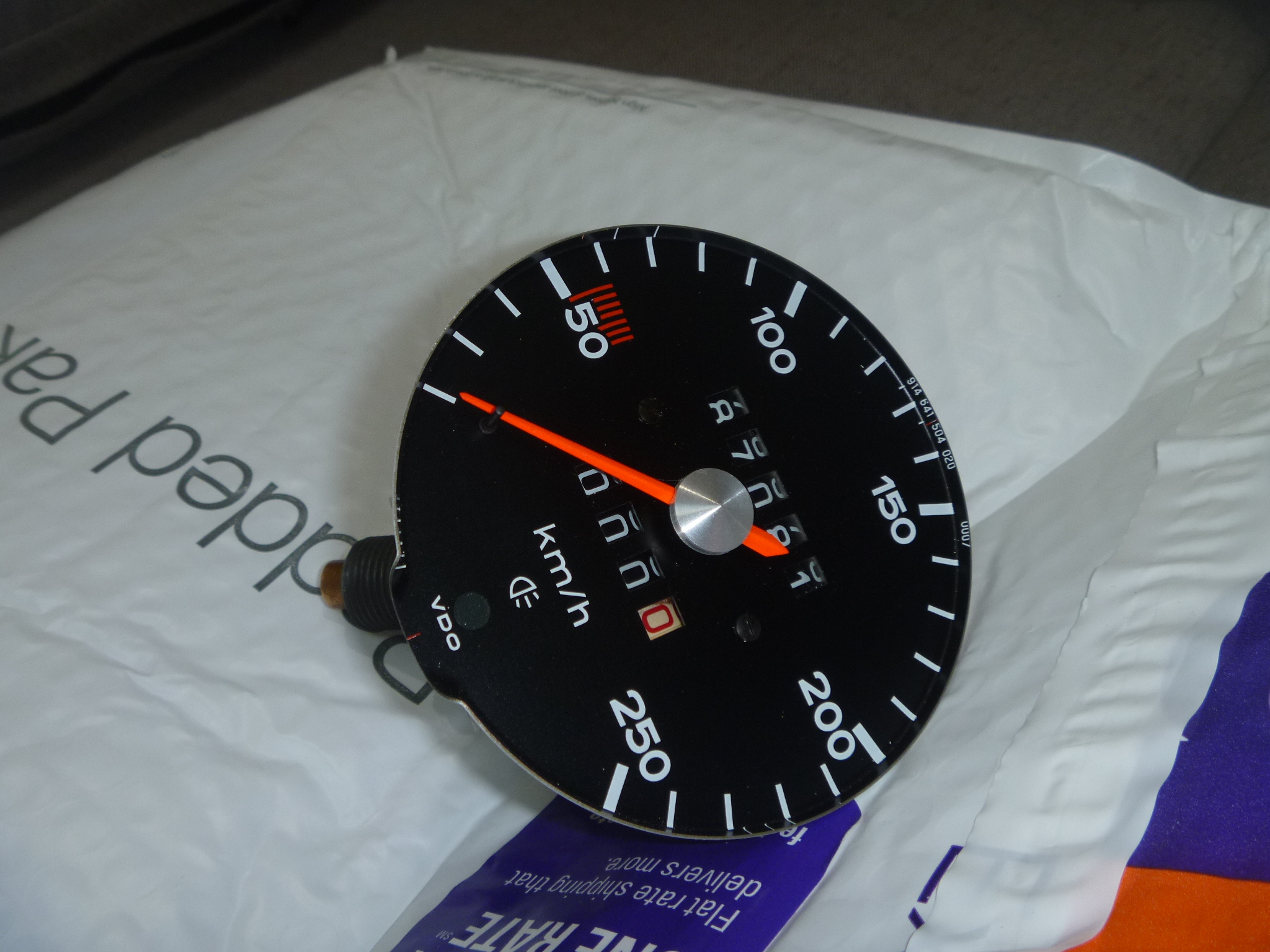

I reclocked my metric speedo to correct mileage and yes it is tricky but having done several mk2 Golf ones its made it easier,another VDO gauge that fails in the drive,funny never had to repair or had failure with the Motometer ones often used in those cars ?.
Click to view attachmentBeing the "king of bezel" removal that's not an issue,I do however have the worst luck with tacho's as after doing full cosmetics on them and LED's they seem to fail shortly ofter
I still think Bob is better to buy a good used one and decides if he gets it reclocked to his car our just runs with a good used example with mileage close enough.
