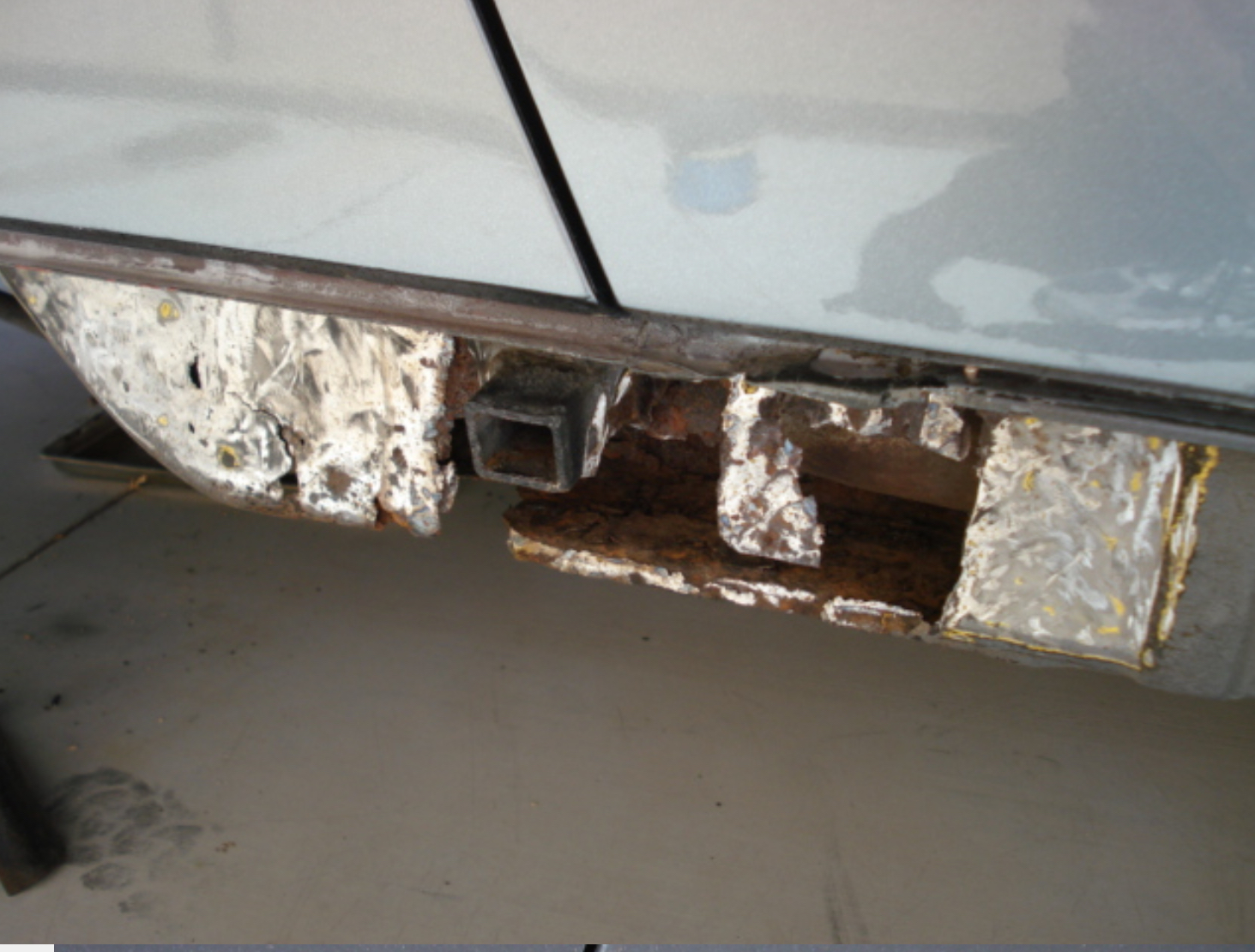

Not my car, similar to one of my cars, but common enough it seems worth a chat.
Outer metal for alignment and appearance and then close it up?
cary
That shot just scratches the surface.
How far up the outer wheelhouse does the degradation go ?
Need to see the bottom too.
QUOTE(cary @ Aug 22 2020, 08:29 PM) *
Exactly what I was thinking. Tip of the iceberg.
agree.gif Keep digging.
larryM
on positive note: the jack point is still there the door line looks straight - how about you put a jack in it & lift & tell us what happens?

Hi guys - thanks for the fast responses.
This isn’t my car so don’t have access to more pictures (it is for sale here but just grabbed the picture as indicative).
Can we imagine that it is “only” the are in red for a moment?
Thanks!
Montreal914
Leaves and dirt accumulates there between the rocker and jack point. Typical issue. You need to dig further. Where did the car spend its life, dry west or east coast?

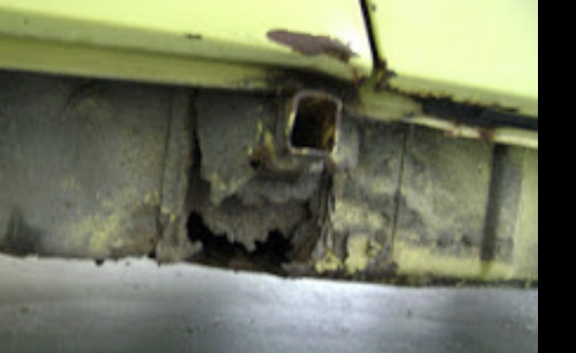

First pictures not my car - I though it would be similar enough of a pattern that it would be indicative but apparently it is quite individual to the car still.
Here is an old picture of my actual car prior to DPO repair.
QUOTE(Tdskip @ Aug 22 2020, 05:20 PM) *
How would you repair this long rust?
Cut out *all* rust and replace missing metal with new panels from RD ...

Is there a correct order to this repair?
Outside/visible and then underside?
QUOTE(Tdskip @ Aug 22 2020, 06:41 PM) *
Thanks @sirAndy .
How are you doing with the fires? Air quality has been pretty bad I know.
So far, we've been lucky, there are two major fires close-by but each of them is still about 25 miles away.
As for the air quality, the winds are shifting during the day (typical for this time of year), when we get a breeze from the ocean the air is ok, when it shifts around, we get heavy smoke and keep all windows closed.
For your welding pleasure, this thread should answer your questions:
http://www.914world.com/bbs2/index.php?showtopic=16748
