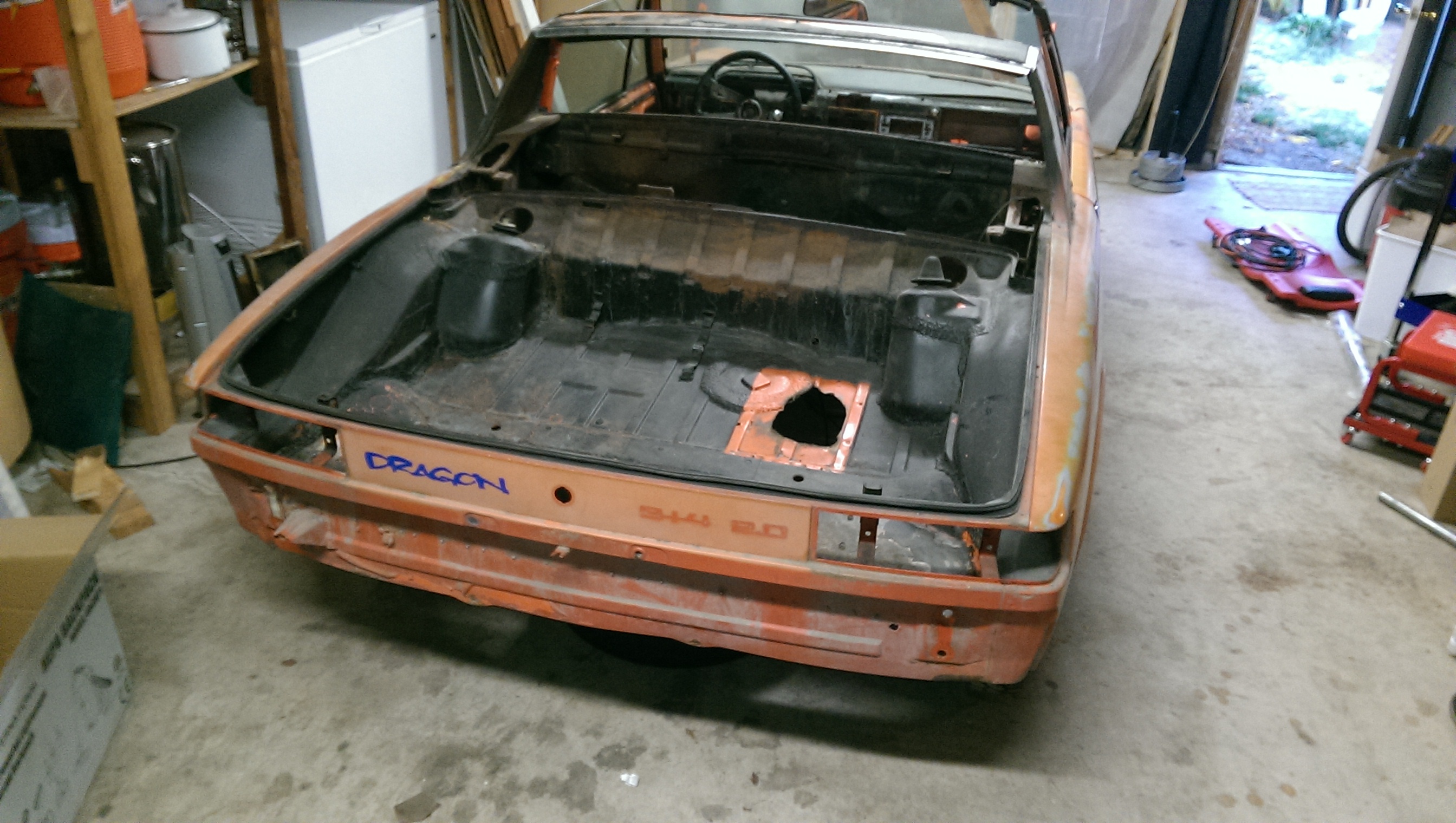

This is the beginning of a rest-o-mod of a 1974 914-4.
I acquired it as a roller a couple years ago and have been slowly stripping it down as time, funds, and energy allow. I've been posting random questions here on 914 world and figured it was a good time to put down roots.
Overall I'm looking to turn it into a reliable cruiser.
Fun fact: The rear of the car has "Dragon" painted on it. Kind of funny since an engine fire took the car out of commission for some previous owner.

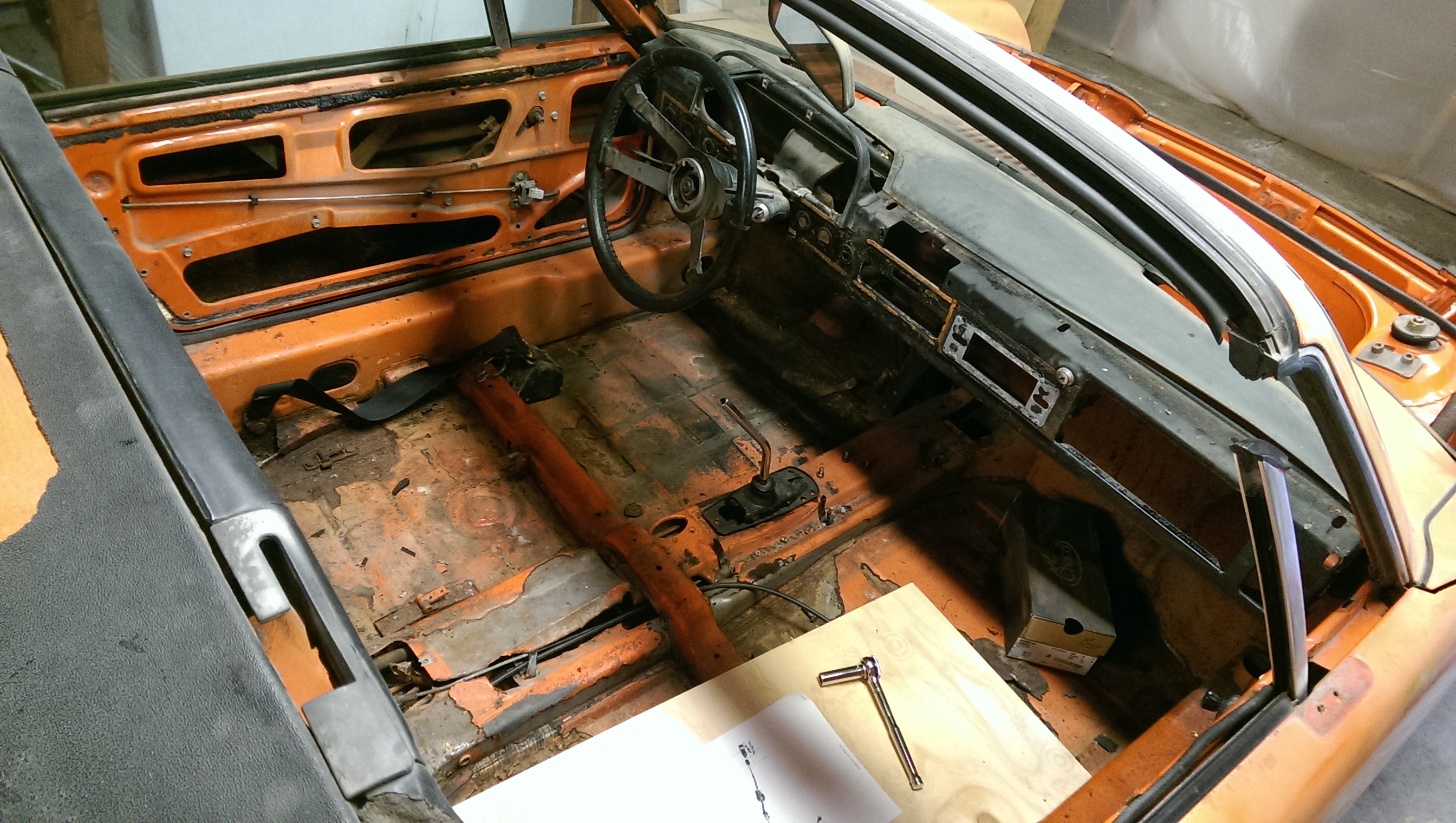

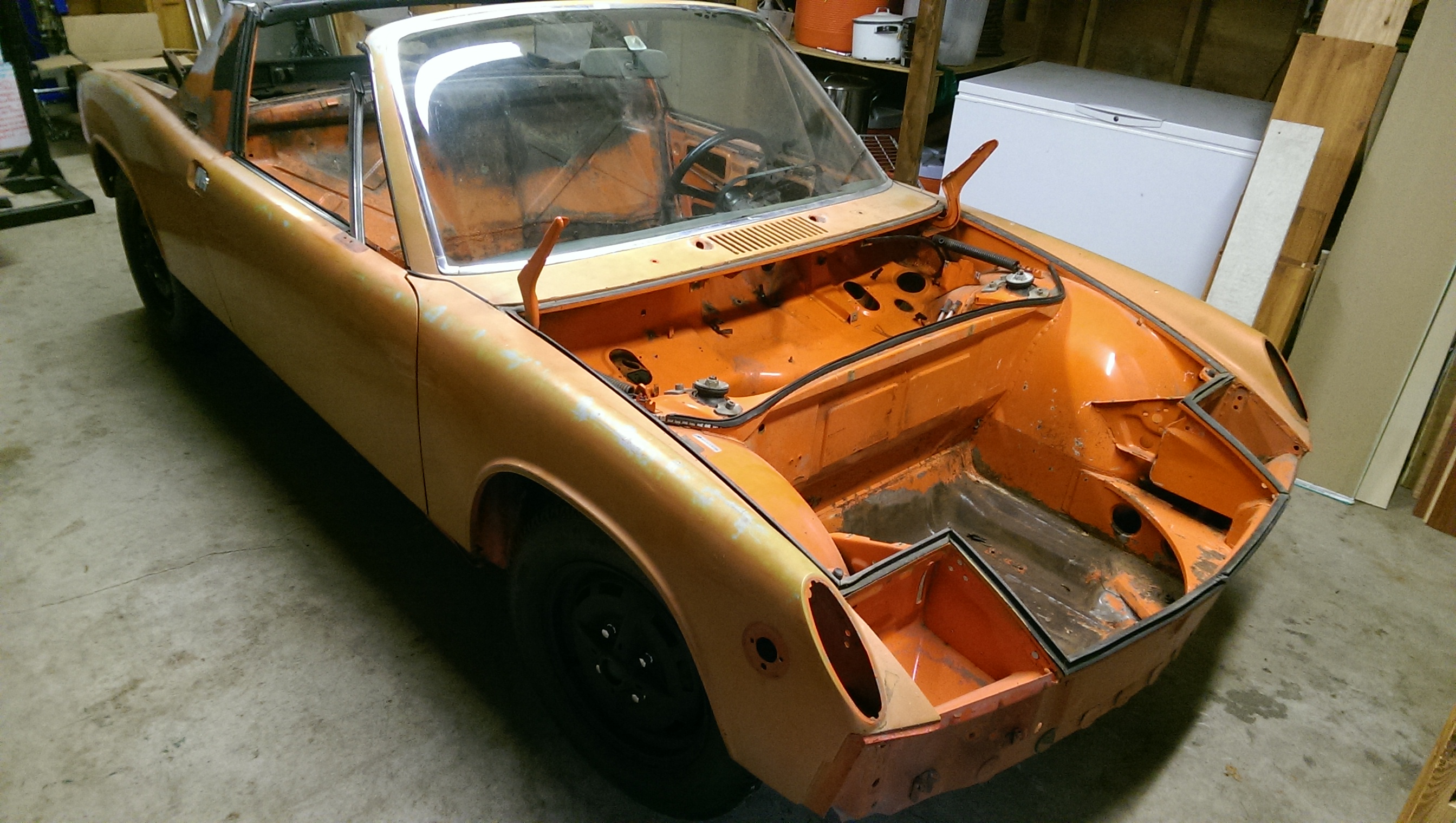

Pictures!
I'm starting to run out of stuff to remove.

Ha! I see plenty of stuff to remove. You just have to lose control of yourself, and before you know it, you will have a bare body shell, and lots of boxes of parts.

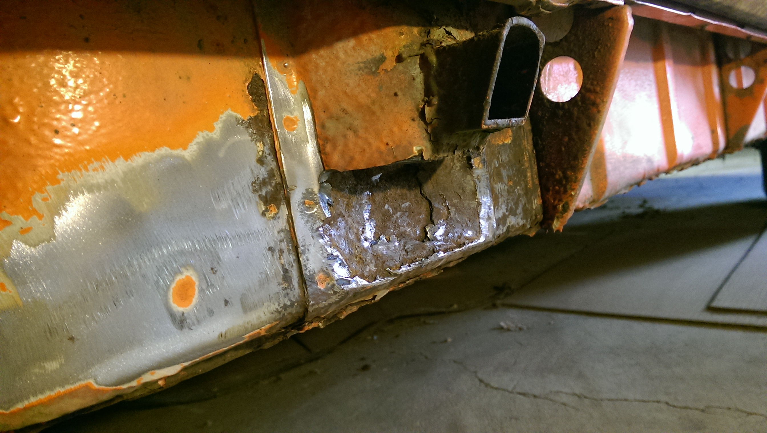

I decided to get into some scary bits today.
This is the passenger side jack post with the lower half of the pyramid cut away.
Can someone point me to a thread with ideas for next steps?

IronHillRestorations
That's not scary, that's not too bad. Scary is when you hit it with the sawzall and the whole thing rattles off
VaccaRabite
Yeah that looks really good actually.
Rot does not look to have gotten into the longitudinal. Wire wheel, seal and move on!
It will be easer for you in the long run to drill out the spot welds around the rest of the jack post support and just weld on a new one from Restoration Design. Just be careful not to drill all the way through into the long!
