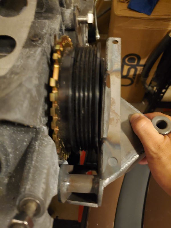

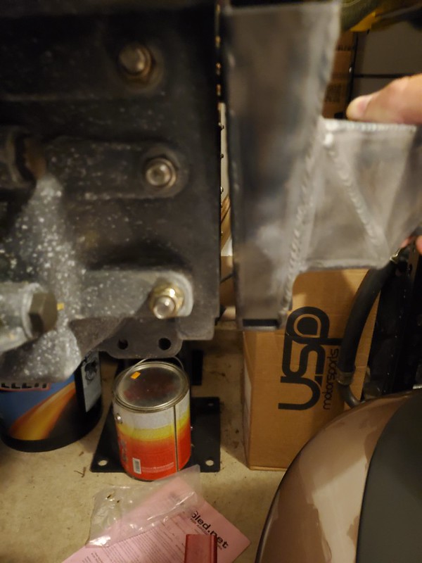

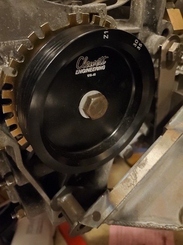

Has anyone used a clewitt crankfire trigger wheel and the oem style engine mount. I just put mine up to it and it will hit. If I put washer spacers behind it it should clear but this will push the engine back which will push the shift linkage back and will make the engine be further back in the bay which may mean not a good seal. Anyone dealt with this? confused24.gif

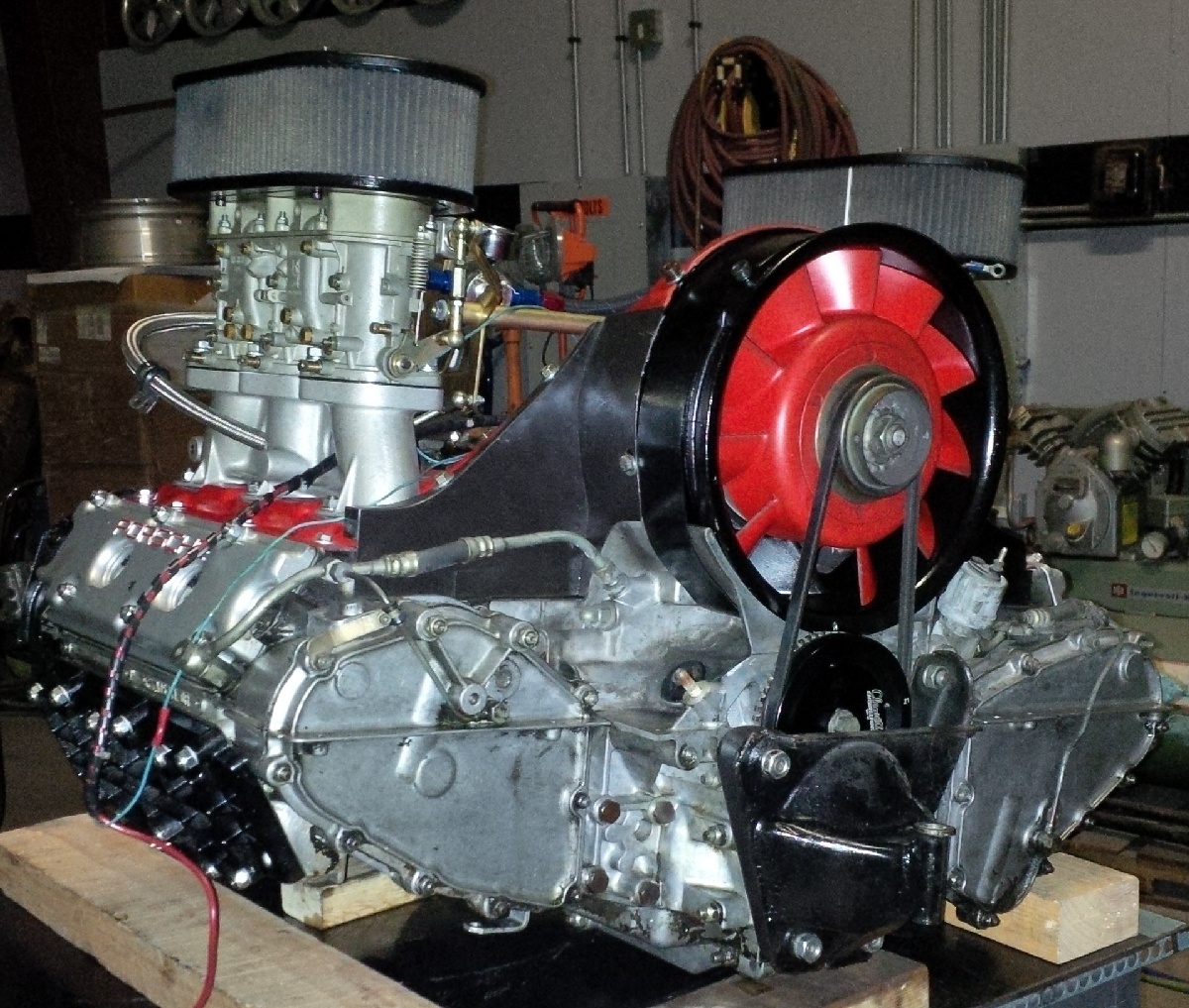

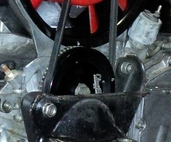

gms
yes it fits with 3L pulley
nditiz1
@gms What is that spacer piece behind the mount?

mb911
QUOTE(nditiz1 @ Aug 27 2020, 05:59 PM) *
This is what mine looks like
IPB Image
IPB Image
IPB Image
You have the serpentine pully thats the difference.
nditiz1
Crap!
Thanks Ben.
Ok time for a different pulley.
gms
QUOTE(mb911 @ Aug 27 2020, 09:01 PM) *
IPB Image
IPB Image
IPB Image
You have the serpentine pulley and I don't
